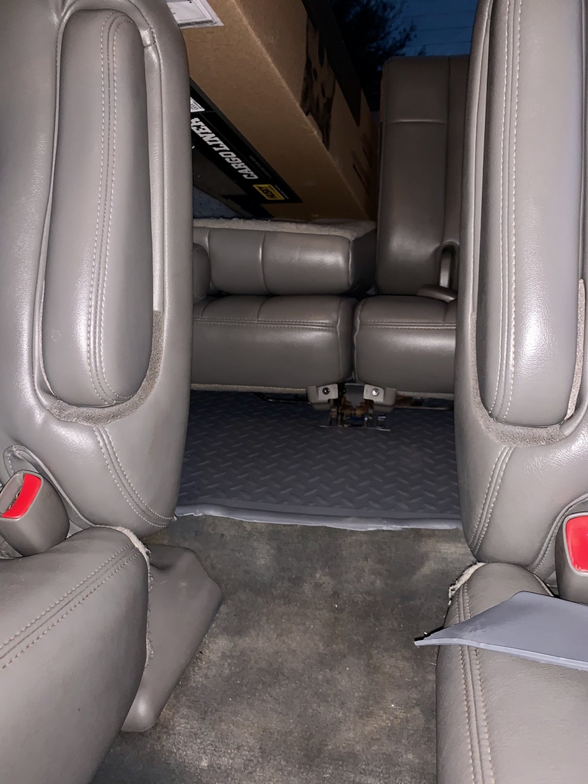

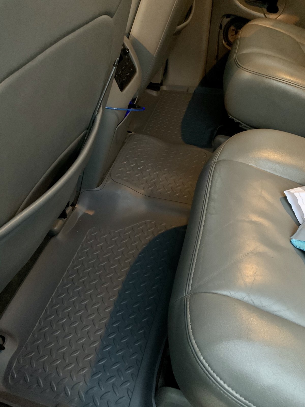

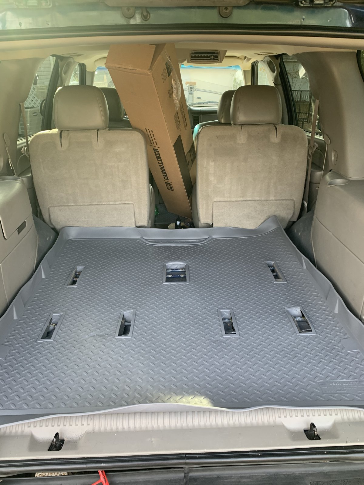

Pics of the cargo liner installed, please.
Just got done installing them today after work

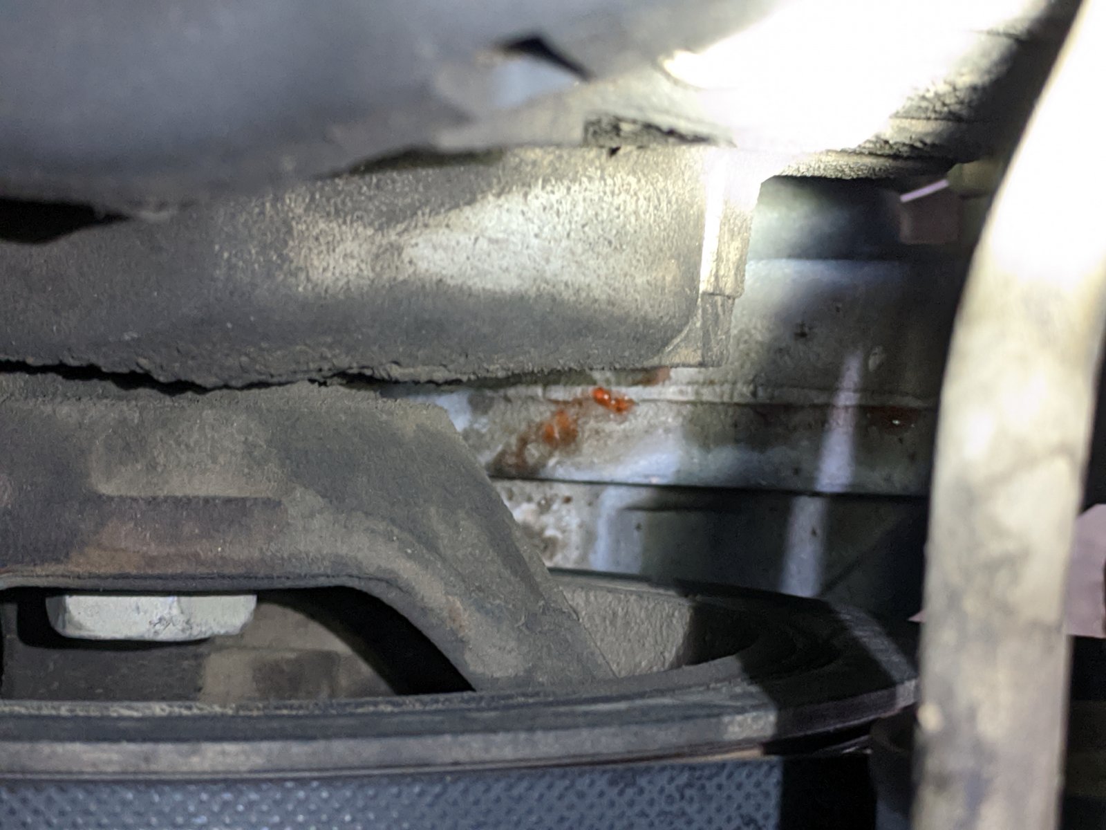

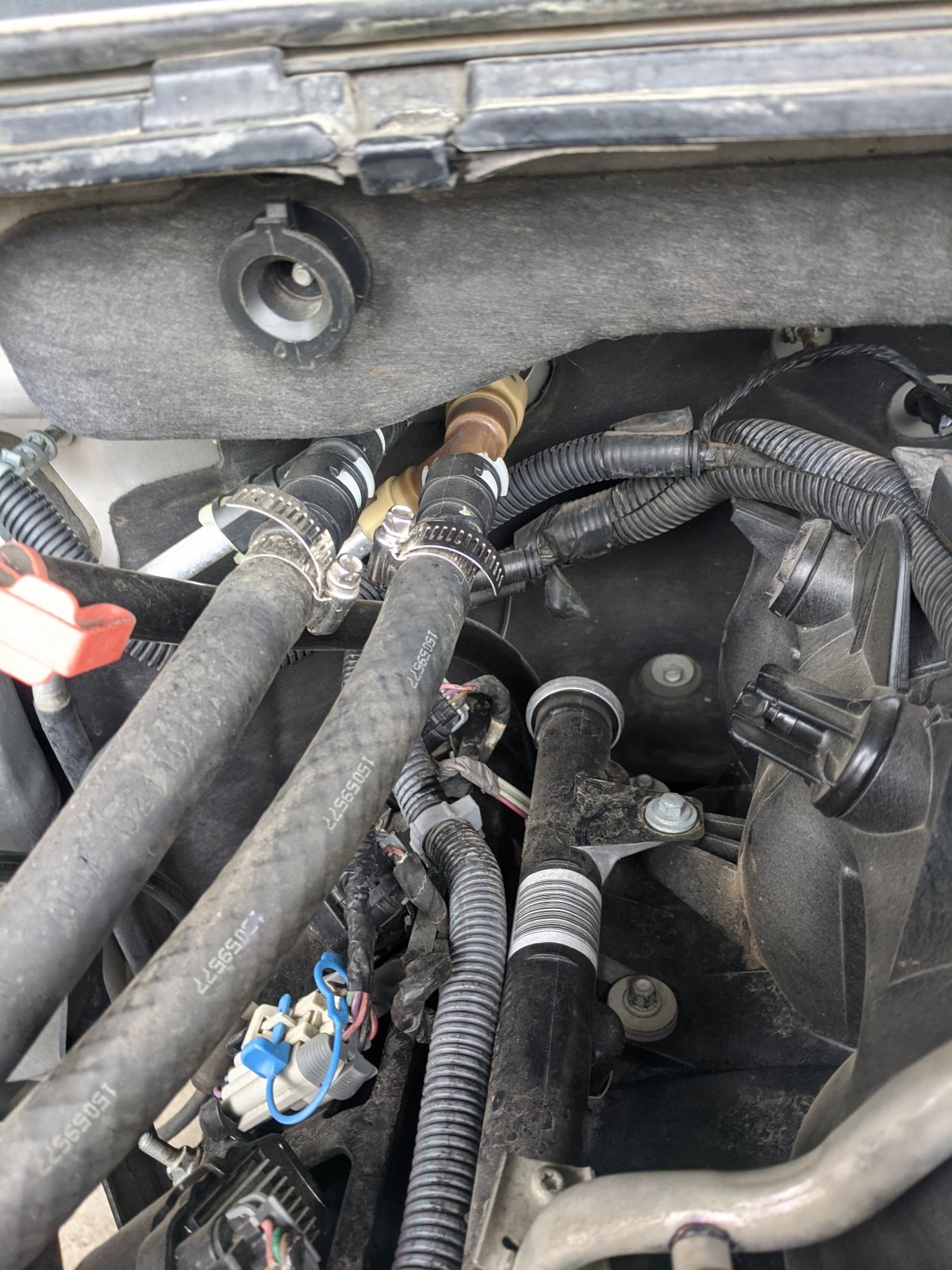

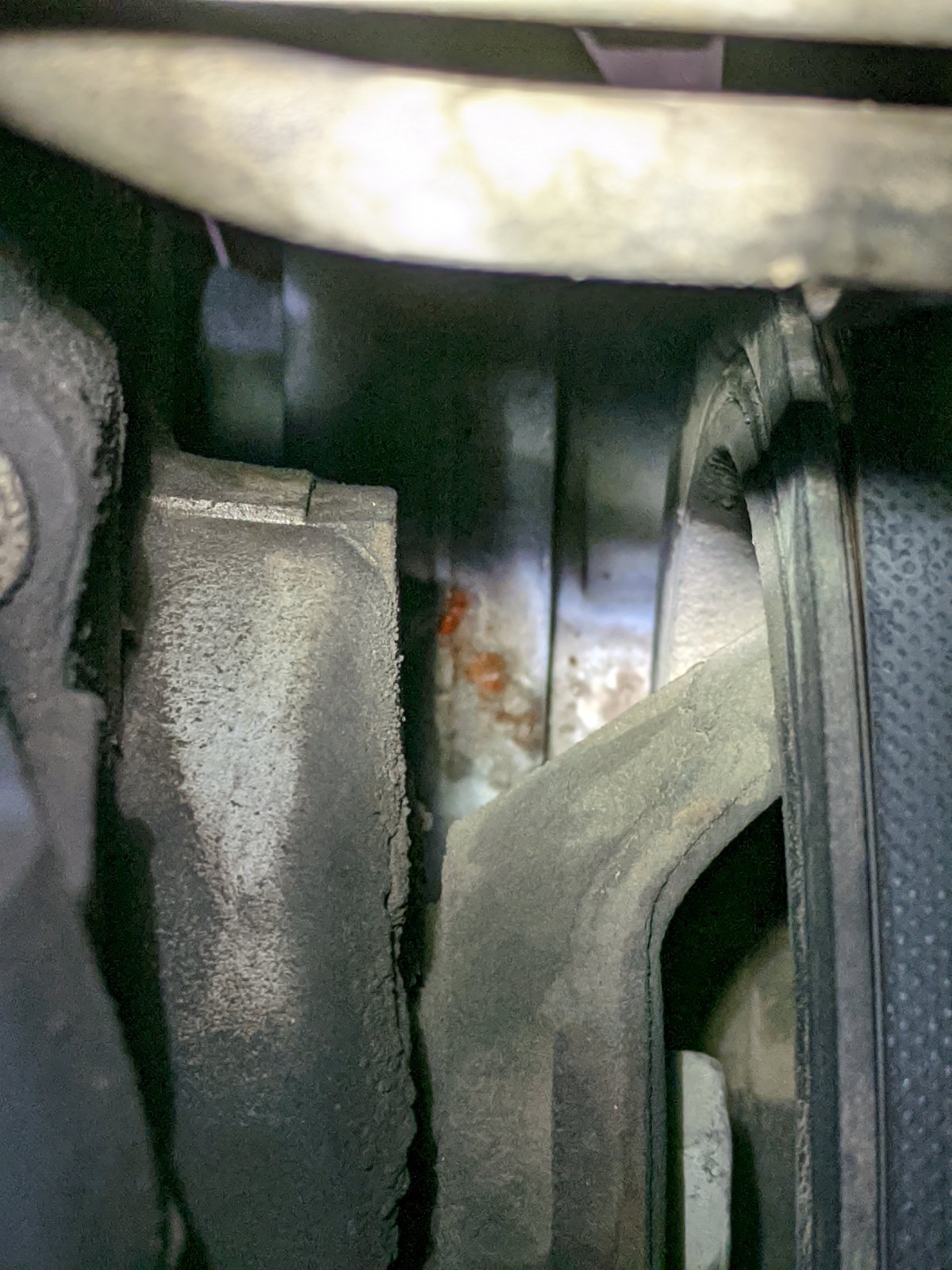

Trying to find a coolant leak on the ol lady's 04 suburban, I pumped it up to 15 twice already and it's loosing pressure over a few minutes but can't find the dam leak, checked every suspect place, no drips on the ground everything is dry, sprayed the reservoir with soap&water no bubbles wtf? Already did a block test it passed

Water pump I guess? Can't find anything anywhere else, it's loosing about 1/2 gallon a month slow leak the bottom of the pump has a couple drops dangling and discoloration, also found one of the heater hose lines that was previously fixed with a clamp was dripping, so tightened that up and see what it does, not sure if a couple drops under the water pump is normal or not
