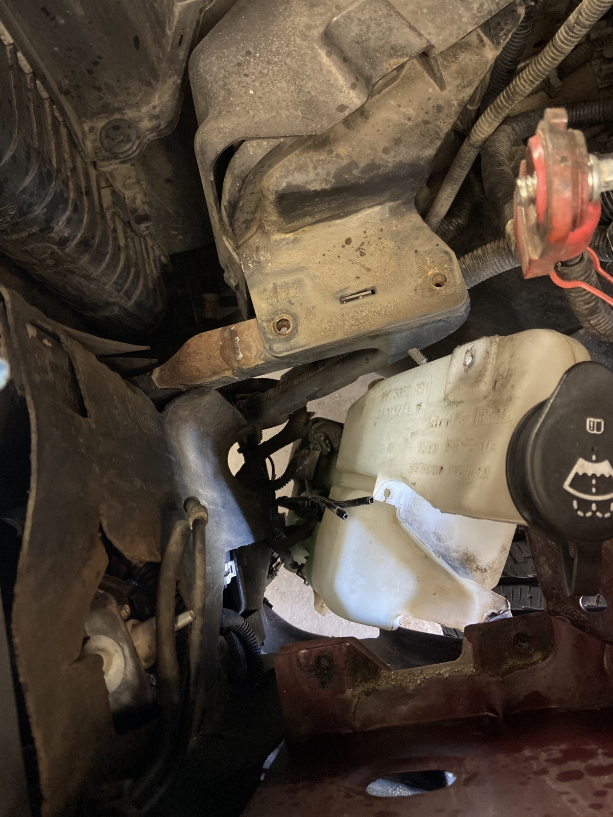

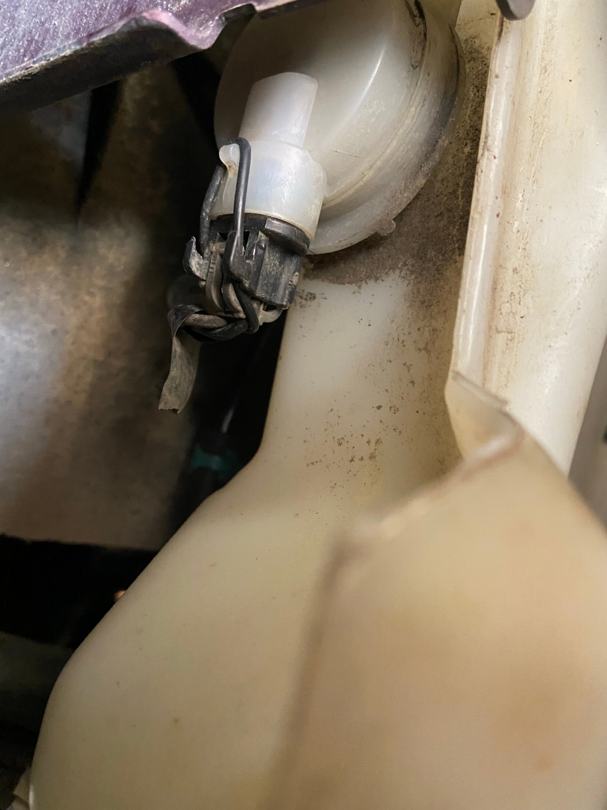

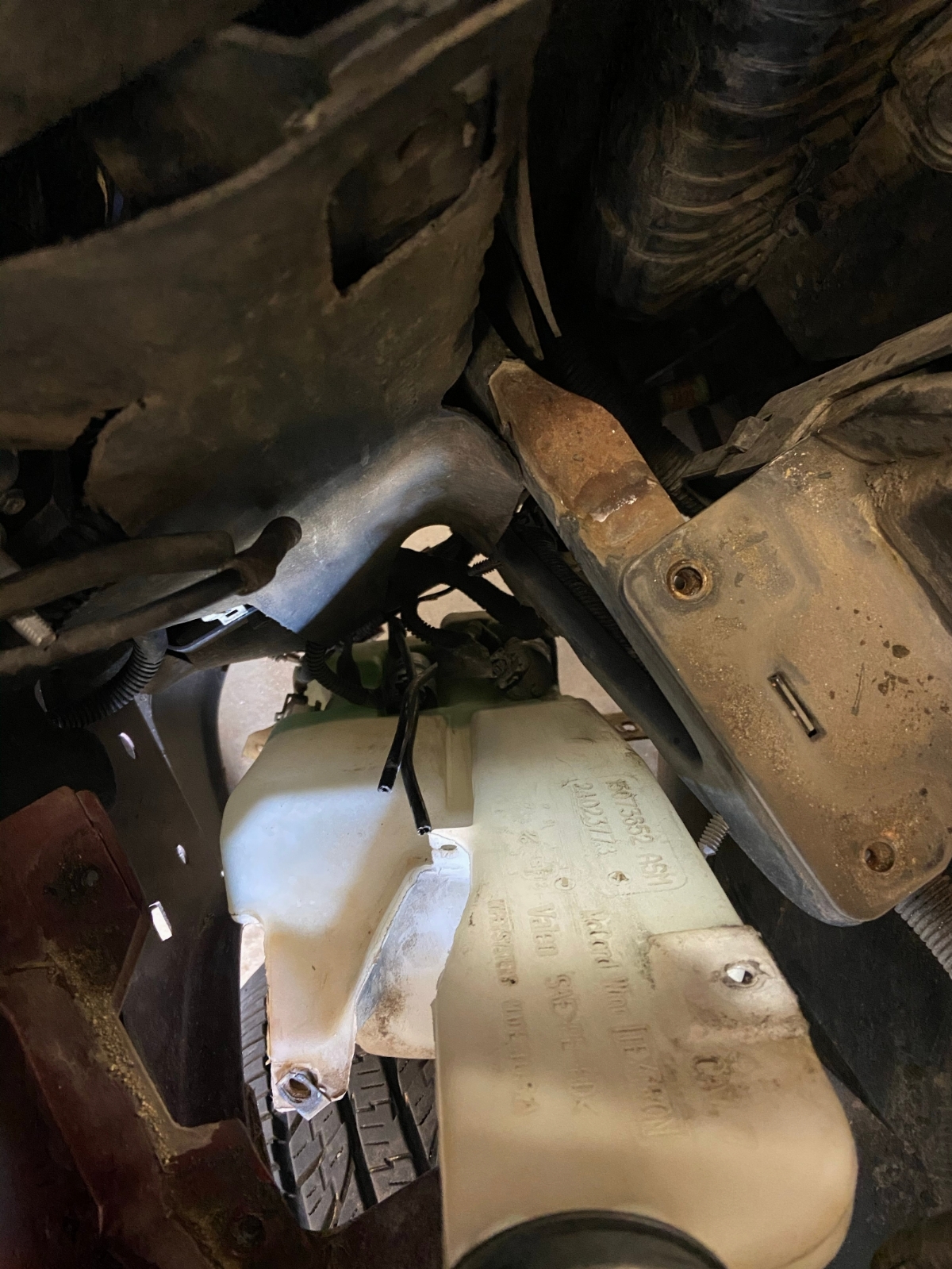

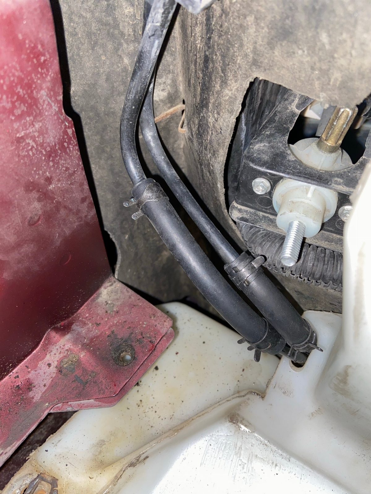

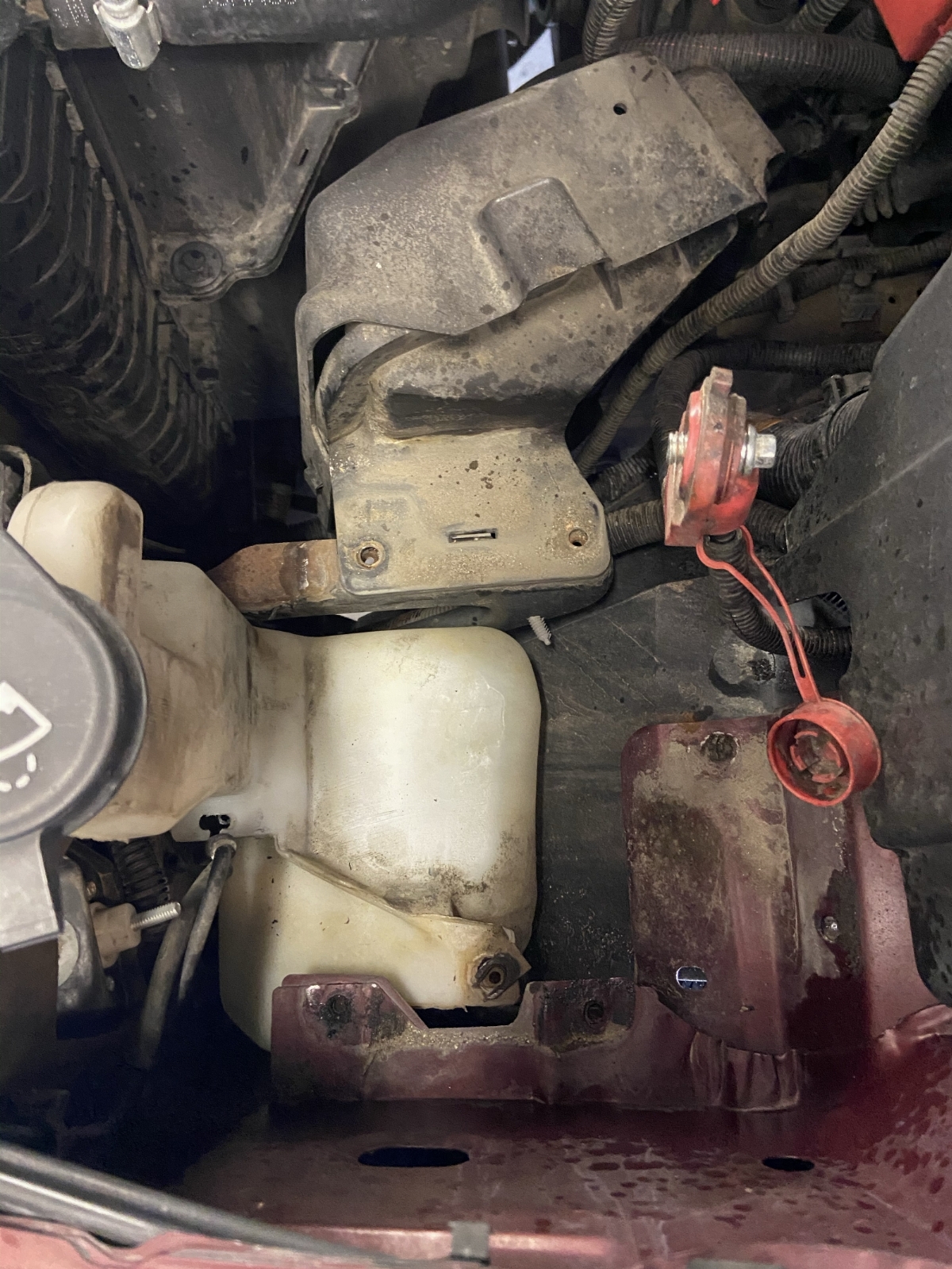

Current situation:
i bought the replacement pump, since that seems to be the weak link. But as soon as I opened it up, I see the lines are trash. Now I don’t know what goes where. Lol. Any tips appreciated. I guess I’ve got a 50/50 shot.

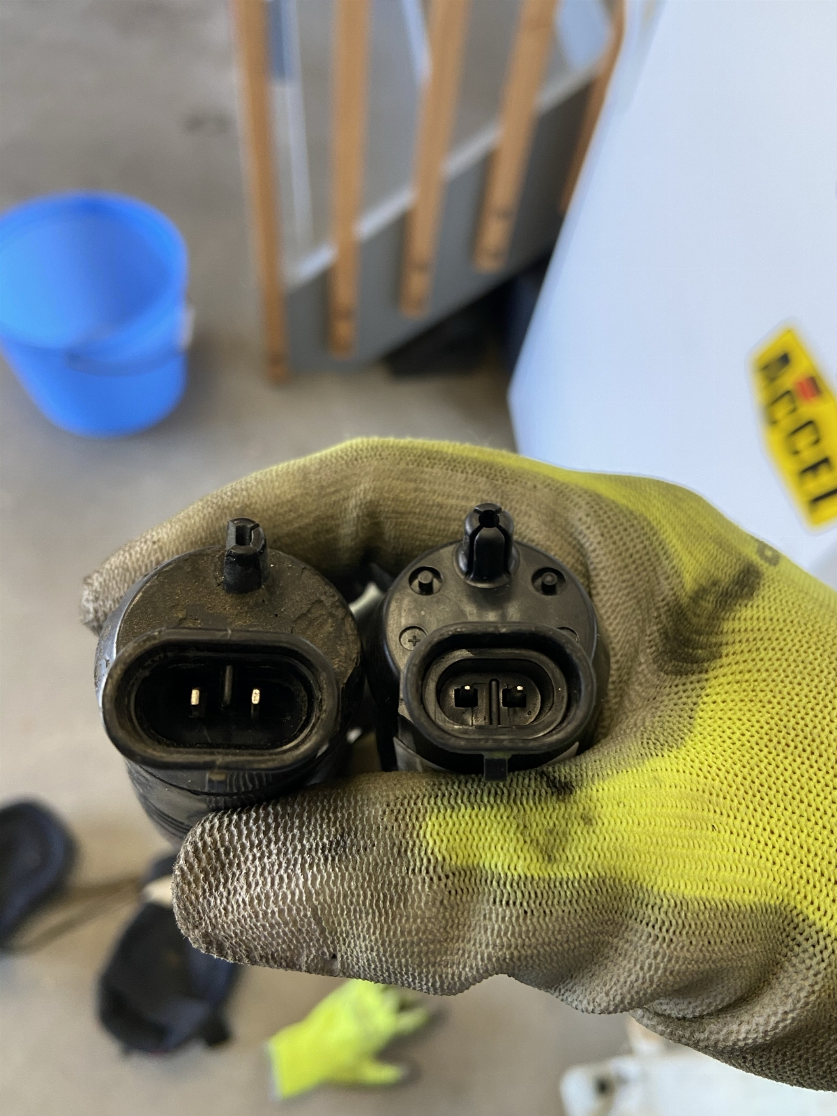

Ok. Got the right lines attached. Yay. On a pissed the **** off note, the pump I ordered from a GM dealer was the wrong damn one. So didn’t end up replacing it after all. Sonsofbitches!
i also managed to break the plastic clip that holds the washer fluid level sensor on, so for now a hack job o-ring was the best I could do. It’s pretty tight in there anyway, but don’t feel like going to get a replacement, and wiring in a new one today. It should hold for a while at least.
replaced the rubber connecting tubes as well and clamped them just because.

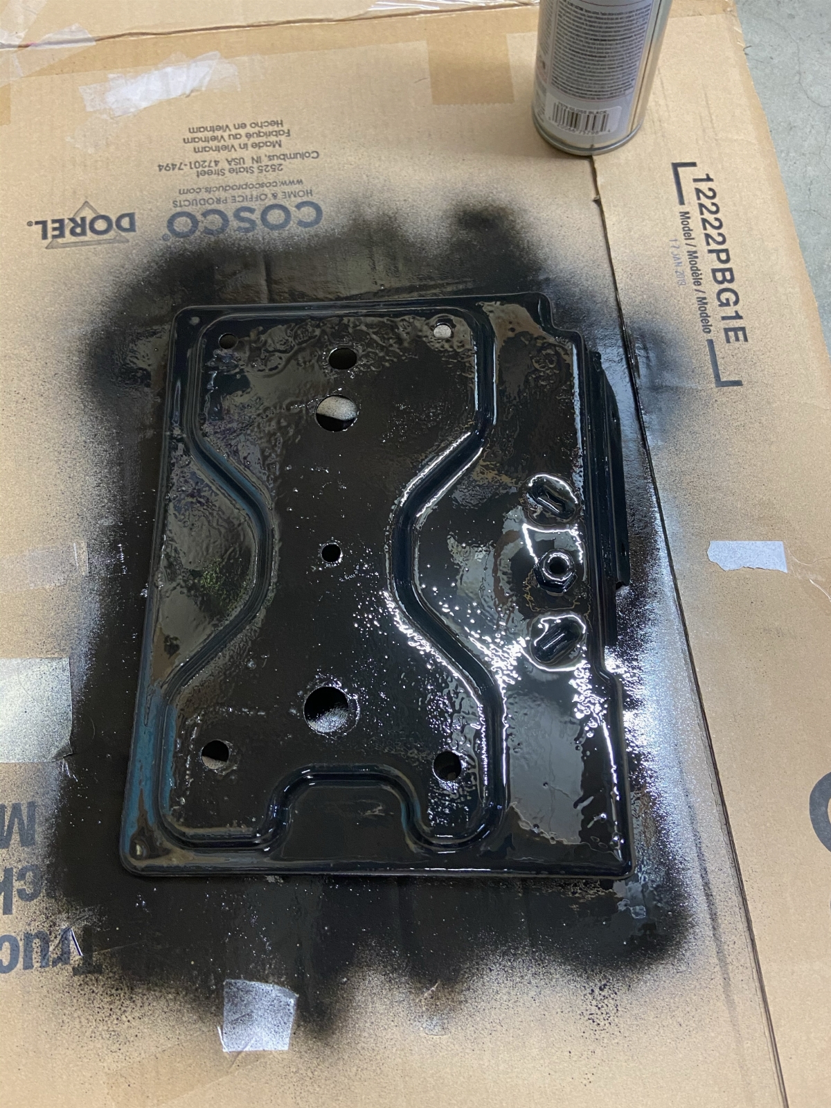

annd.. since watching @Fosscore, I had to touch up the terrible looking battery tray with some fresh black gloss. Lol. It still looks like crap, but significantly better than it was. [emoji23]
Thatta boy...the little details....

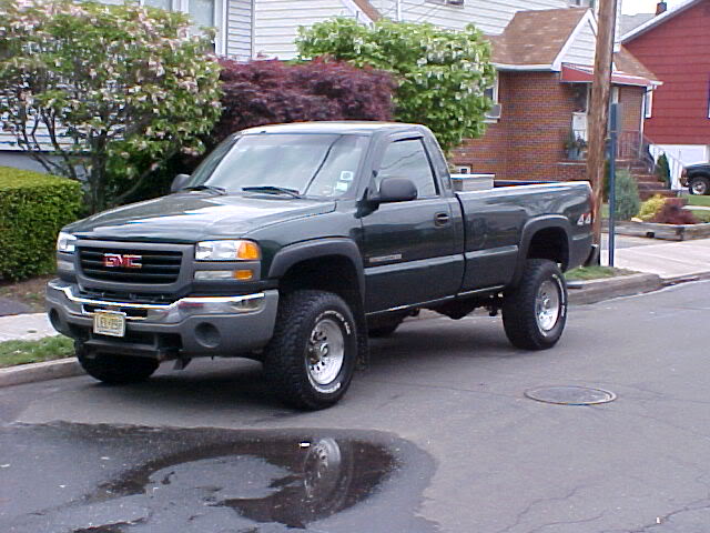

i did keys on my 03 2500 hd pick up. wish i never did. made the ride stiffer then a old ford 350 with a solid axle.
the lower arms were pushed all the way down and had no real movement/travel to them at all. only time it rode nice was when i had the plow on the front, with the extra weight the front end would actually move and feel like normal.
if you hit a large pot hole the truck would just fall in the hole. oh, and it broke front shocks like crazy.
This is not what happens with an inch or two to level the truck for 33s. Like I said, it's free to try it. I'm not a fan of lowered 4x4 trucks. Just my preference...

i had my keys cranked up already. and my 03 gmc hd pick up was already higher then most stock trucks when i got it new. 33's would not clear. had to do a small lift. them keys sucked.
keys up front, 2 inch blocks out back. looked fantastic, rode like a brick.

Yeah that is exactly what I was talking about in one of my posts about leveling it to match the rear with blocks. That's too much for keys. Maybe it was the offset of your wheels or the width of your tires, but both @HiHoeSilver and I cleared 275/70r18s (33.2") before any cranking (granted it was close) and just used keys to level after that. The wheels that both of us used are newer factory take offs with positive (+34 I think) offset. This makes it easier to clear larger tires. My UCAs are not on the stops, so my Tahoe does not ride like a brick and fall into holes like you're describing. I still have down travel. Breaking front shocks regularly is not a good sign and I certainly don't expect to see that with mine.

driver side front tire rubbed inside the back side of the wheel well liner and hit the plastic under the bumper. both sides needed to be trimmed under the bumper.
my lack of ride quality could be due to the truck was a 2500 hd. its t bars are easily twice as thick as the tahoes. its just a 1500 set up. much softer ride.
the adjuster bolts to the keys were like just threaded in and pushing on them lightly. hardly cranked on. even after the keys i had to trim the plastic on the driver side where the ebrake cable runs out the cab, only rubbed when turned all the way and backing up. and those are 33x12.5 wide on a 16.5 wheel. they stuck out past the fender flare by a inch or so. still dont change the fact it rode like crap.
i used to get 50k out of a set of BFG's. rotated every 6k and ran em at 50 psi. only way they last past 30k. i also had many alignments and new parts installed over the years. and never spin and smoke this brand tire if stuck. they melt like butter. pretty soft tire compound.
i also put 3,000 miles a month on this truck, and the one before it. my poor 97 gmc 3500 had 175k on it in 5 years. oil change every month tires rotated every other oil change. lots of fun on a 8 lug set up with just a cross bar lug wrench....at least i could just slide under it to do oil changes lol ill also note, these tires and wheels were on the 97 first, sold that truck and kept the wheels and tires, they didnt rub on shit on the 97 bone stock. go figure right?
