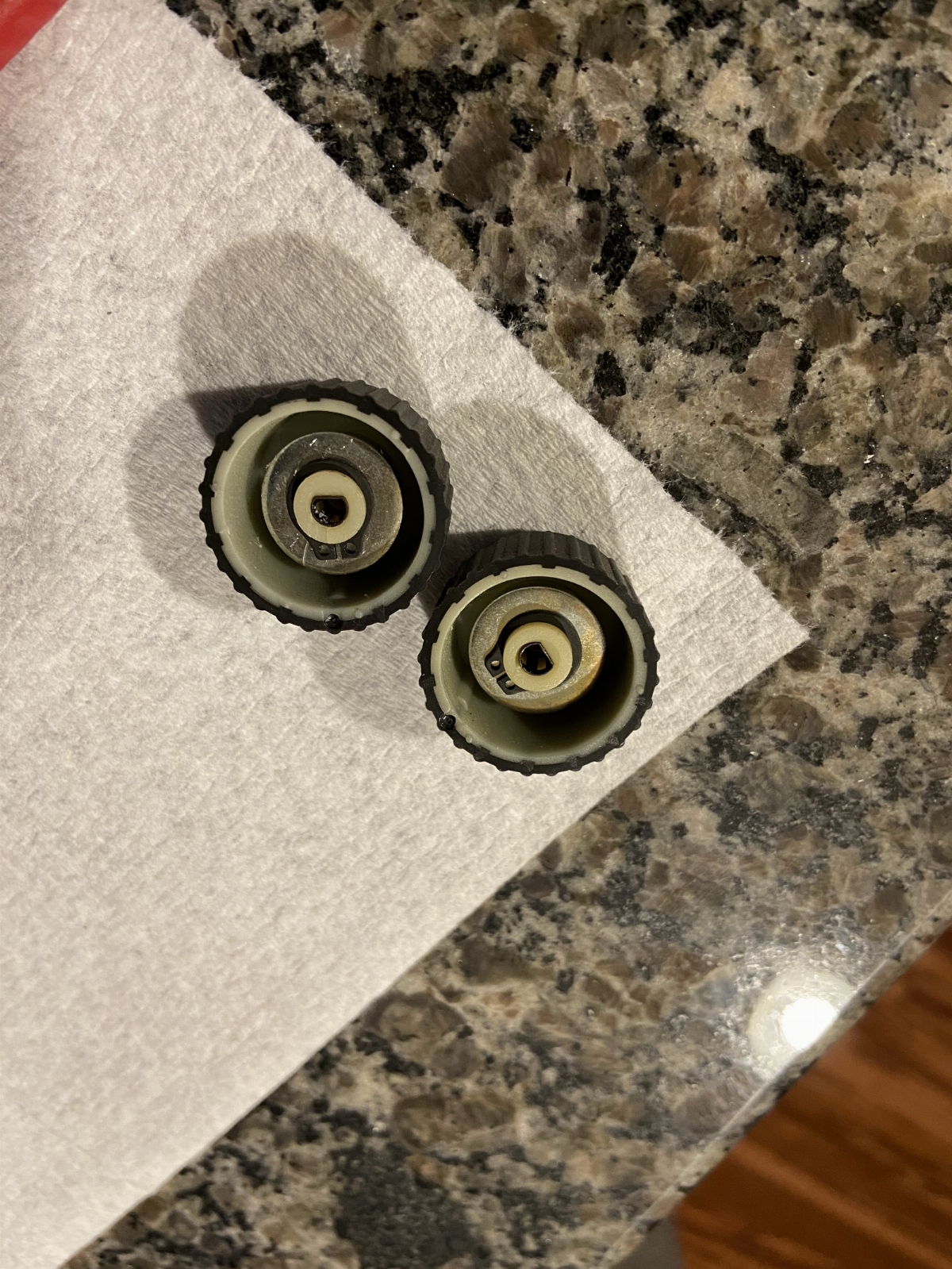

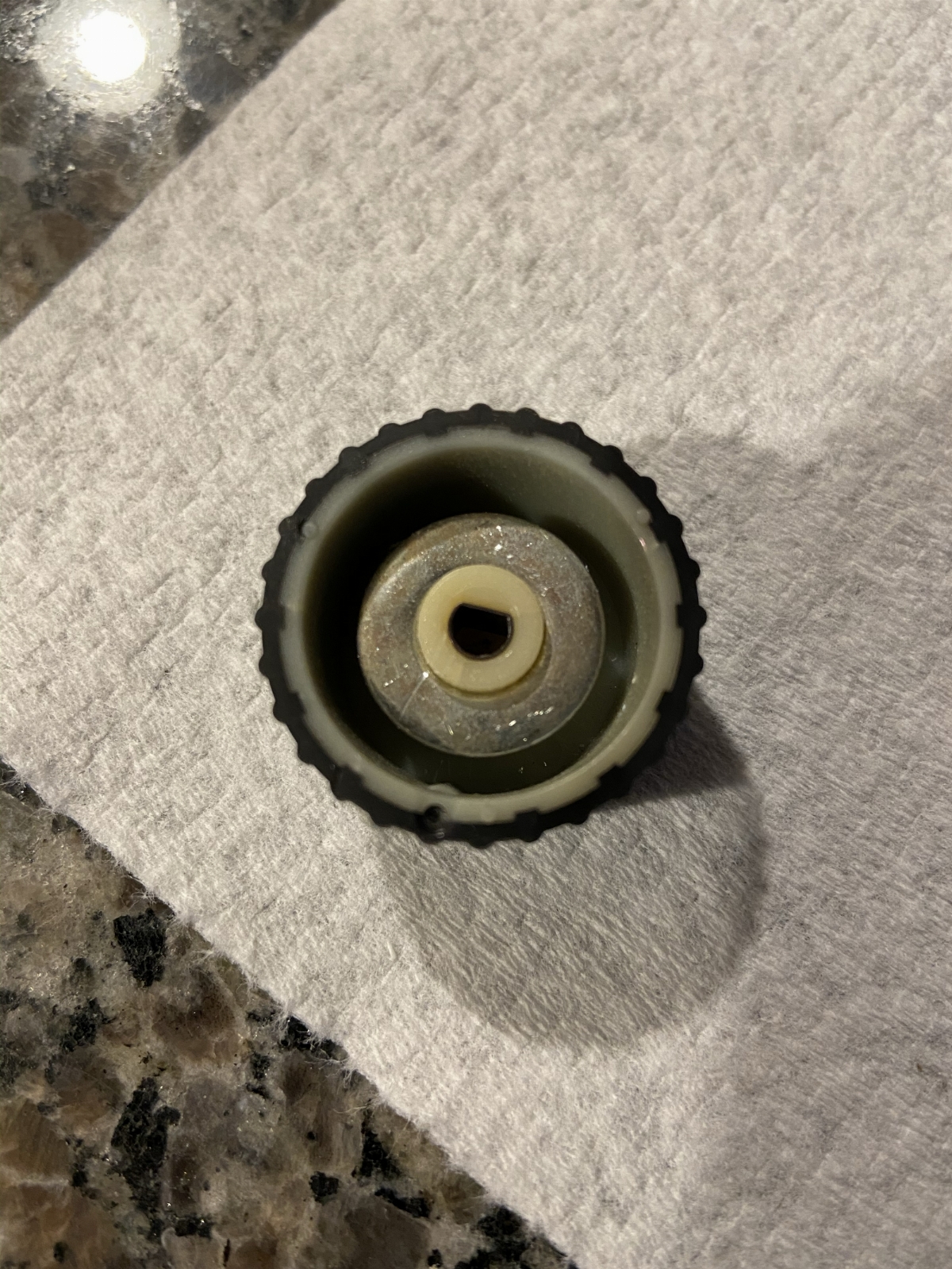

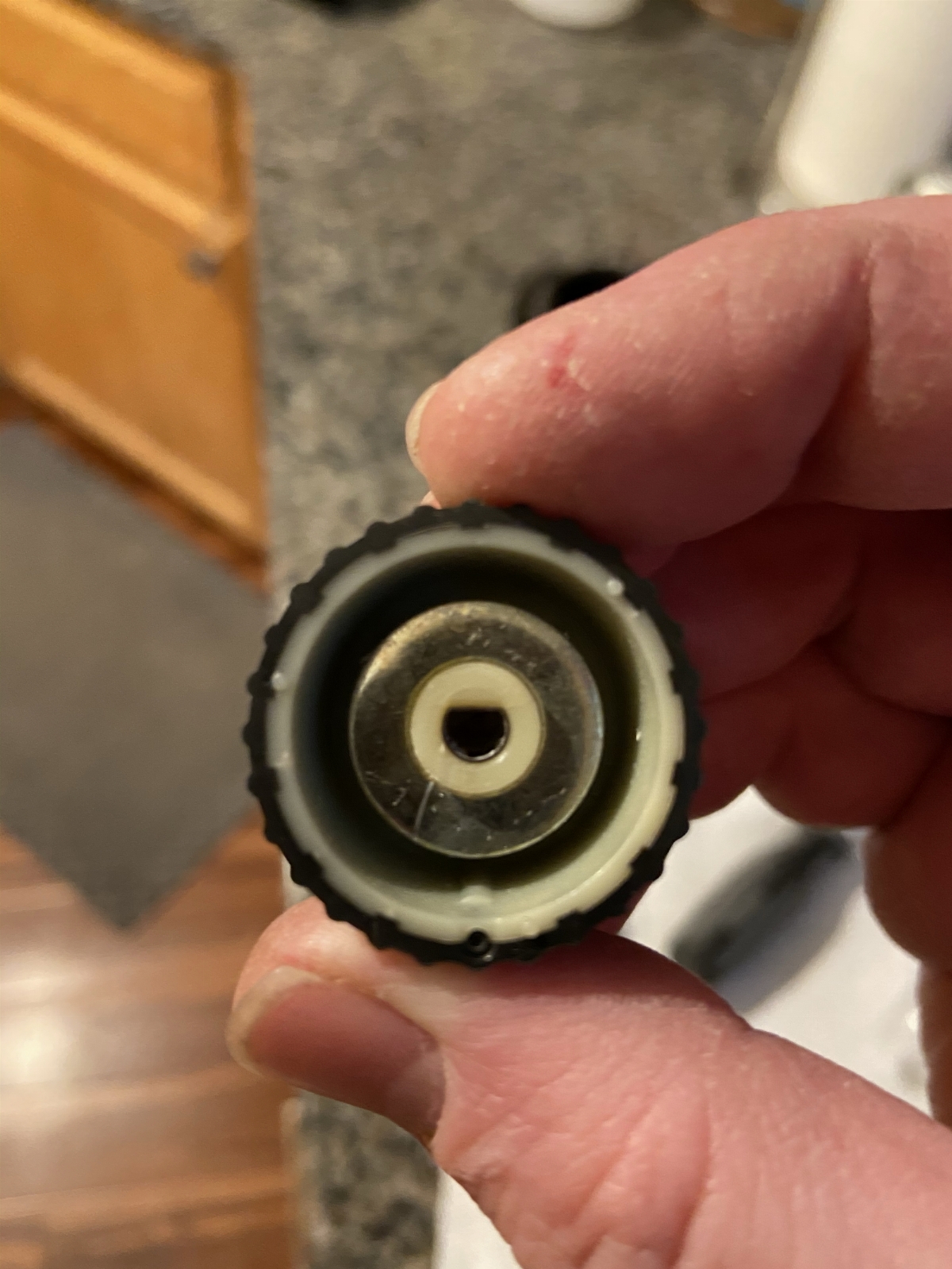

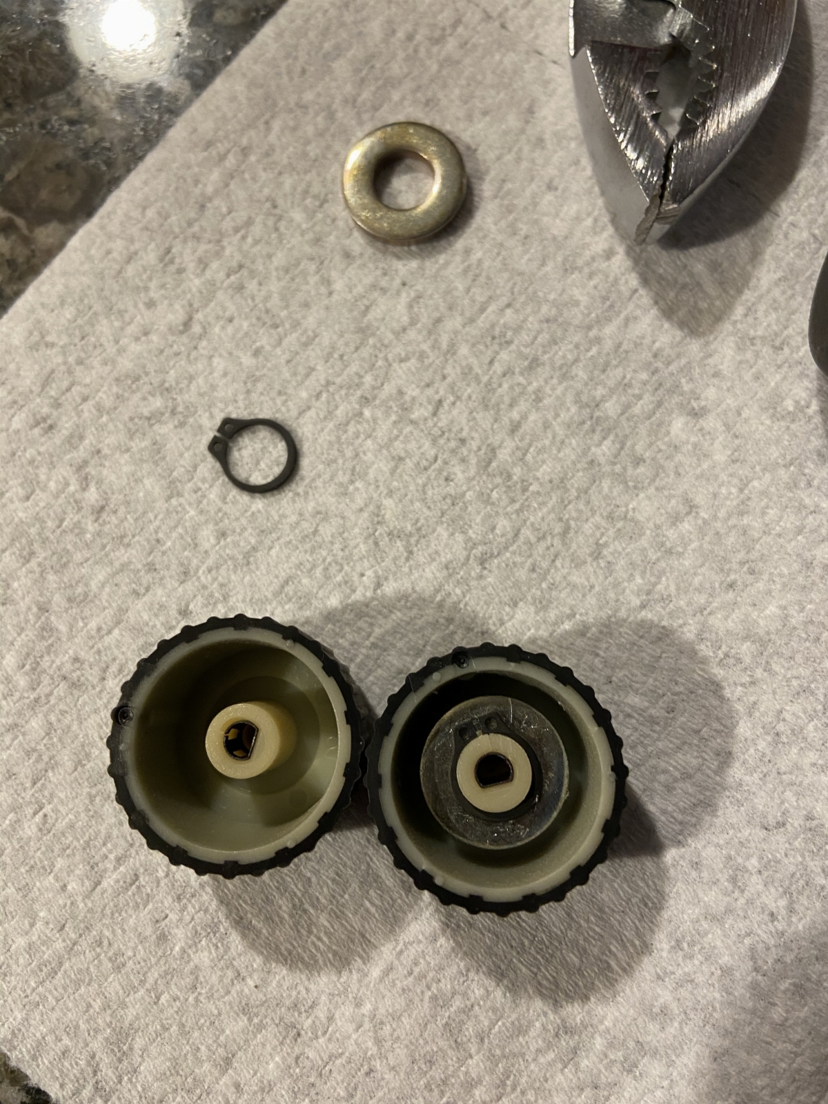

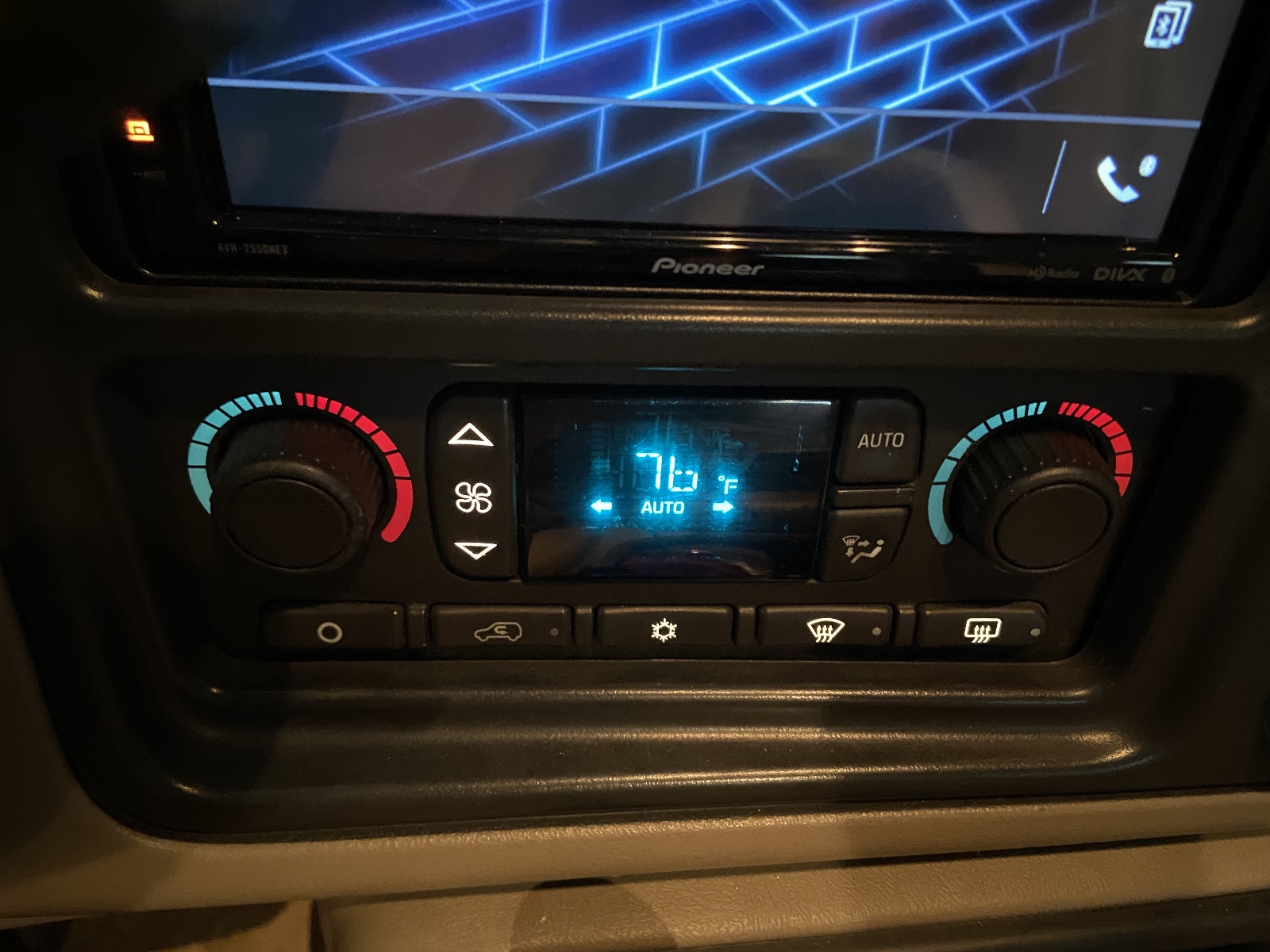

So after my HU install, I started to notice my HVAC driver side knob was getting hard to turn. I figured somehow there was additional pressure on the housing from the HU, and I would get to it when I plugged in the rca’s for the sub amp. Well, then it got harder to turn, and quit working entirely. Of course, pulling the knob off revealed 3 nice cracks in the middle, from cranking on it. Argh.! So off to Ace Hardware, to find a sleeve of some kind to fix it up.. I ended up with a perfectly sized (grade 8 lol) washer, and a snap ring for good measure. Went ahead and did the passenger side as well. Should hold well for a long time!
I’m not sure why the knob was so hard to turn in the first place. It was absolutely frozen. So a few sprays, and working in some electrical contact cleaner did the trick.
Also, notice I have 2 lights to replace in that HVAC control board.. LEDs May be coming.. not sure I wanna go down that road. It’s a PITA..

I love Ace. I have used them so many times in the last few years. Nice work Sam.

You didn't happen to do this repair in my driveway a few weeks ago and need to run back to the store for another snap ring at some point, did you?
