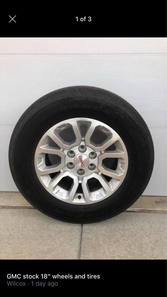

I can always change my mind.. lol. For now, I’ve already purchased the new keys to level it without cranking the torsion bars too much, Z71 Springs, and about to pull the trigger on the Bilstein 5100’s. Have these 2015 Yukon wheels I wanna put on, so I can do the NNBS brake upgrade, but still need to acquire the rotors, calipers, Goodrich 5-pc stainless lines kit, and pads.. do I need the hub-to-caliper brackets as well..?
If all goes well I plan to wrap the wheels with some decent 285/70 18’s (33”)
If you're not going up more than about 1.5", you don't need keys. Cranking the bolts will do the same exact thing. For the brakes, yes, you will need the abutment brackets.

Depends on if the calipers you bought came with brackets. Some do, some don’t. The old ones won’t work.

About the NNBS brake upgrade, there's a pretty good thread on the conversion somewhere here. Besides the caliper brackets, it looks like you'll need different caliper slide pins. I would like to do the upgrade on mine but haven't been serious about looking for parts at UPull. I'd probably look for the brackets, and maybe some calipers for cores, there.

Yes, I think I have the parts list down, now that I know i need those brackets as well. I figured the new / reman calipers will come with the correct slide pins..? Either way, I’m not jumping on that one just yet. Need to wear out the current tires anyway! [emoji106][emoji16]

There’s quite a few of us who sent their NBS cores back without a problem. I don’t think the people receiving them know the difference. I bought loaded ACDelco reman calipers on Amazon and they came with brackets, pads, pins etc.

Nice. I was looking at those. Good to know they come with the brackets! [emoji16][emoji106]

I got the brackets when I did mine .I think you will need them for rotors size difference or they mite rub
