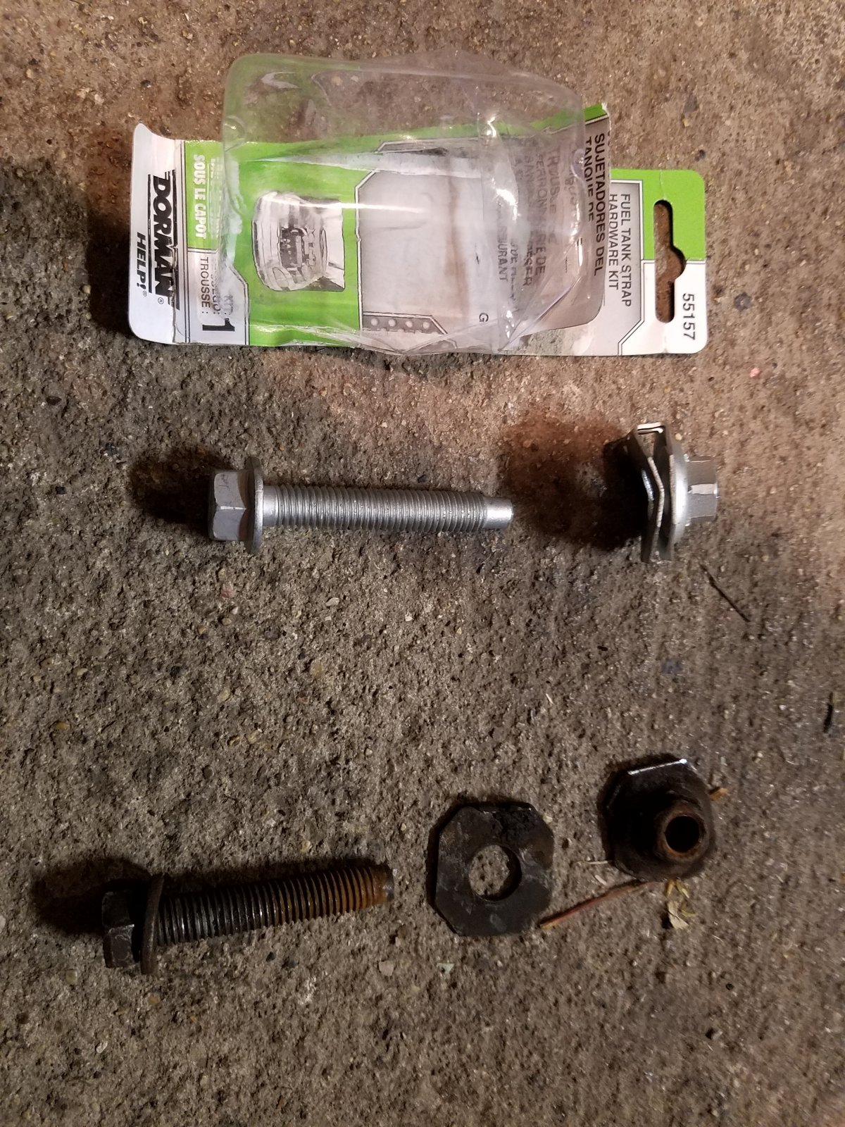

Great info, thanks. I hit one of the tank strap bolts with some PB Blaster today when I got home from work, couldn't reach the other one's threads, but the heads don't look too bad for rust. We'll see. One of the tank straps has what looks like a little duct tape between it and the tank, so I'm wondering if the strap or the tank has already been out. Only 105K on the clock, though, and thankfully not a lot of rust showing, at least not heavy stuff. Most of its life has been in Wyoming and Colorado.

Mine is an Oregon truck, no rust anywhere, no salt here and still one of those stripped. Better have replacements on hand in case.

Got the bolts and fuel clips but am waiting for it to warm up a bit. Besides that, my non-resident mechanic isn't here yet with the other jackstands.

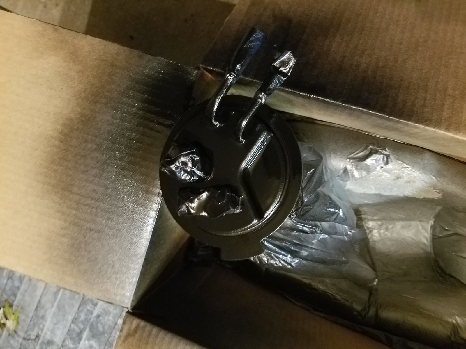

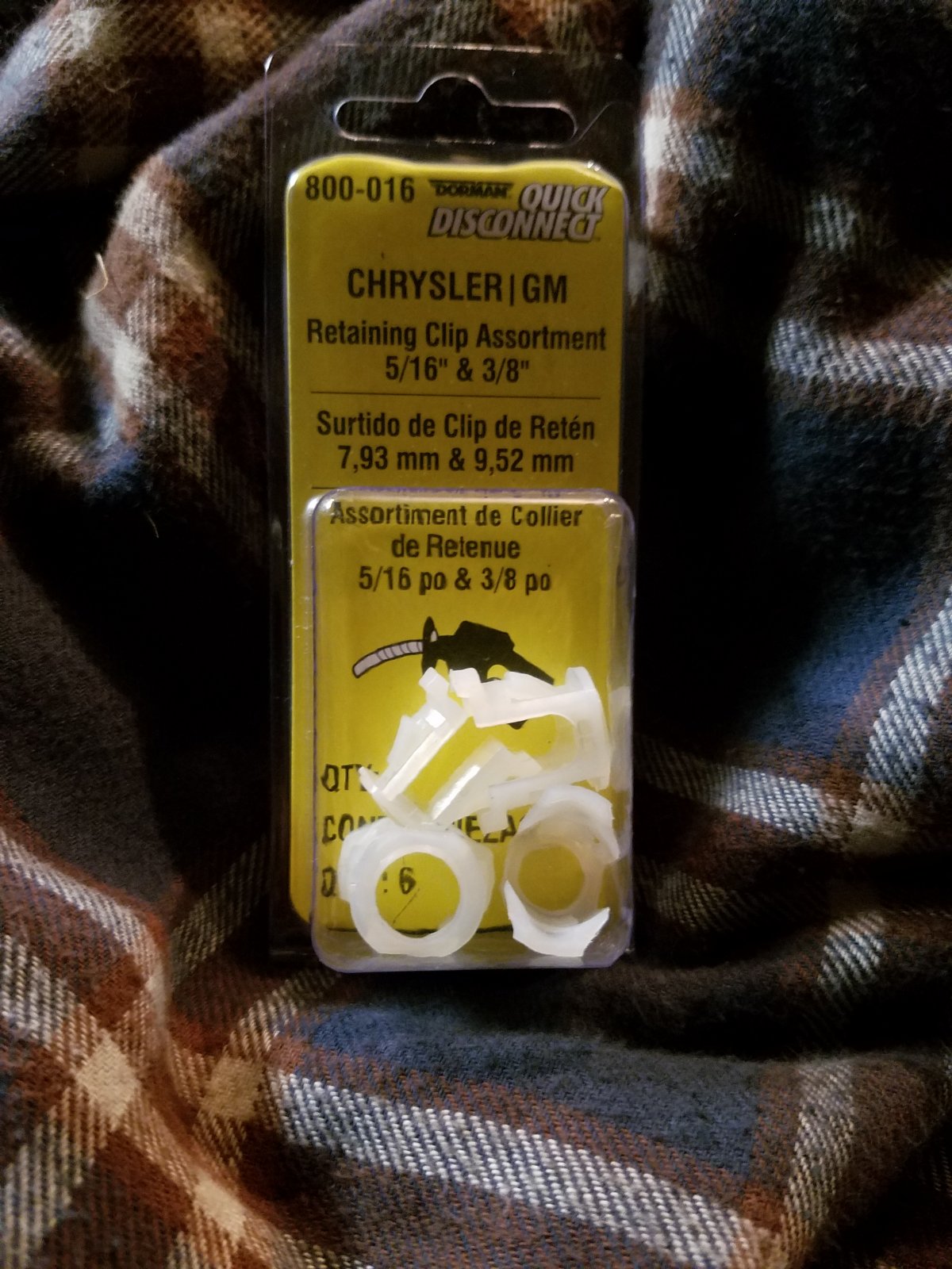

We got the fuel pump replacement done, disconnecting the fuel lines just from the pump and the clips along the tank, and the emissions lines from along the other side of the tank. It really wasn't too bad, nothing was really rusted up and we didn't break anything. I used channel lock pliers to remove the ring that holds the pump in; had to work my way around the ring to get it loose but didn't have to even wield a hammer. Used new clips on the fuel pump connections, the ones @HiHoeSilver posted up.

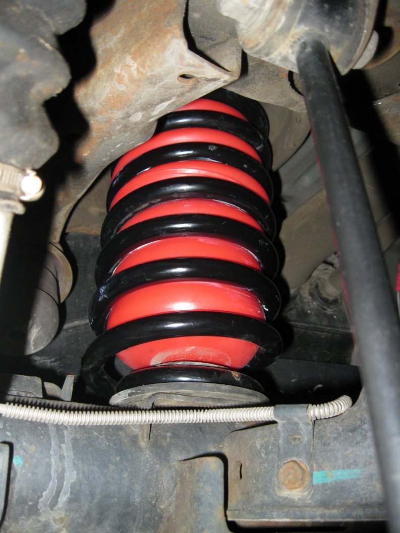

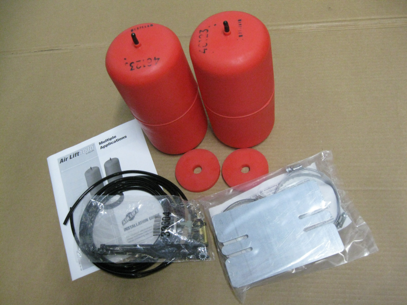

I installed Air Lift air springs on my Tahoe to help with towing. The install wasn’t too bad, although I think I de-laminated my thumbnail trying to force the bags inside the rear coil springs. It does a good job of keeping things level. Had a chance to test the new setup before the snow started today.
