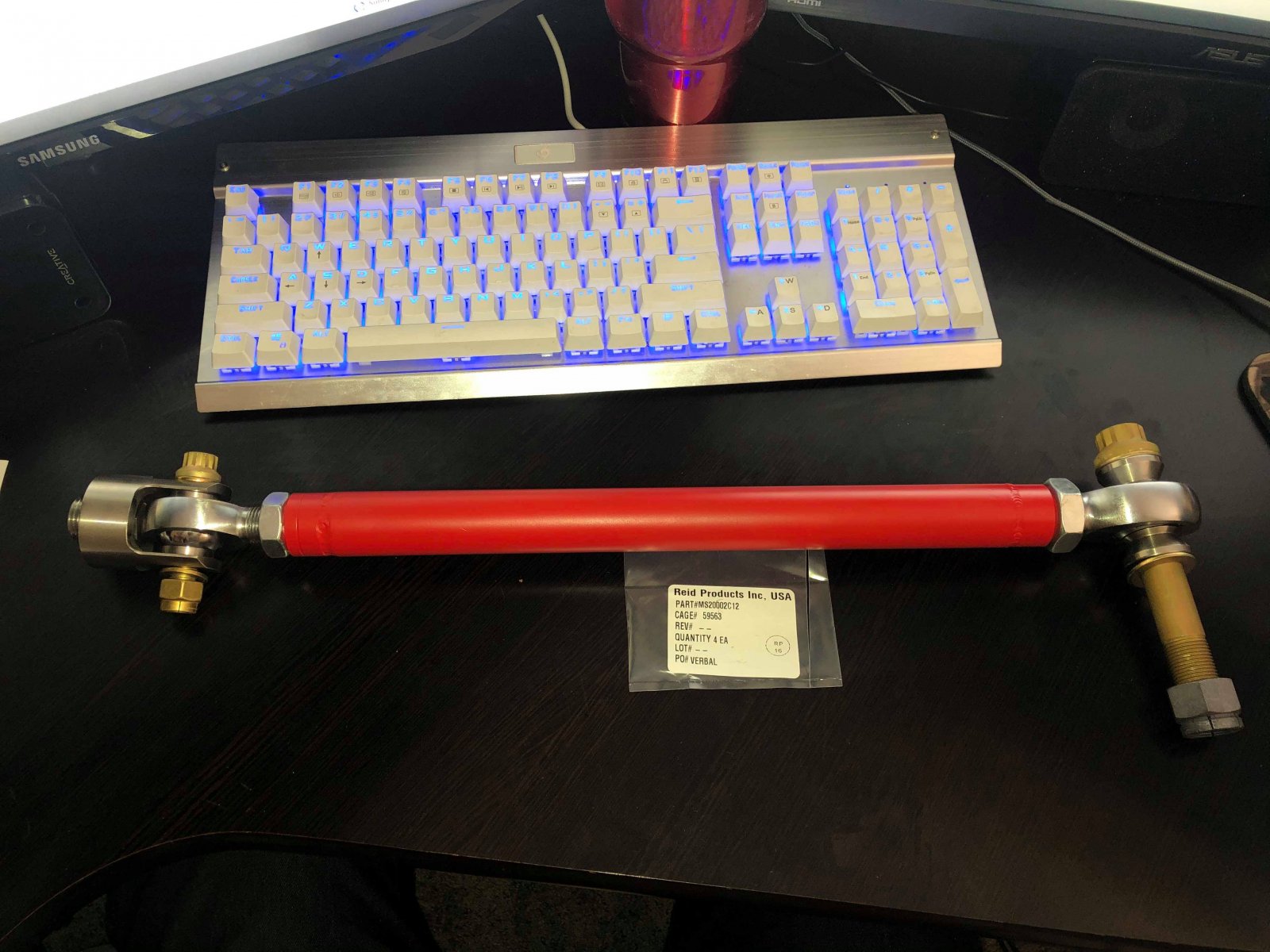

it started as a yukon denali on 24s that was an auction car. 2009 denali front clip was changed to 07-13 silverado front end with fiberglass 4" wider fenders and fiberglass bumper cap over the skid plate and bumper. power mods forged 6.2 with minor bolt ons and tune had a turbo but with the big tires and fulltime aws it kept bending and breaking tie rods. 325/60-20 falken at3 on 20x10 raceline clutch wheels brakes 8 piston R1 concepts with 17" rotors in the front and rear 15.5 with 6 piston. re geared to 488s. Suspension mazzulla 4x4 mid travel kit with 2.5 Kings with adjusters front and rear and rear is the longer precision coil. theres a bunch of other stuff but thats the just of it. this week it will get new tie rods that can handle the power and new link arms and pan hard in the rear. it was purchased because they incorrectly totalled it no frame damage and it was dirt shit cheap so now i have a clean daily and weekend offroader. attached is the heim steering kit 1.25" .120 wall 3/4 heim inner with billet clevis and rack adapter 7/8 heim outer with 3/4 bolt and spindle getting drilled to accept that. all bolts 12 point NAS bolts with proper shanks and hardware

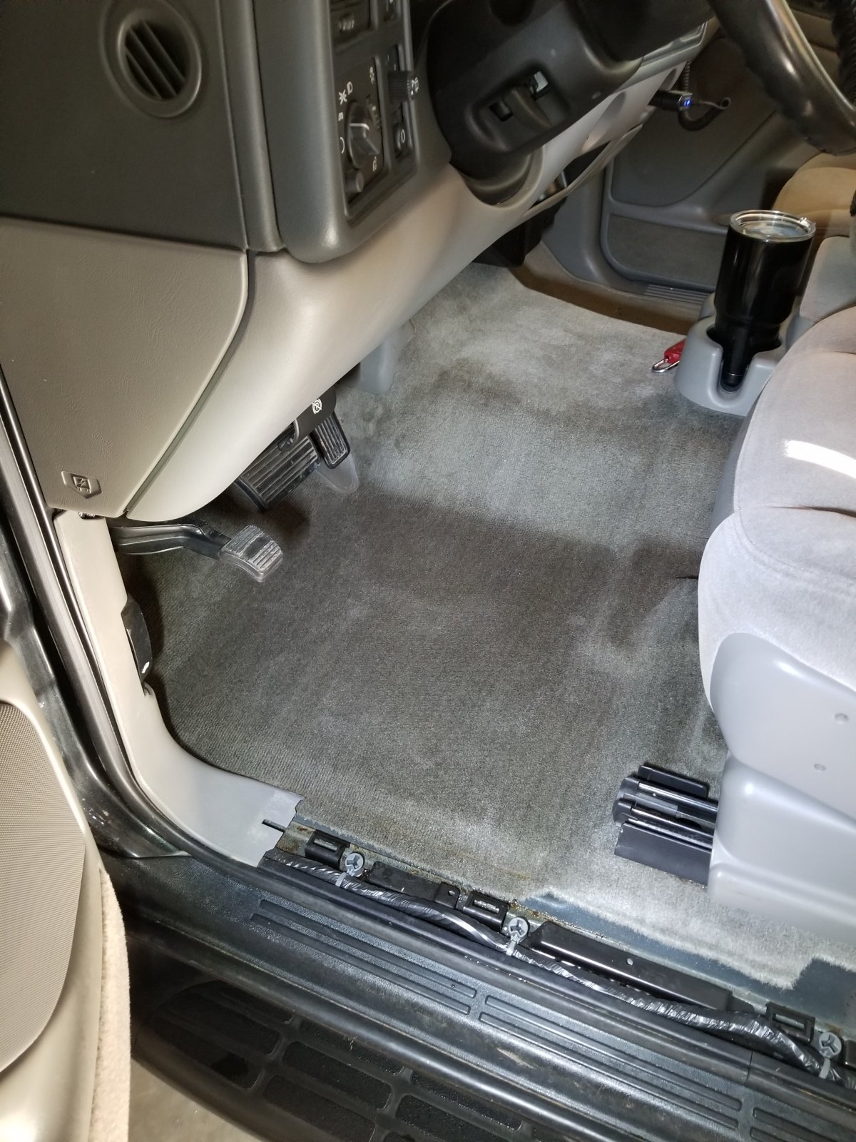

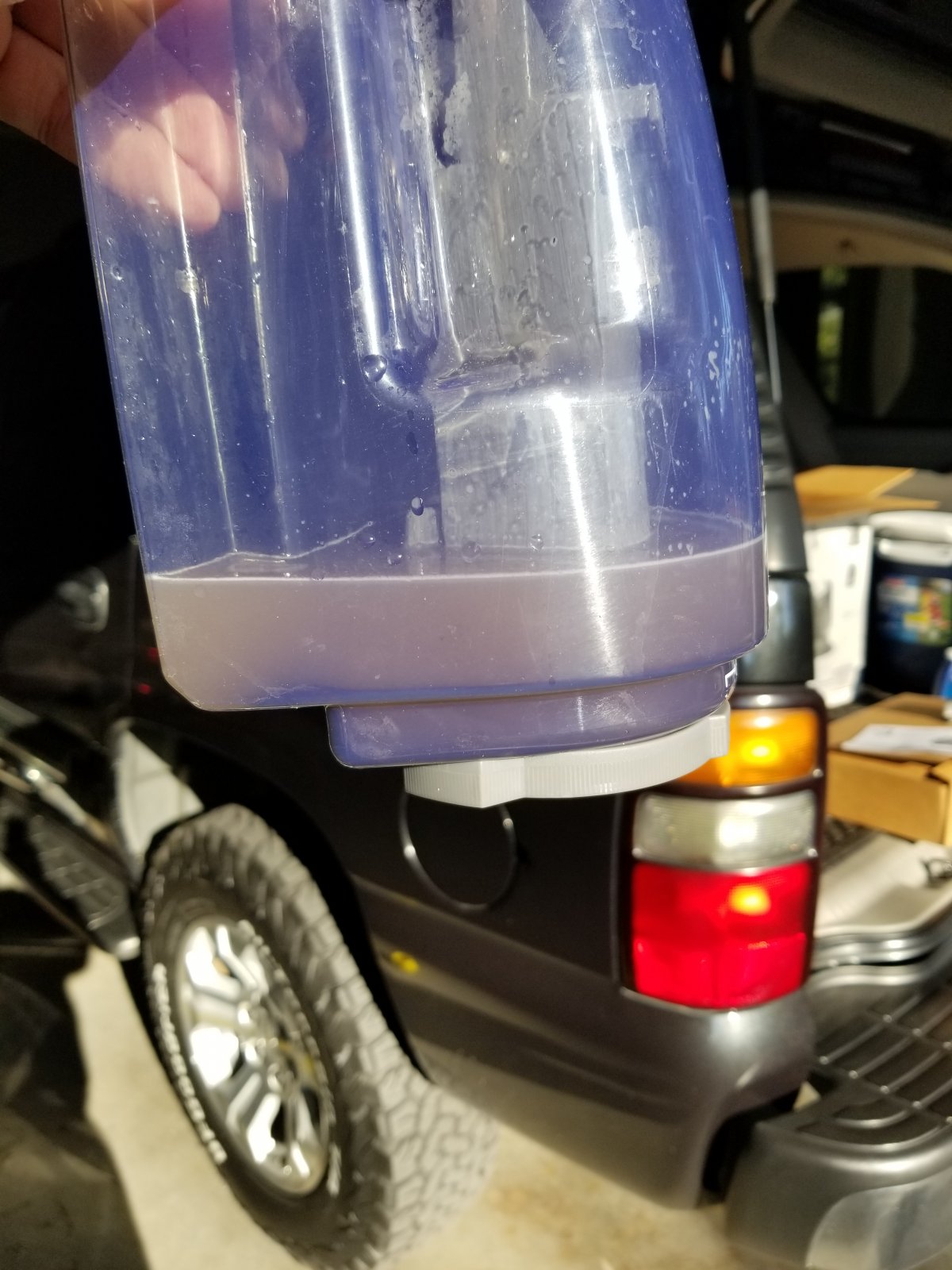

Picked up a cheap Bissell spot clean carpet extractor off Craigslist for $20 and cleaned my carpets.

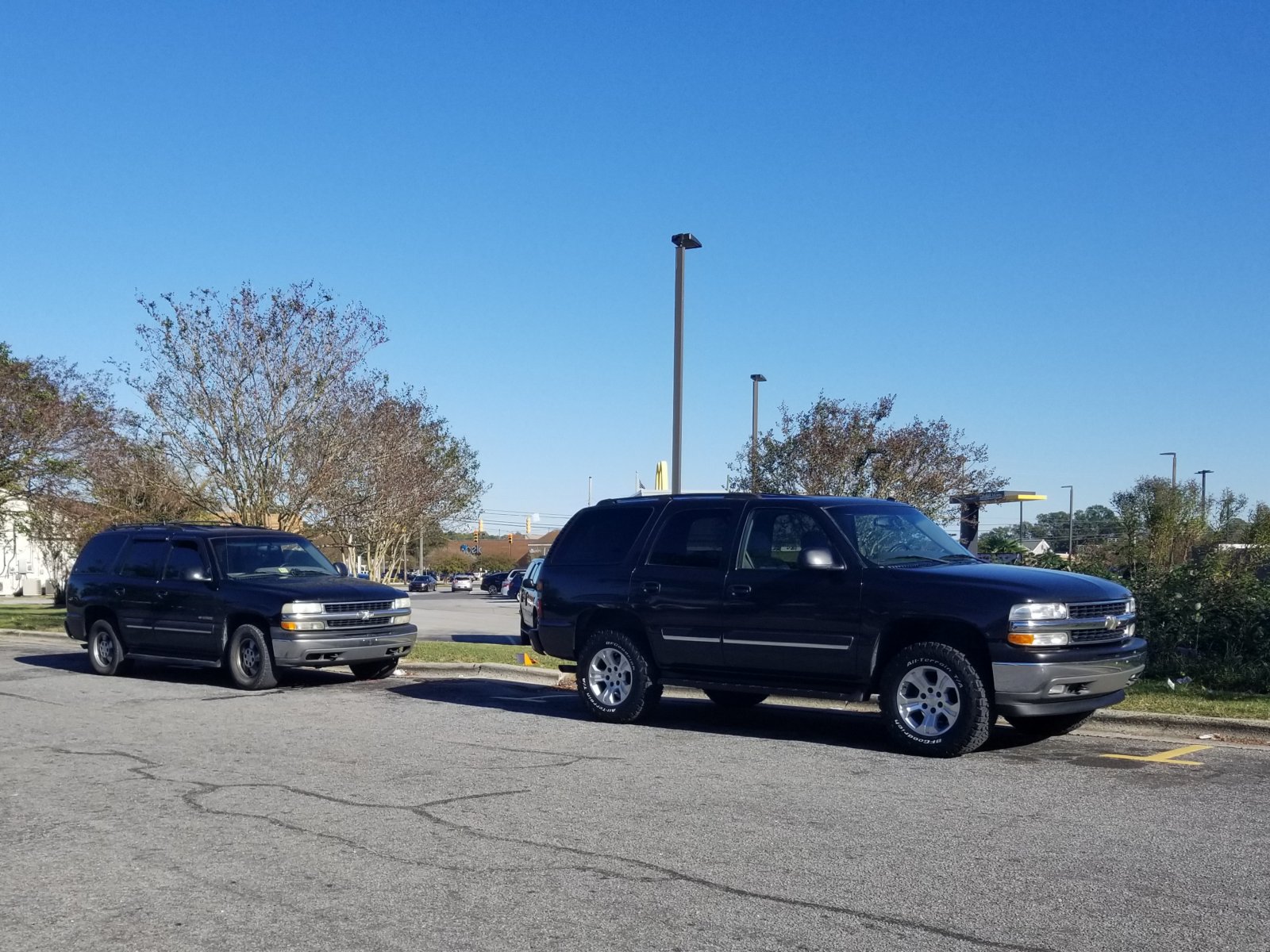

Also parked next to a stock (and fairly tired looking) Tahoe. Wheels, tires, and a level really make a big difference!
