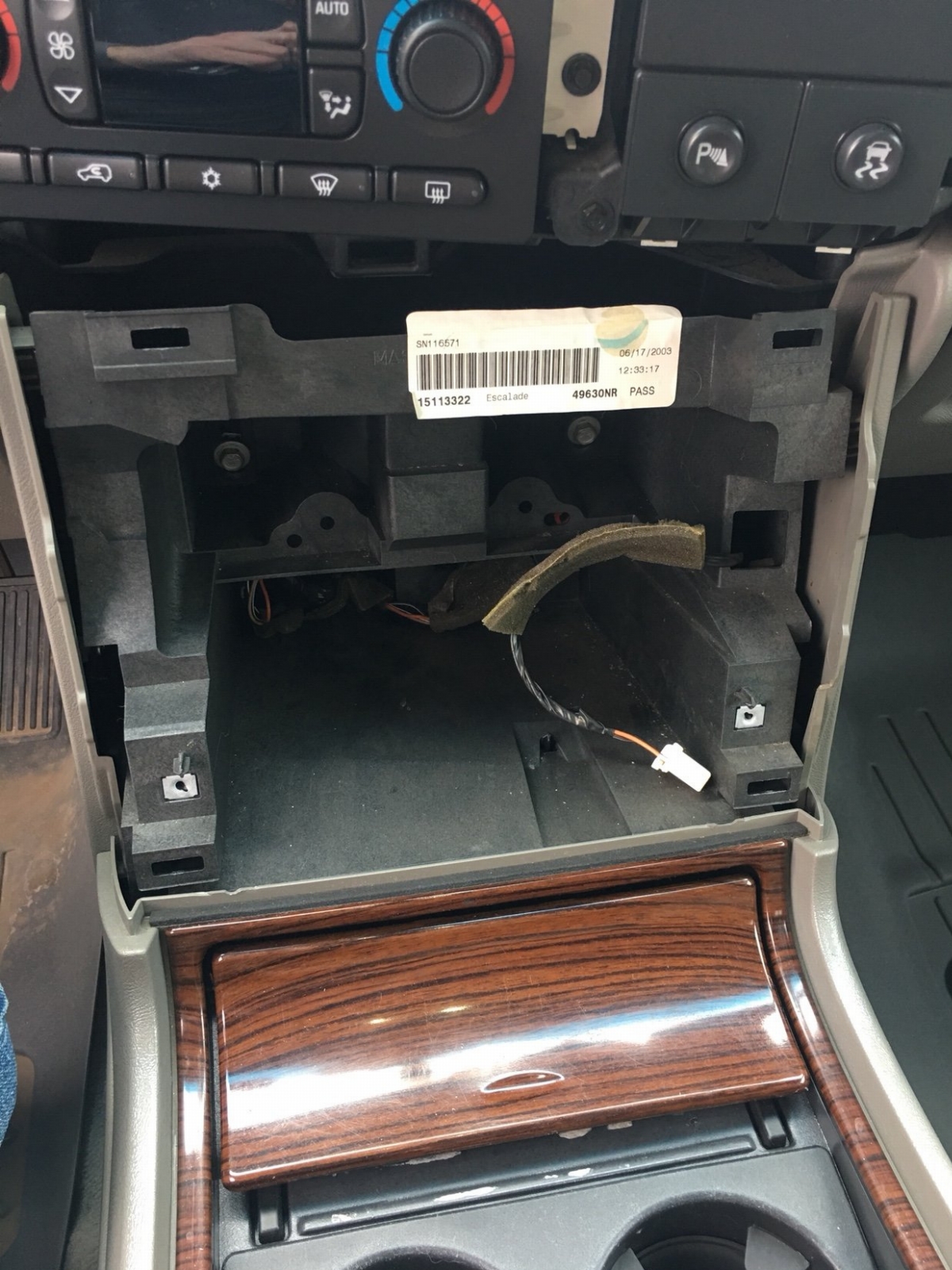

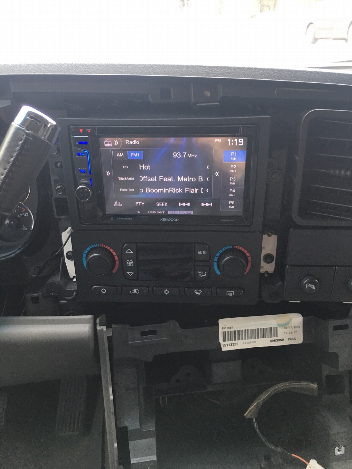

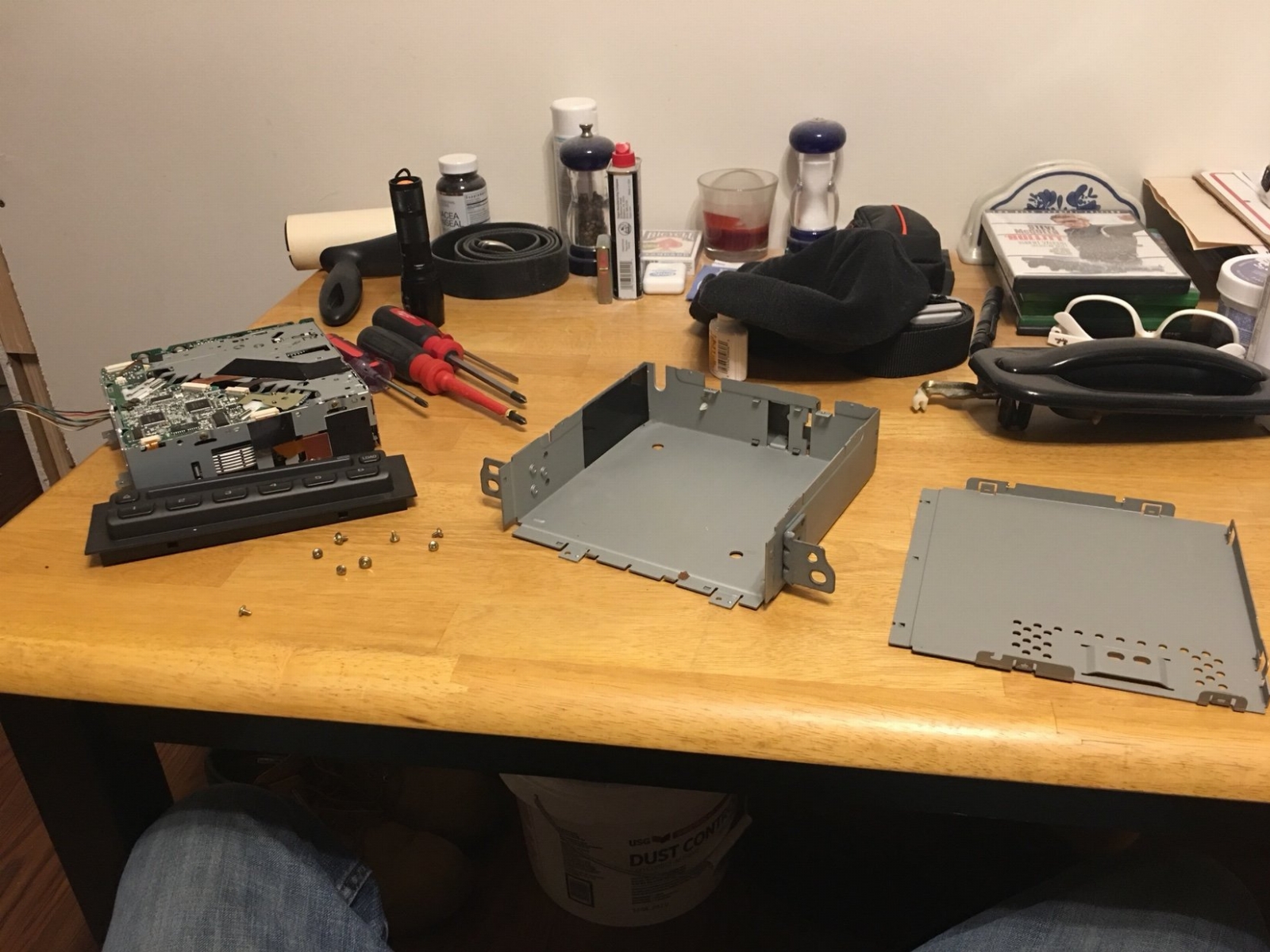

Installed the Kenwood HU
Pulled the factory CD changer
Then gutted the CD changer, I’m going to install a single din pocket in the case and mount it like it was from the factory, should have it all set Tuesday night
Yes!,...put the same unit in my truck a couple weeks ago,.. added a backup camera too! I love it

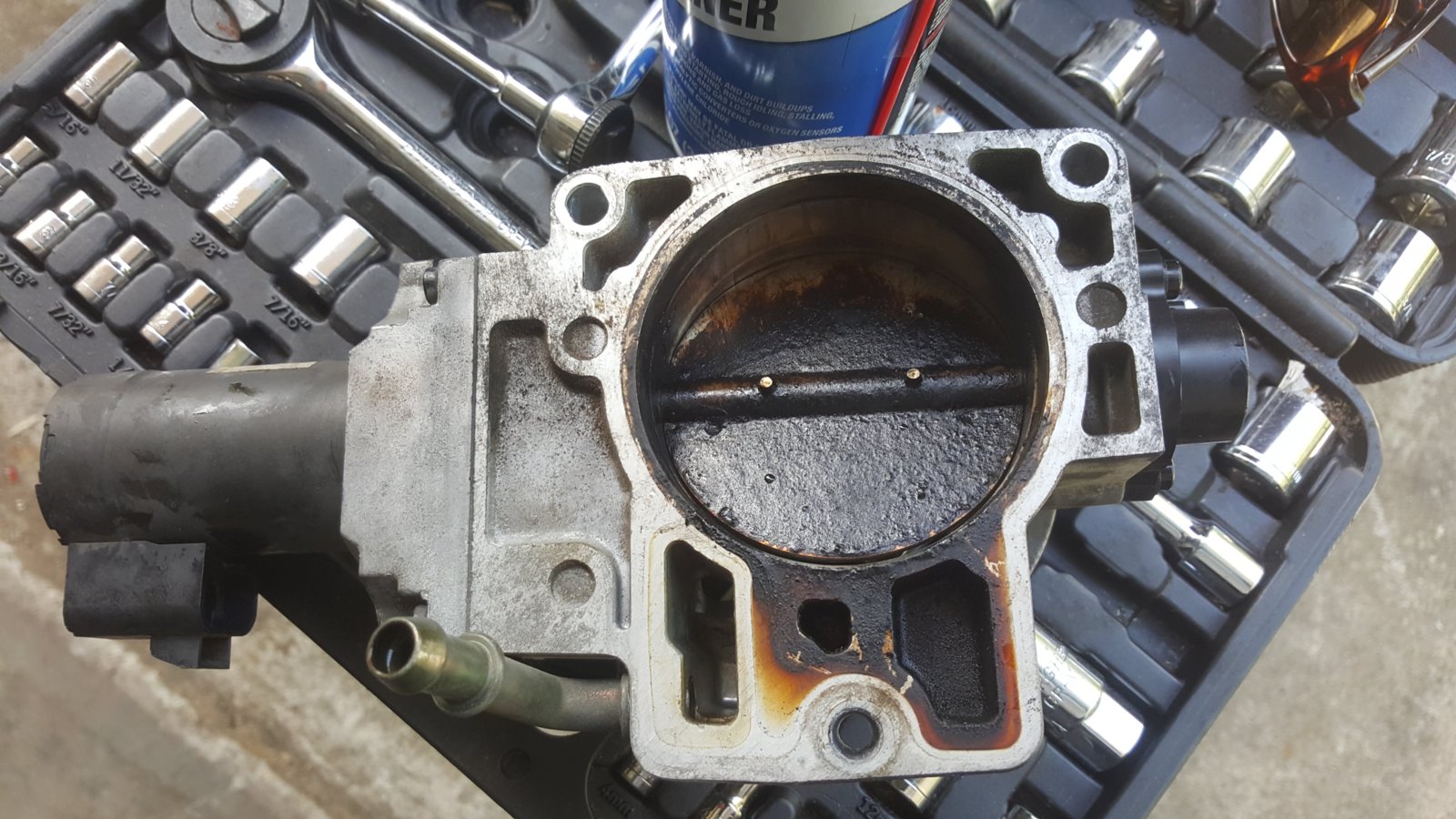

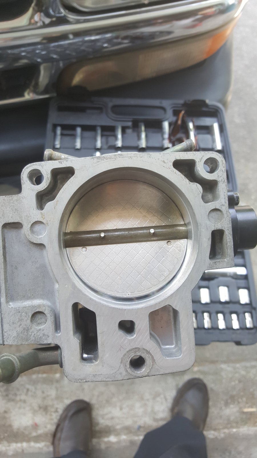

Cleaned out the throttle body, then my friend came over with his Snapon scanner and monitored the sensor voltages, trims, and all the stored codes. Said the MAF voltage is a little off and suggested I clean it next. Cleared all the codes.
Motor ran and drove great for 2 evenings without any CEL or any troubles. Next cold morning, my wife started it up without any problem, got 5 minutes down the road and CEL popped with REP mode... had to let it sit there for 10 minutes until the temp got above 185, then shut it off and back on again so she could drive it. CEL was off by that afternoon when I went to take a look at it. Took it back to Autozone to see if they could pull any stored codes. Sure enough, P1515. Looks like that TB sensor is going to need to be replaced. The number printed on the sensor indicates it's an AC Delco... too bad I don't know where the PO got it from, I could warranty it.
Here's B&A pics of the TB. Definitely needed to be cleaned.
OH... and now there's a pinhole leak in one of the plastic side tanks on the radiator. Gotta love high mileage vehicles. :banghead:
