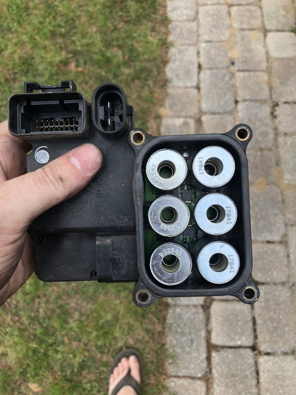

Last night fixed my intermittent ABS & brake light coming on. Resoldered the connections inside the abs module. Unfortunately, when I hooked the battery back up, the airbag light came on! Had to put in new sensor. So it cost me $75 bucks instead of free, all seems good though.

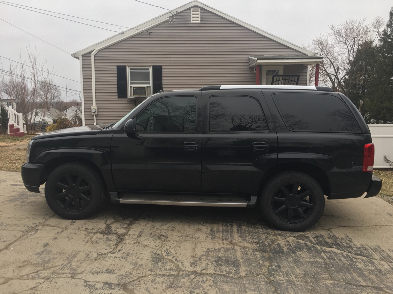

I finally scored a clean set of color matched Denali door handles. Looks so much better going to wrap the chrome on the rack & boards along with tinting the tails & 3rd brake light

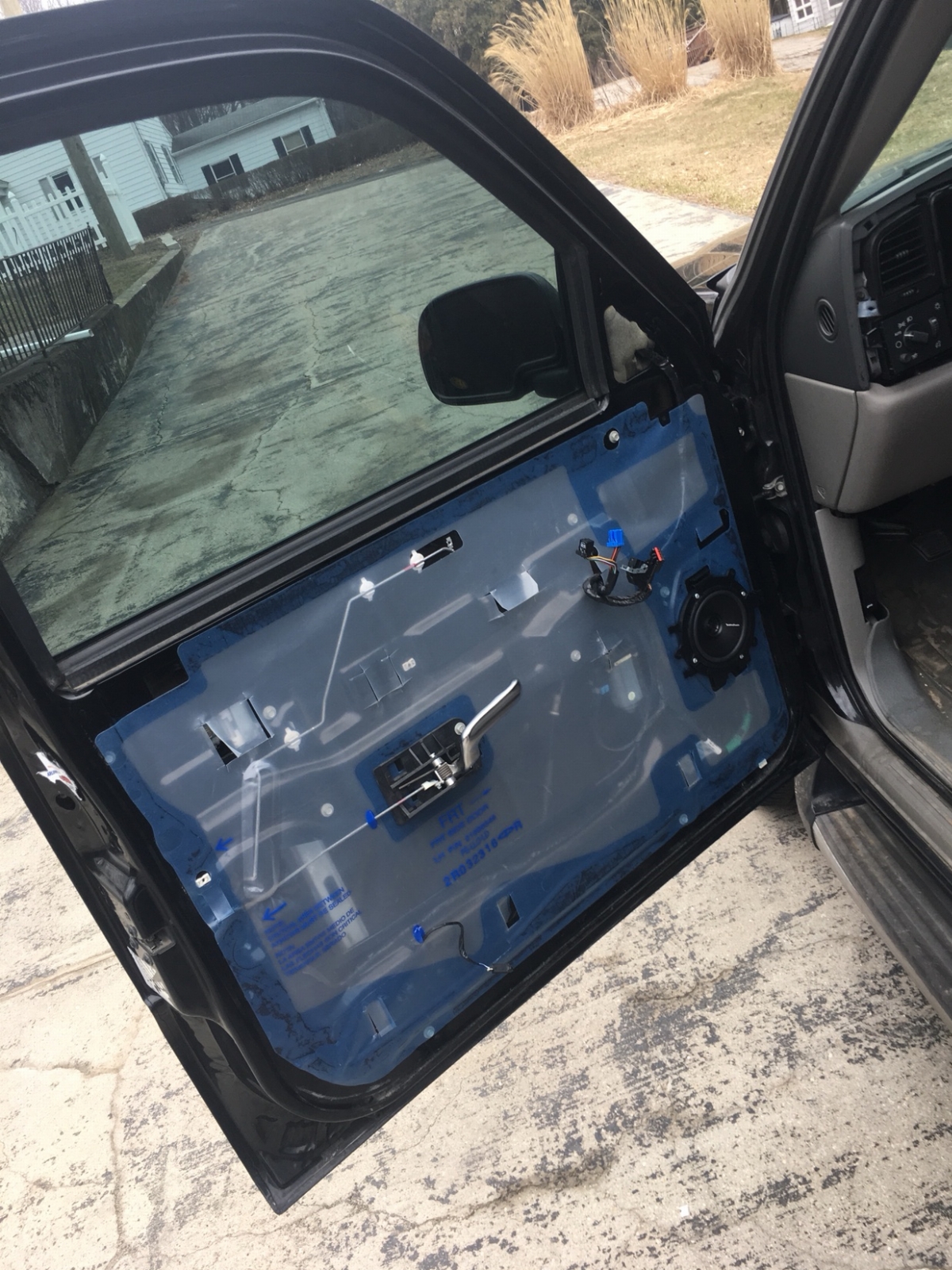

Replaced the driver door water deflector since it was missing, it’s not shown in this pic but I made another hole for the door switch wiring so you have enough slack to hook up the switch with the door panel
Replaced the amber 194 turn signal bulb to match the rest of the pure white LED’s looks perfect now

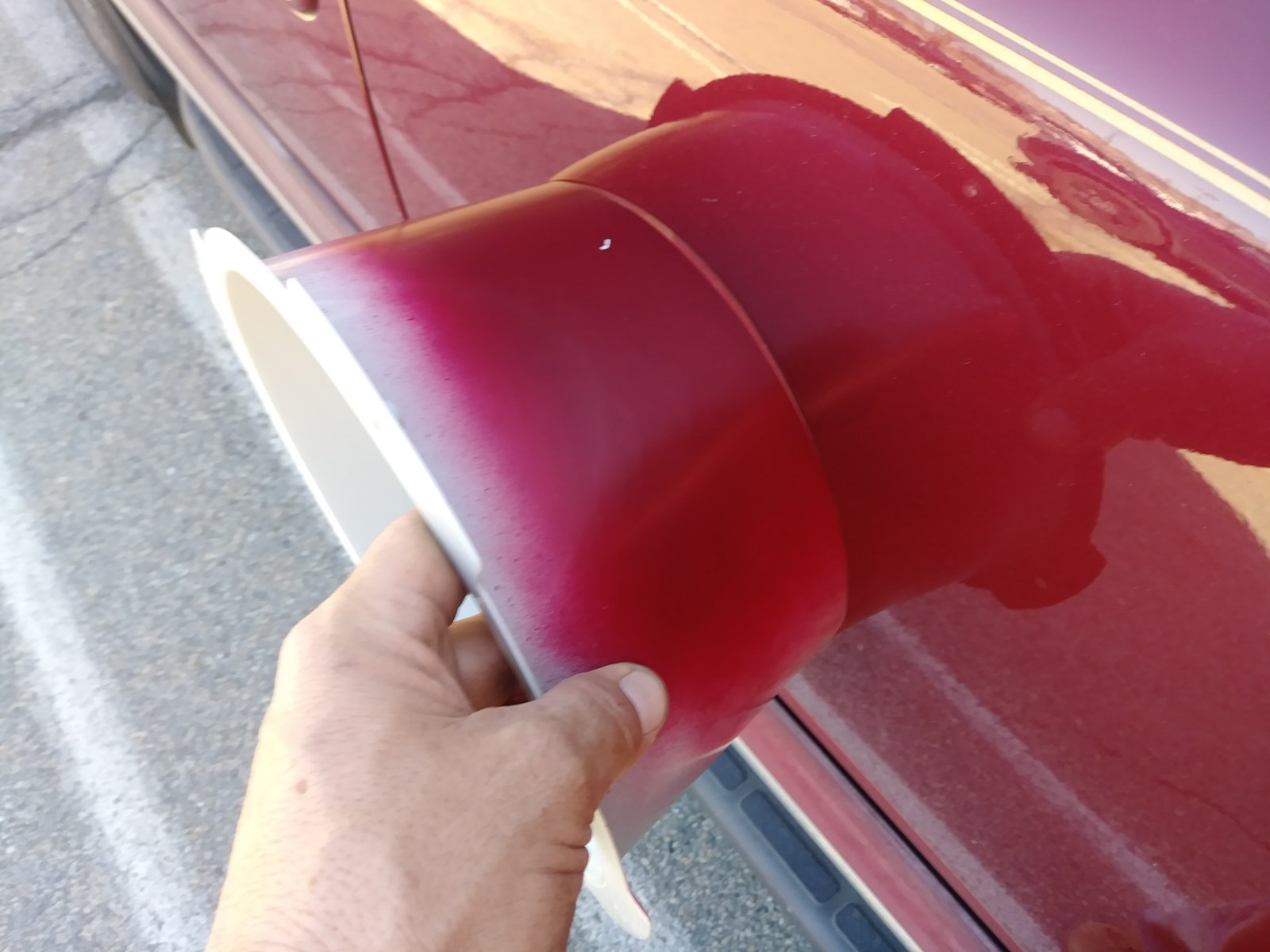

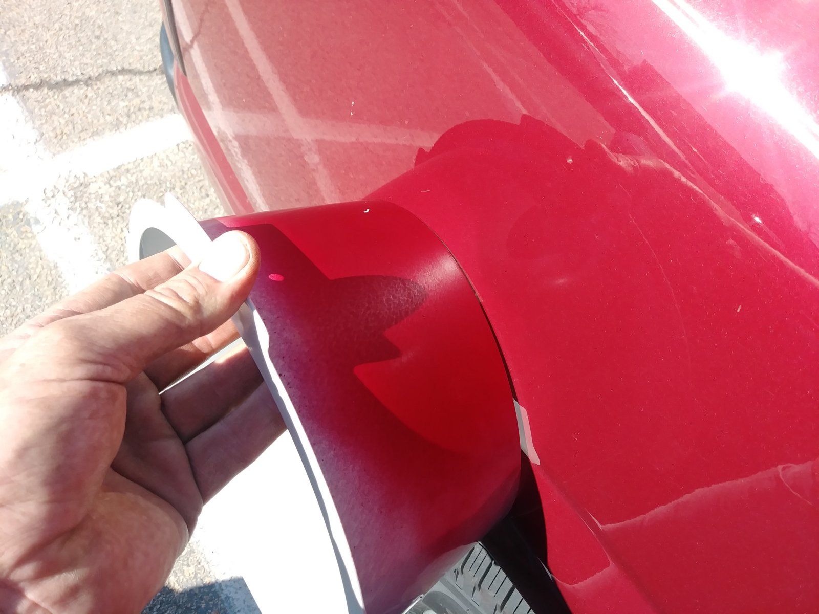

so a while back i bought fender flares, they come black, thought about running them as is but after holding one up on the truck that went out the window, its not the right black. so i ordered up some paint thats by rpo code. it came yesterday so i did a test spray on some plastic i had laying around to see if its close or not.
id have to say its pretty damn close. took two pics, one in direct sun, the other shaded some.
now i need to wait for a 70 degree day for painting. min temps blow.
33,200
51,447
View attachment 195974 View attachment 195975
