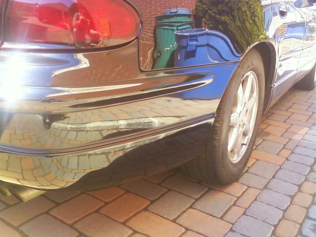

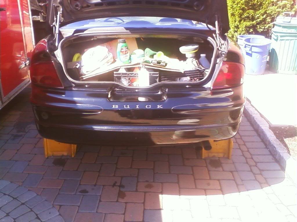

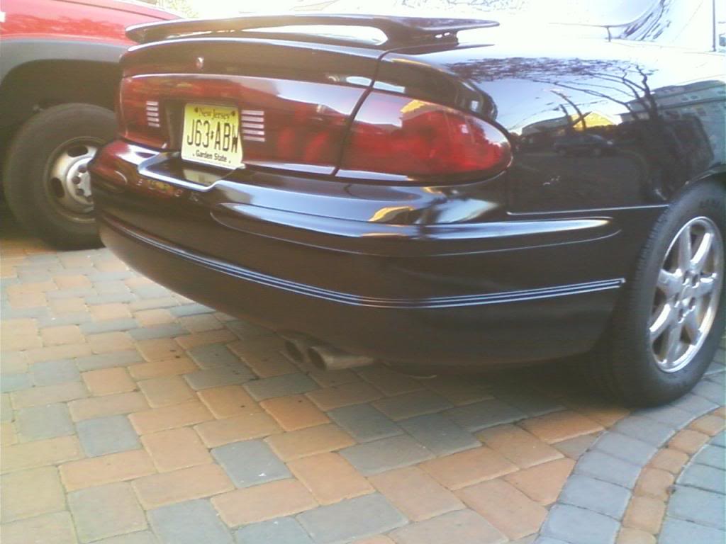

i sure did!!!!! that other pic was just cleared and put back on, its way easier to wet sand with it on the car. i had to wait for winter to end, got it painted on the last warm day of fall, then i had no will to be outside wet sanding in freezing temps. so spring hit and i finished it off.

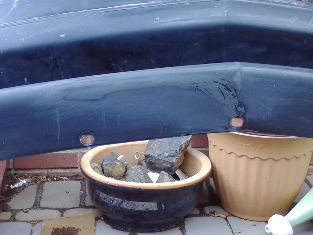

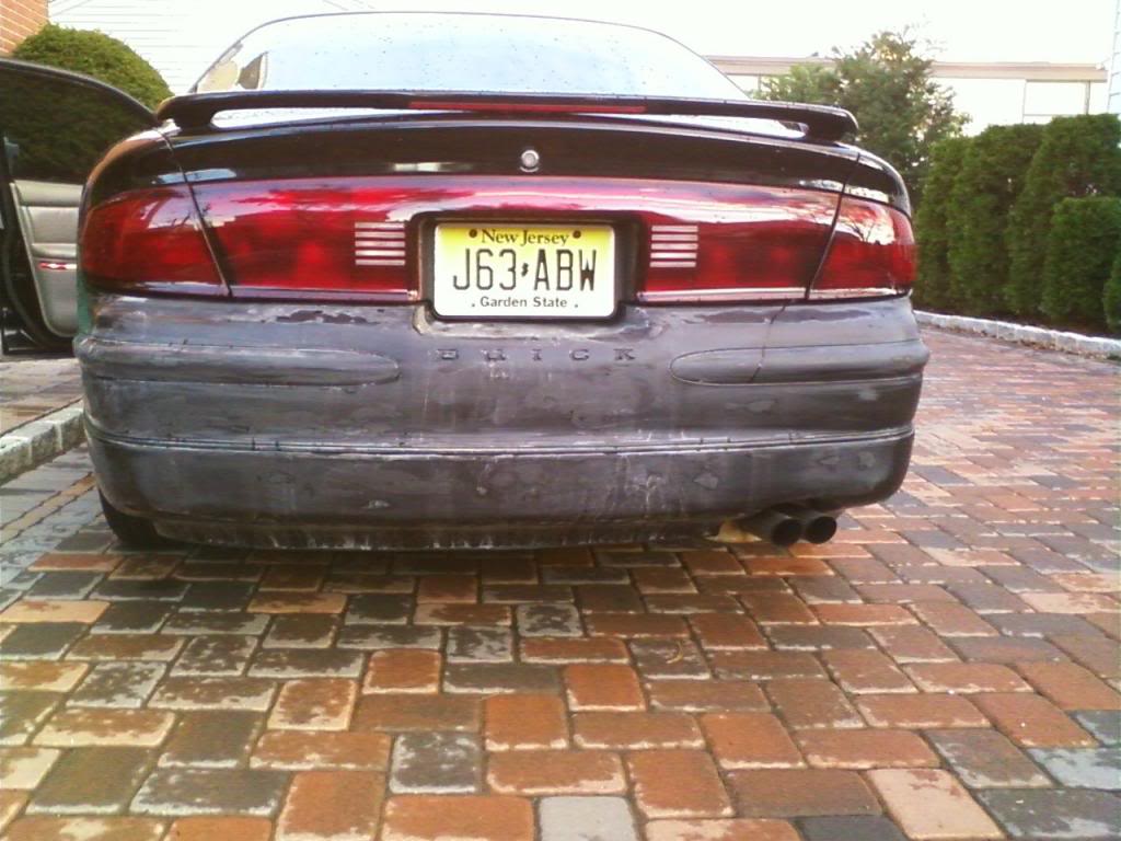

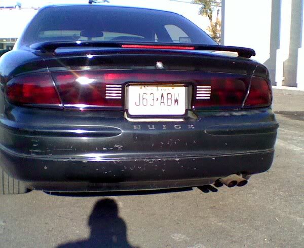

this is what i started with
this is after cutting every last nick smooth with a razor, then filling and sanding.

i was pretty amazed myself.
all duplicolor less then a 100 bucks in paint and supply's, i even primed it due to all the filler, and sand paper and bumper epoxy. i did 3 coats of paint, then 5 coats of clear. knowing id be sanding off 2 coats.

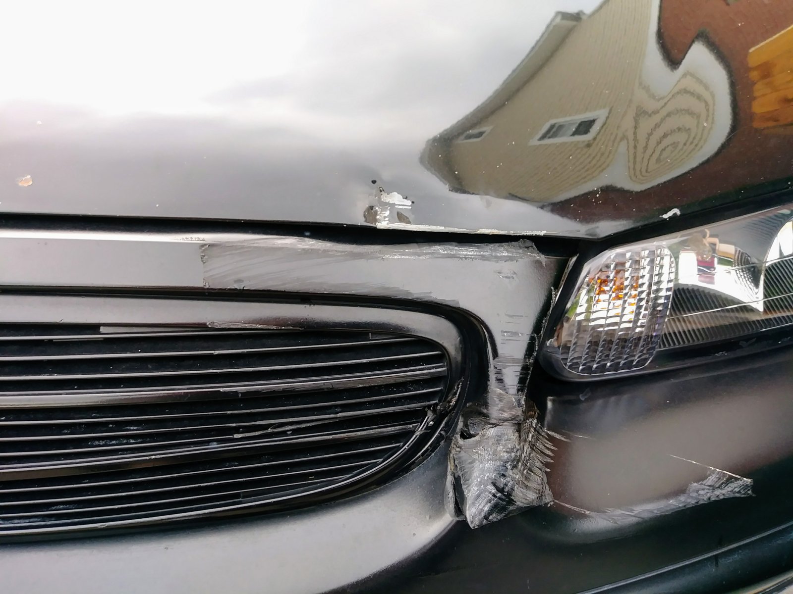

it came out so good i did the front bumper as well. that had a large crack i on the bottom i had to repair.
then some dick backed into it while it was parked over night.
drilled a hole at the end of the crack then used the same filler kit as before but i used the mesh reinforcement on the back side. ran out of filler at the very end there, used to much with the mesh i guess. but its on the bottom, cant see it.

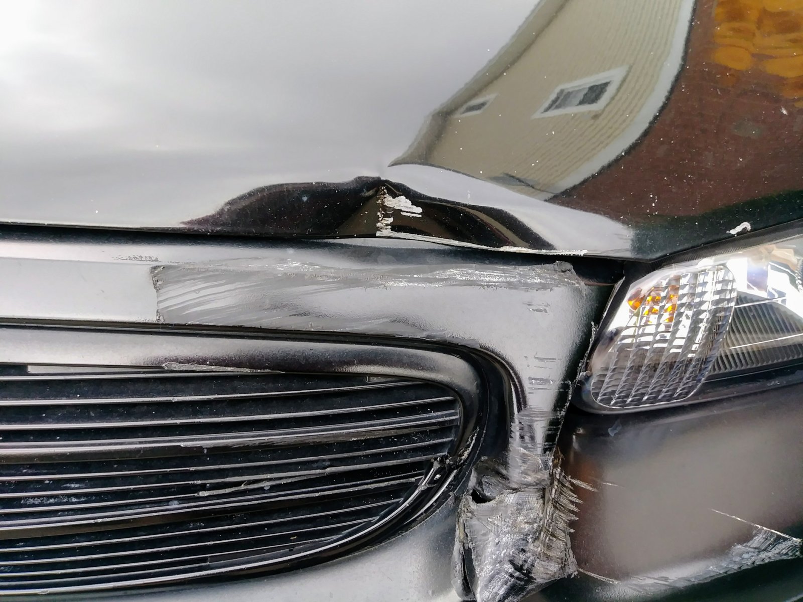

hit and run fun
bent the hood back with two adjustable wrenches and a rag. what horrid sounds it made bending back.
those headlights are weeks old at the time, just missed it.
also cracked my IC res tank that lives in that corner.
my CSI show watching skills tells me it was a pick up truck rear bumper. its the only thing high enough, after he hit me, when he drove off the under side of the trucks bumper caught my bumper and ripped it.

hit and run fun

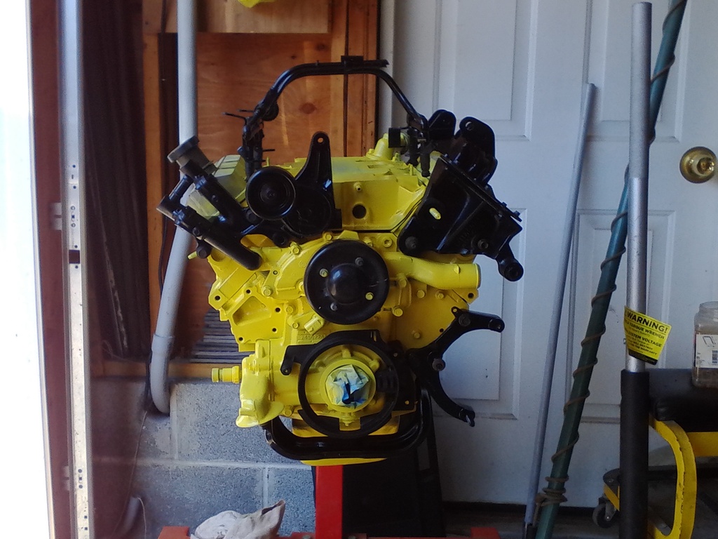

this was all high heat paint. wire wheeled all the rust off, then prep sprayed, then high heat primer, then many coats installed after that. theres got to be 8 coats of yellow and primer easy, all black parts got 3 coats.
only part where the paint has come off is the top of the blower, it rubs the hood liner in a few spots.
