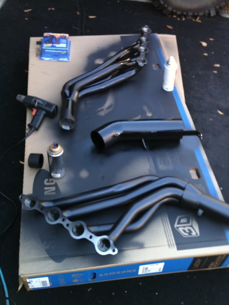

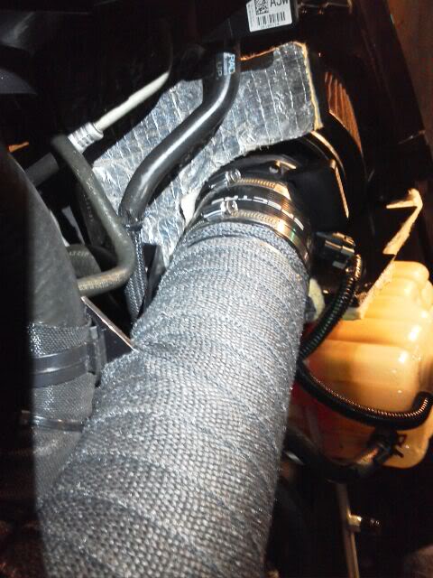

Thought I had more detailed pics. This is the closest one I currently have.
Will try to remember to get more asap.
This was my first CAI tube wrap, SO I didn't wrap the couplers.
This is how I currently Wrap CAI Tubes.
Coupler, MAF. From end to end.
I also wrap ALL Hot Lines and hoses. Under hood heat reduction has been substantial!
Coating the Tube and my old set of headers.
Its Sprayed inside and out, then baked with the heat gun.
Use this stuff and 3M super 77 spray adhesive to stick it on the box.
