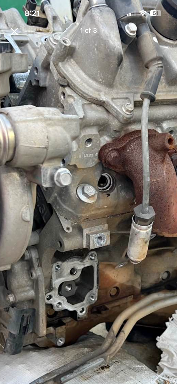

My truck has supposedly had the heads off and a full dod/afm delete with a btr stage 2 truck cam. But there is alot of evidence against this including the fact that there was supposed to
be ARP head bolts, now I am pretty sure these arent ARP, but if not then what are they

The ARP bolts I used were black, so that's that.
I cannot find any head bolts in that sheen it's very interesting.
Are they all like that?

Can you take a different pic of the heads? Where the head bolts are, zoom out a bit, not so close. That "Fastener" looks flush to the piece of metal that its affixed too, head bolts usually stick out further so you can get a socket on them.

I've torn apart a butt load of LS motors, never seen a head bolt like that. It almost looks like a freeze plug

Its just a head bolt, nothing out of the ordinary.
Fel-Pro M12 Thread Hex Cylinder Head Bolt Set - ES73121​
MAHLE Head Bolt Set - GS33938​
Those bolts are readily available from jus about any auto parts store or Summit and Rock Auto.
