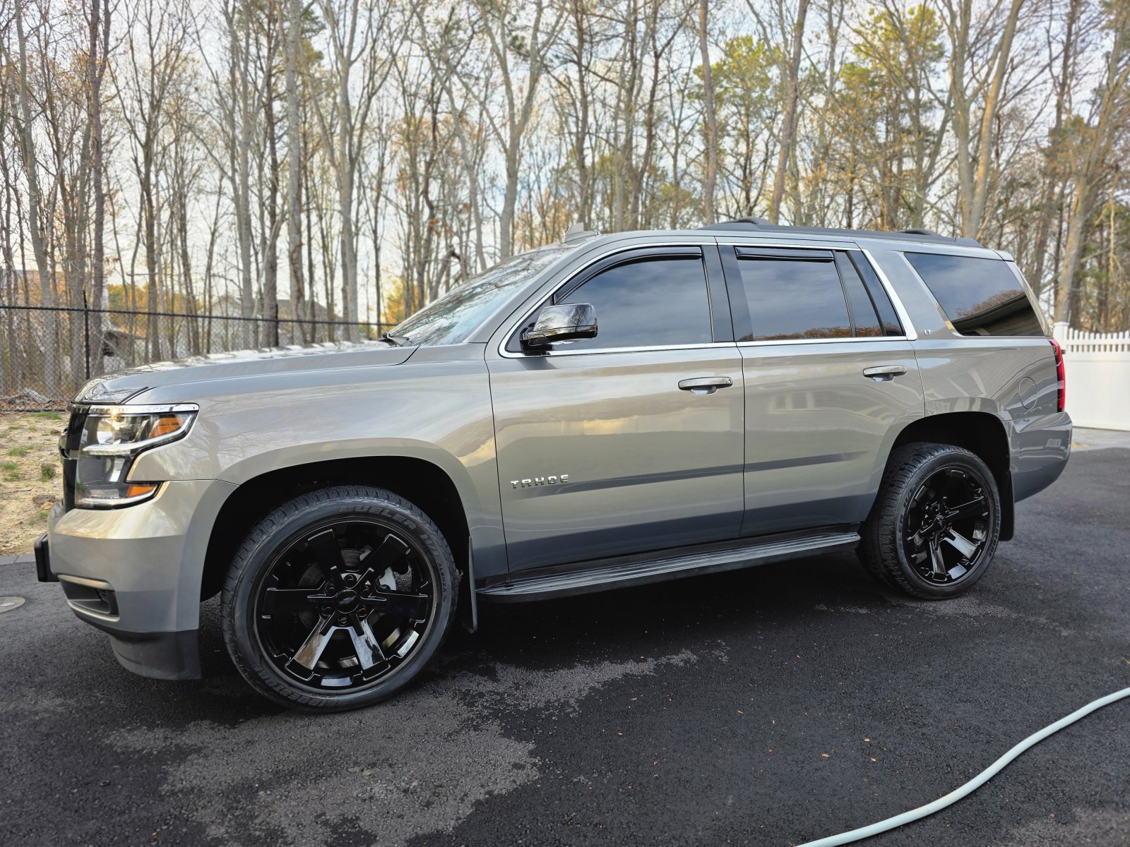

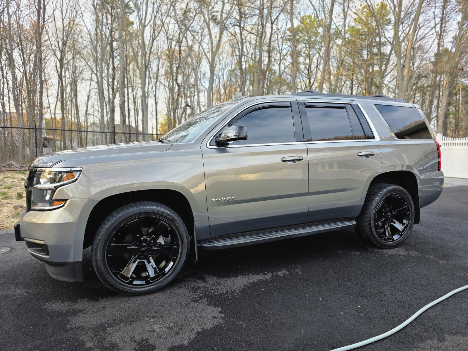

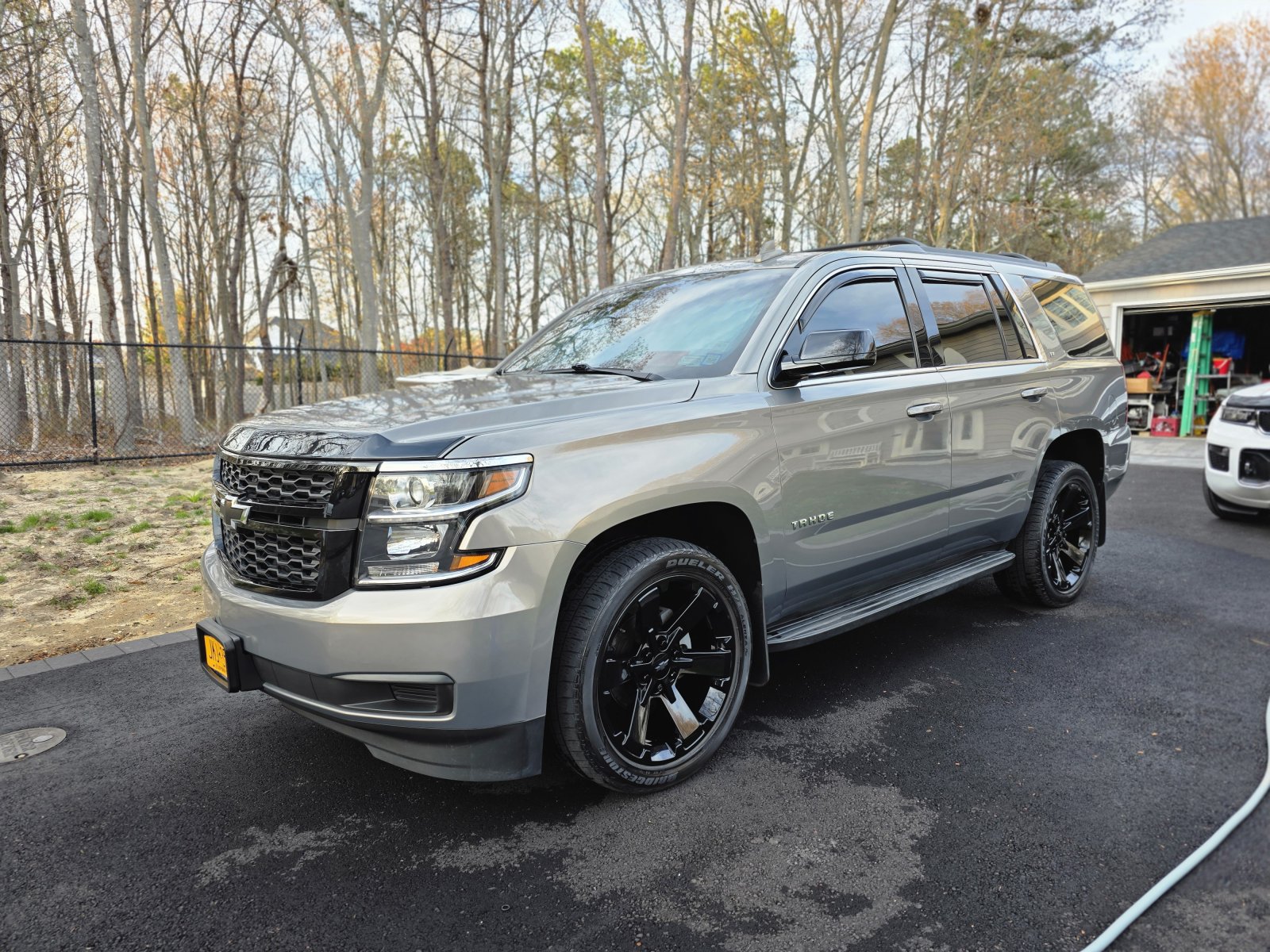

Will get some vid clips posted soon
Have brembos all around sitting in the garage need to paint and mount

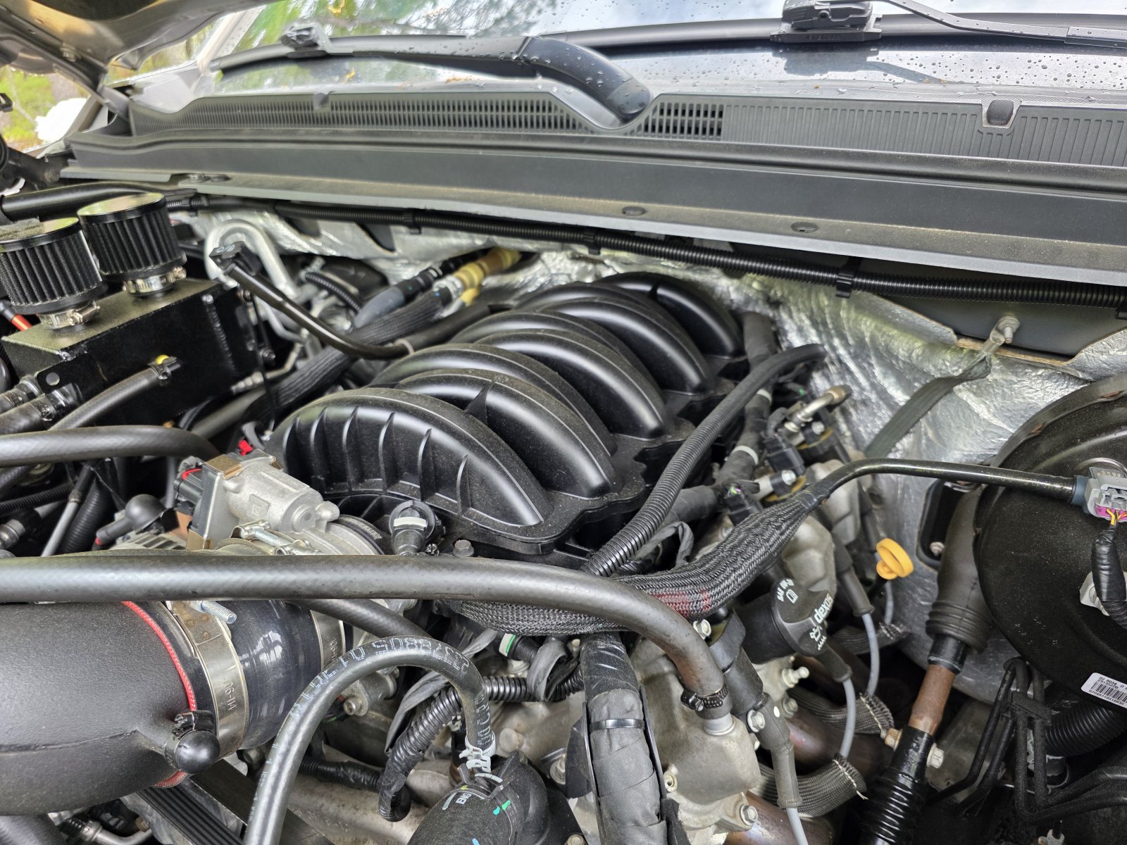

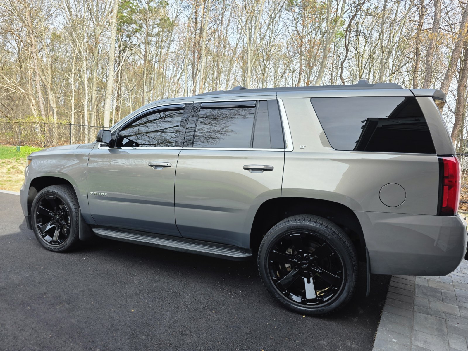

I recommend you get this for your vacuum pump delete.
NYBRD
NYBRD
Jul 29, 2024
188
288
No need for it the way I have things routed
