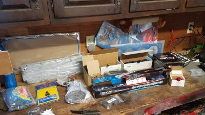

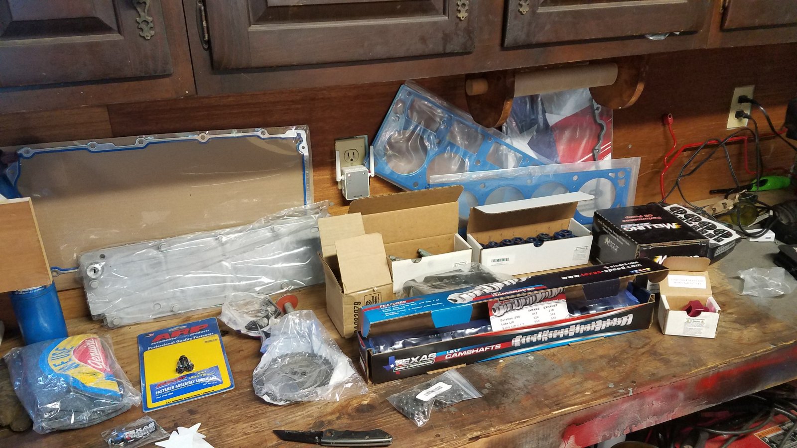

So I ordered the dod delete kit from texas speed and a 212/218 113lsa. Because even after my tune a few months ago and turned off dod it managed to start having a lifter noise from drivers side.

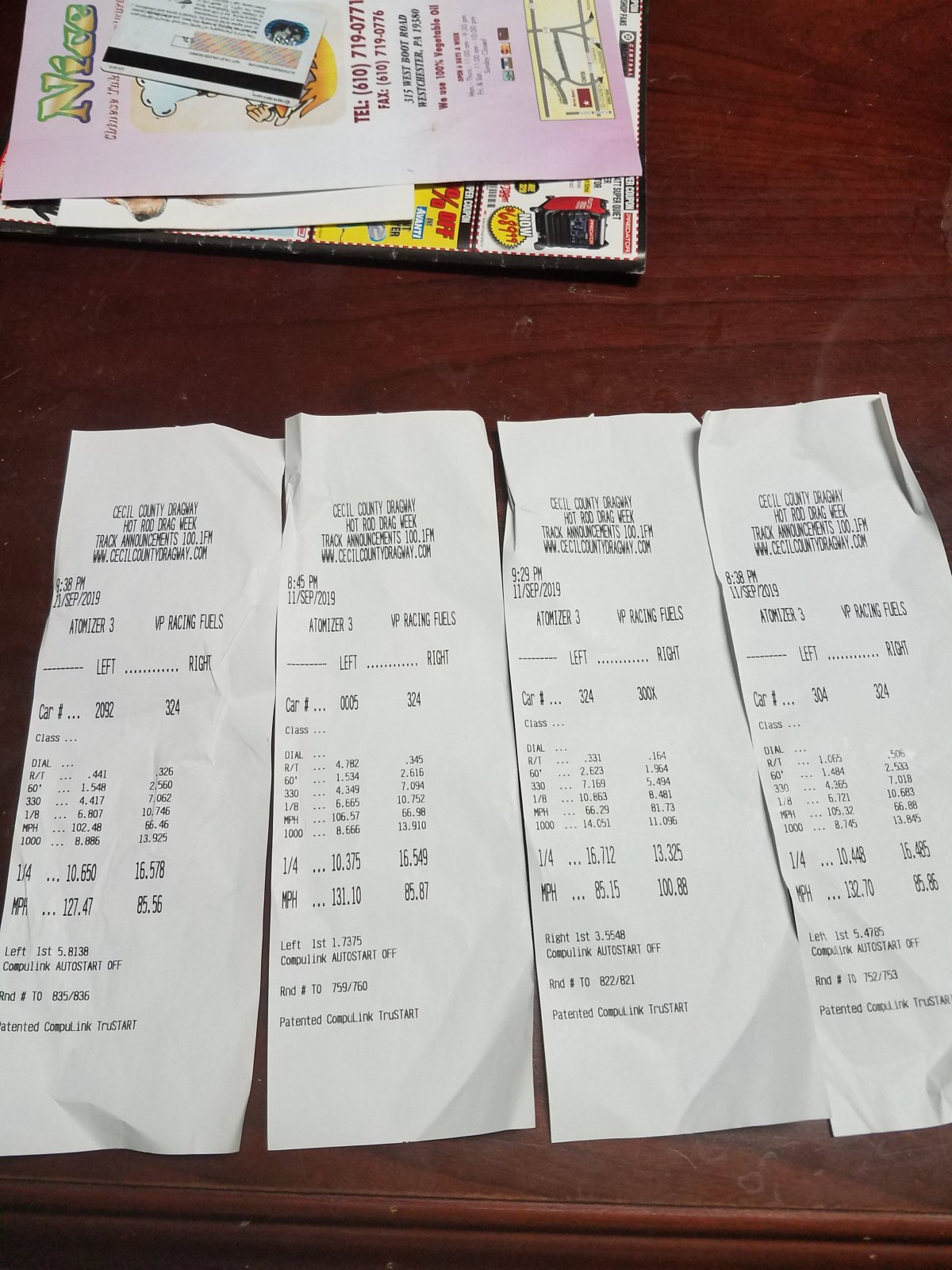

Love it! My old eyes can't read those timeslips though!
My best was:
60' - 2.507
330' - 7.009
660' - 10.649
1000' - (blank this night)
1/4 Mile - 16.448 @ 85.34 MPH
6,400 Pounds race weight, E85 @ 73% Alcohol Content. Launched at 1750 rpms. The math puts her at 307 Rear Wheel Horsepower through the traps.
Magnaflow Cats and Y-Pipe, BlackBear tuned (but not Ethanol tables).
My best was:
60' - 2.507
330' - 7.009
660' - 10.649
