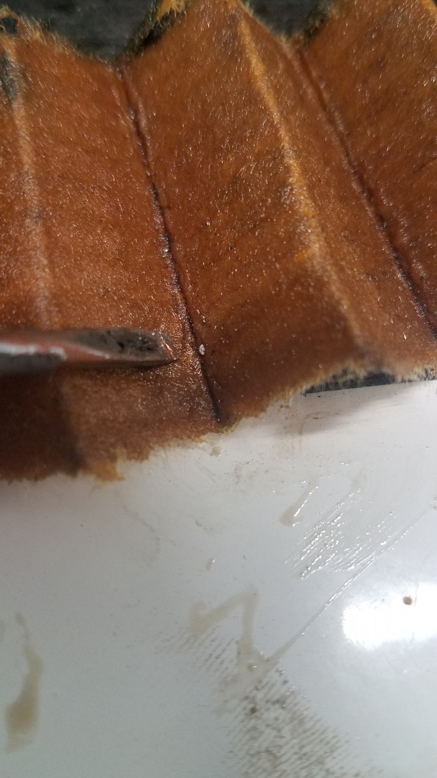

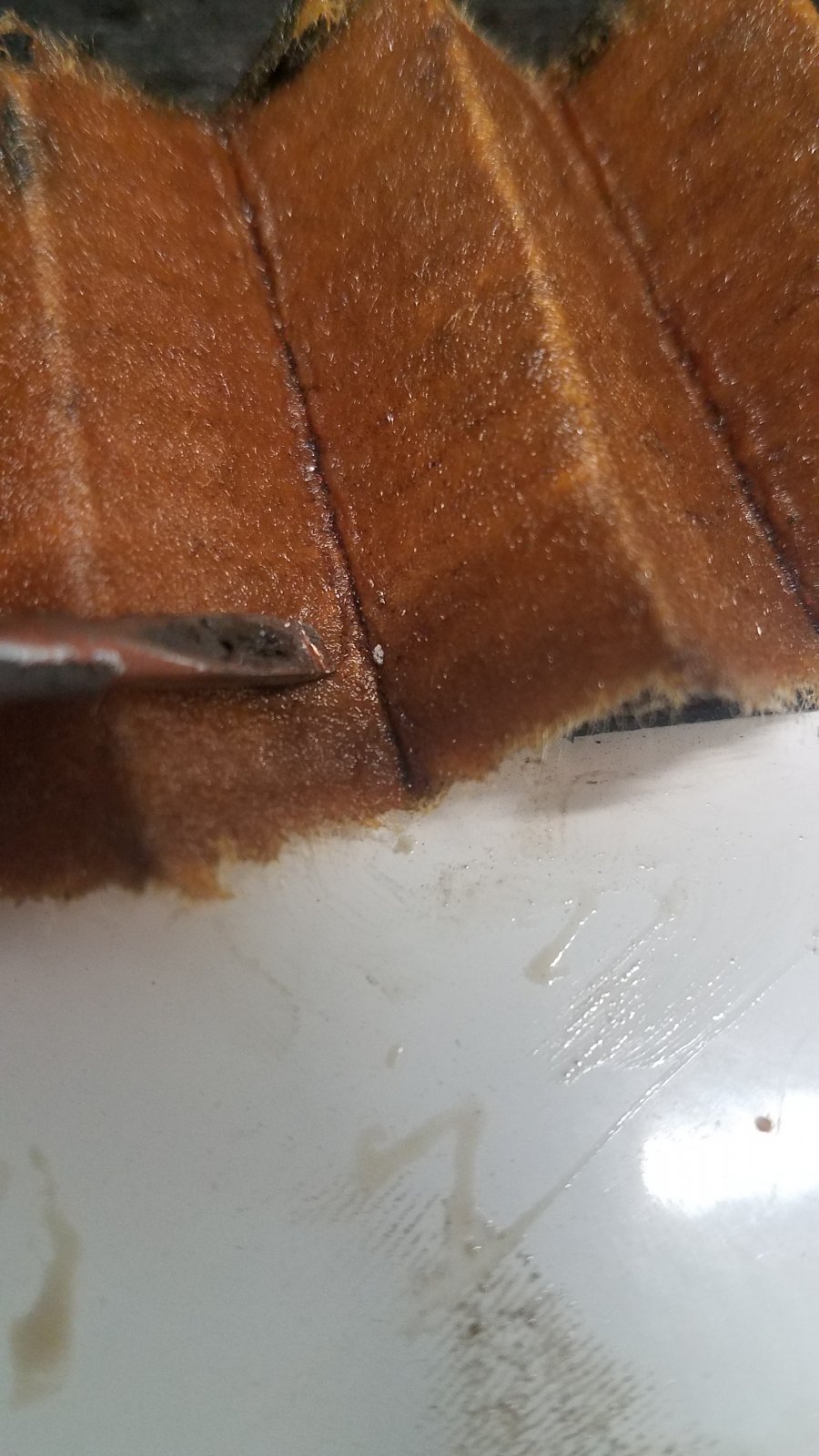

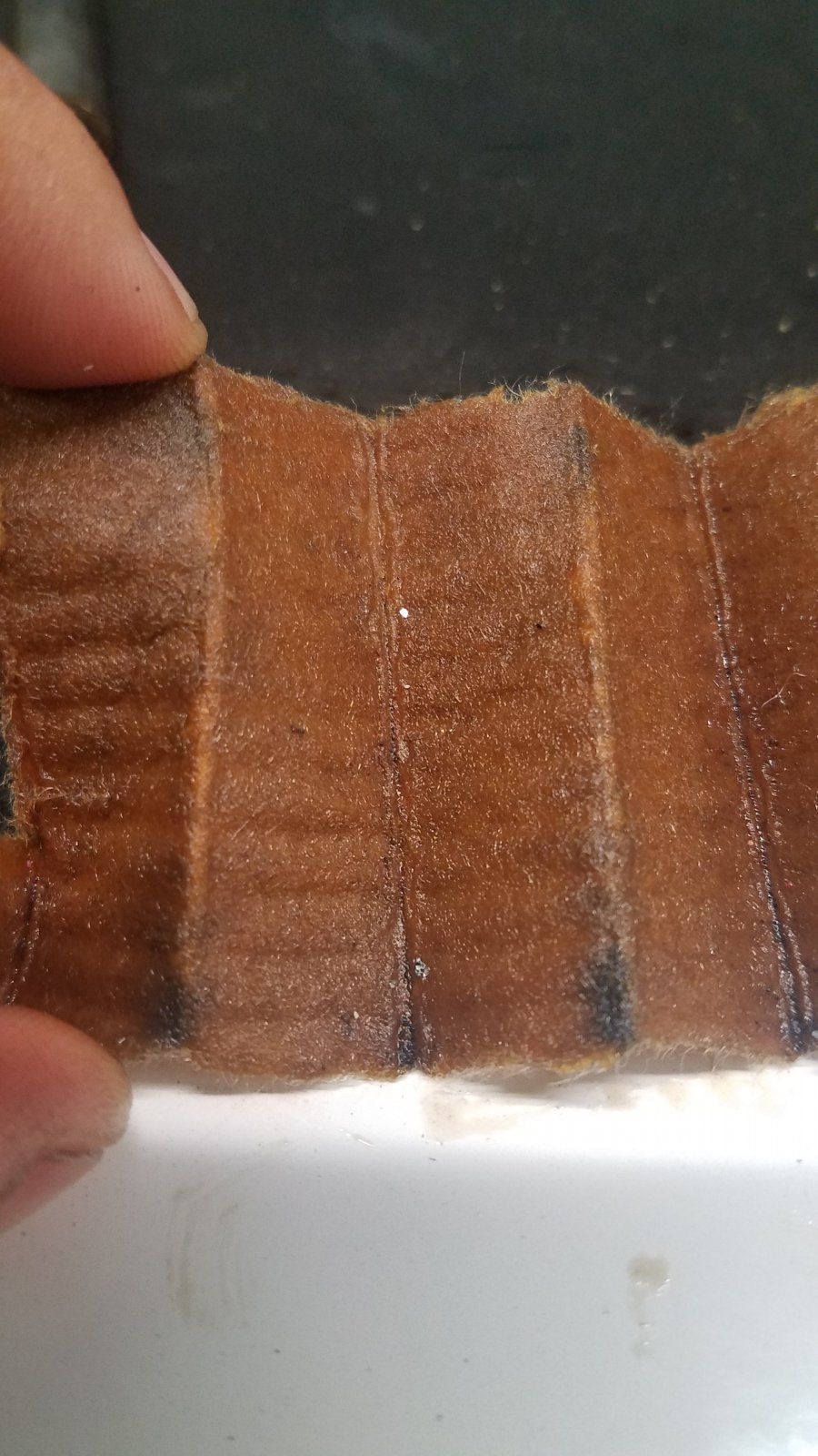

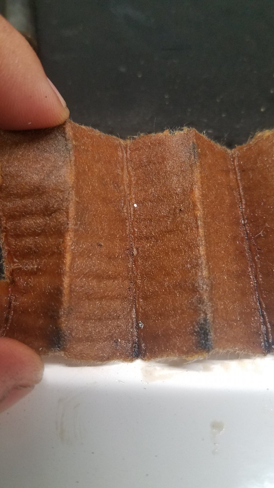

Update.
1k oil change there is still metal dust "needle point sparkles" in oil, I took the filter apart and found 13 ball point pen flakes in the paper filter. Zero noises its quieter then before top end build actually. So im just going to continue to run it untill it becomes a problem
33,344
51,835
Update.
1k oil change there is still metal dust "needle point sparkles" in oil, I took the filter apart and found 13 ball point pen flakes in the paper filter. Zero noises its quieter then before top end build actually. So im just going to continue to run it untill it becomes a problemView attachment 251898 View attachment 251899 .
Have an idea where it might be coming from?
JDopirak
JDopirak
Mar 26, 2019
94
77
Wont know till I open up the motor and i honestly want to put that off as long as possible because its a pain getting the motor out by your self. If it was in my mustang or something similar i would have already pulled it.
