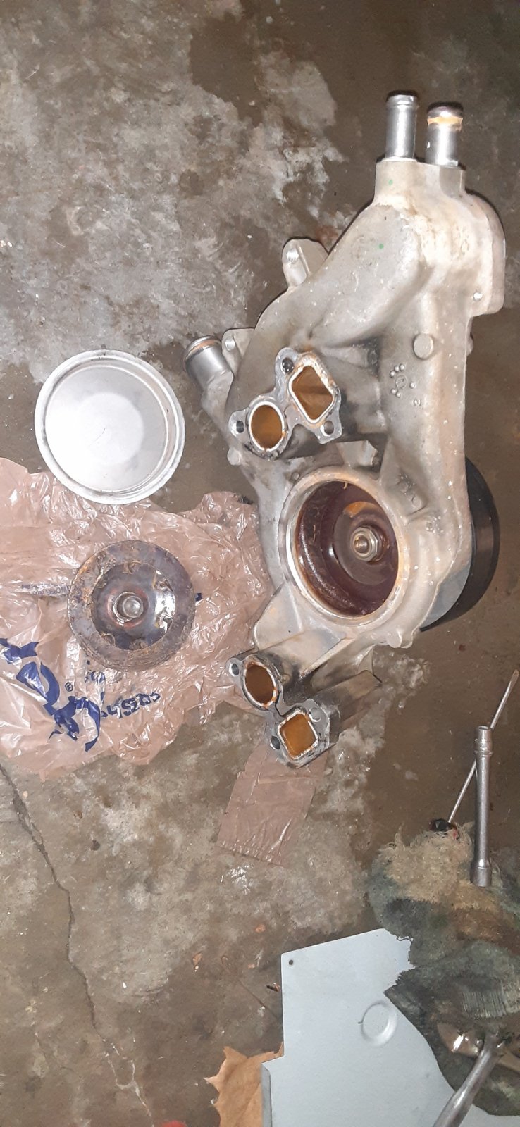

The other day the tahoe overheated while running errands. We were able to limp it home being we were only 2 to 3 miles from home. But anyway as soon as I popped the hood I seen coolant coming from underneath the water pump. Long story short the propeller came off the shaft and the rear large plug on the back of the water pump came off. So I replaced it and filled with coolant.. No leaks from the engine but there was a leak in several parts on the passenger side leading to the rear of the vehicle. Is there a heater hose or something that routes on the passenger side frame area leading to the back?

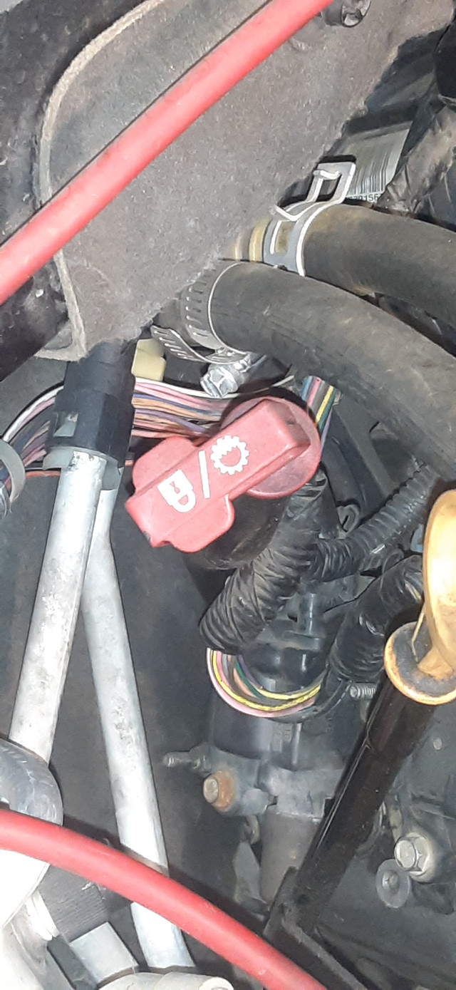

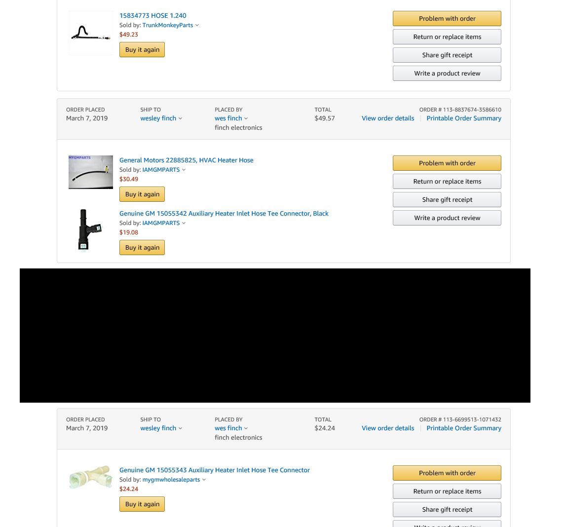

It could also be leaking from the plastic T in the coolant hoses where they come out of the water pump itself. The two hoses connect via a T and then connect to the water pump. It’s on the passenger side of the block down a bit lower. Mine sprang a big leak this past summer. Dorman makes a metal replacement T that I picked up from autozone.

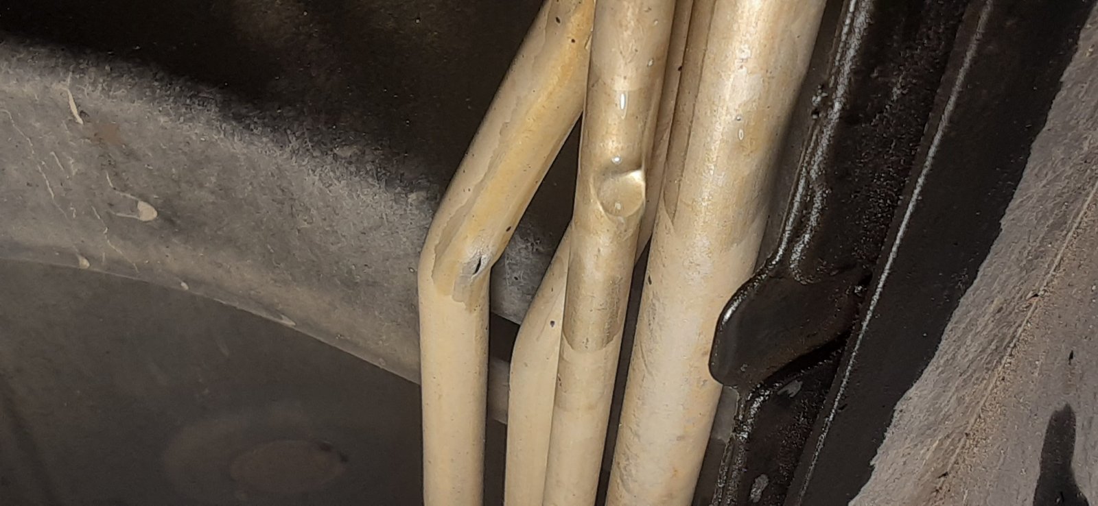

i'll check there as well. I found a small split in the metal lines that run under the passenger side of the frame. They seem to run from looks like heater core outlets all the way to the back. Damn! Is there a way to bypass the rear heat until I can find the metal lines

if you can get a flaring tool on it, I've done that before. anything to keep it from sliding off and it will be fine. if not, yeah. double clamp and hope for the best.

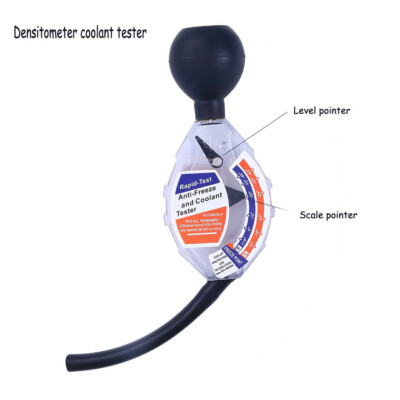

they sell a tester at the auto parts store that you can use to check the coolant freezing point, then you know if you need to adjust the mix or whatever.
looks like this but different name brands
