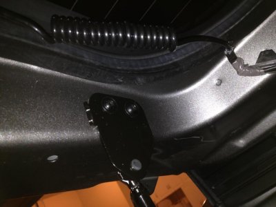

If you have the power liftgate, then you also have to remove the two bolts on the left side of the lisfgate.

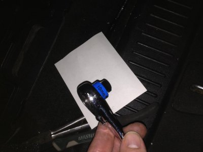

From the inside you have to use the bolt through ratchet, and hold the bolt with the blade screwdriver..

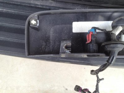

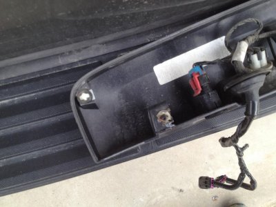

There are four nuts that hold the rear trim piece in place.. This is where you are going to break something You Have Been Warned.
IF you can remove the nuts, good for you, if you find that you hear cracking and they just seem to be spinning, Congratulations you have discovered the GM trap of traps. They have put lock-tite on the bolts to put on the rear trim piece... more or less its a stupid design...
There are two plastic retainer clips that still need to be popped, on the top right and left corners. I used the long long needle nose pliers to reach in and pinch them and push them through the holes.
Close the liftgate and then gently as you can pull the rear trim piece off. You WILL be breaking the little tabs where the bolts go through, I would have loved to figure out another way but I did not figure one out.
Once you have the panel off it will have broken tabs, hopefully they are not so severe that they are not repairable.

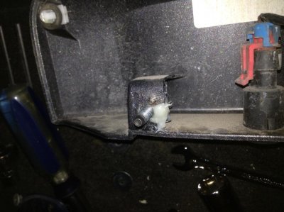

Here is what I ended up with:

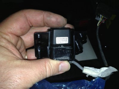

Unplug the camera plug from the harness inside the rear trim housing piece.
The thing you will discover is the camera assembly is actually attached by melted plastic to the rear trim piece. Fortunately that is only the retainer and you can simply remove the two screws to remove the actual camera... Unfortunately for me I had to drill out one of my screws on the original.
When putting it back together, make sure you can see the sticker and do not forget the spacer piece for the camera. It kind of snaps into place, but falls apart easily enough... probably a trick I did not pick up on in my 1 min of messing with it.
I would check to make sure the camera is in the housing the correct way... I didn't try, but I think you could put the camera in upside down... plug it in ad-hock with the rear hatch open and make sure the camera is right side up... Have someone turn the car on and put it in reverse and check the video...

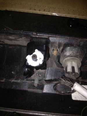

With the hatch closed, and the window open, I then took the vise grips and grabbed the head of the bolts used to hold the rear trim piece and the 10mm deep well sockets to unscrew the nuts. This was not easy... I used the 1/4" drive, and the nuts on mine were very difficult to remove with the lock-tight on them. Matter of fact they were hot by the time I got them off...
If you lose one in the liftgate, you can reach in and grab them at when you open the hatch.
Fortunately the lock-tite was a one time use, so putting the nuts back on the bolts is really easy.

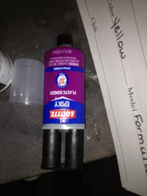

I then took the epoxy and mixed up a lot of it... be generous.
Took the head of the bolts and dipped them in the epoxy, and put them into the slots...

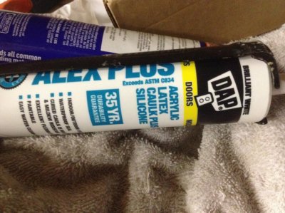

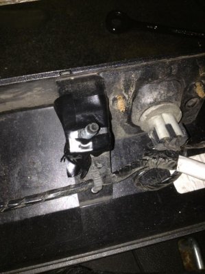

I did my best to clean it up as best I could with a screwdriver and paper towels, then I applied black electrical tape (it is what I had). And then I put a dob of the silicone/caulking around the bolts.
The reason I did this was:
1) I did not want the glue to set up before I installed the panel, If I did not have them exactly lined up I might not have been able to install the panel into the liftgate.
2) The tape kept the epoxy from gluing the panel to the liftgate
3) The silicone sealant was an idea I got when removing the bolts, I noticed there was some sort of silicone sealant applied to the bolts in an attempt to keep some water out... not a bad idea IMHO. The silicone latex will act as a makeshift lock-tite application and keep the nuts from backing out. And still make it possible to remove them later on.
I used the tip of the screwdriver to spread the acrylic silicone over the tape.

Make sure the wires are routed correctly inside the housing. As a little insurance policy I took some dielectric grease and squirted some on my camera plug. It will keep the moisture out...
Now you have to feed the wires through the big hole, stuff the big plug first and then the smaller plug. Then align the bolts carefully and finally align the plastic clips to the hatch and snap the clips.

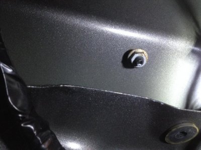

Open the glass and reach in with the 10mm deep well socket and put the nuts on the studs going through the sheet metal.
As I snugged up the nuts, the acrylic silicone oozed a little giving my desired locktite, to help the bolts from backing out.

  • The epoxy seemed to work and hold well, I used a "Locktite" version made for plastics.
