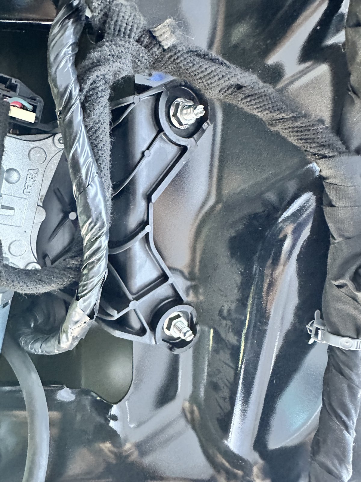

- access to one of those 4 bolts requires removing the wiper motor. I recently swapped out the wiper arm and the new one came off easily (otherwise that would have been another 2-3 hour complication), but the 2 bolts that hold the plastic motor bracket also rotate with the nuts. I can feel the heads on the back, but they are round and there is nothing to grab. The slot on the thread end that is obviously intended to help with removing the nuts are weak and strip easily, way before the nuts move on the bolts. Oddly, there is no corrosion, the metal surfaces are clean and tidy. This was just really poorly designed.

Wiper motor bolts… hold the nut with a 10mm(iirc) open end wrench then then use a small flathead to loosen the bolt, not the nut… the flathead needs to fit through the nut… until you can spin it off by hand
Tried that, the bolts are aluminum and strip instantly with any size of screwdriver.
