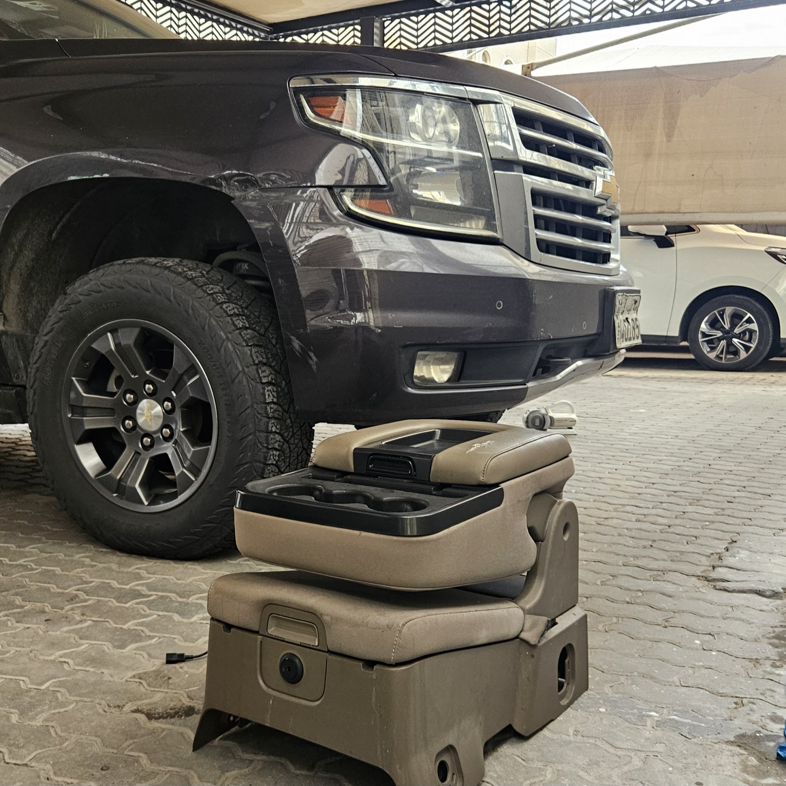

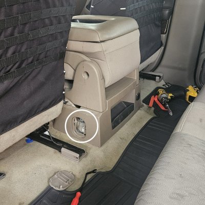

1. Remove the 4 bolts for the jump seat:
Unscrew the four bolts securing the jump seat to the floor.

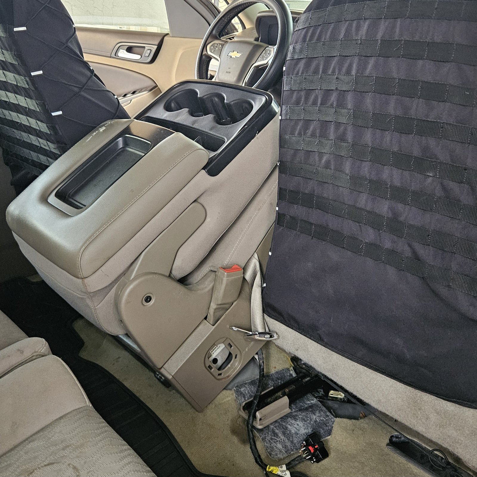

2. Flip the jump seat to the back:
Tilt it backward for access the connectors.
3. Remove passenger seat’s 2 rear bolts:
Unscrew these for easier access to the jump seat’s connectors whichis under the carpet. You may need to tilt the seat forward little bit to access the connectors.
4. Disconnect the 2 connectors for the jump seat:
Unplug both connectors to free the jump seat. Beware the connectors locks before disconnecting.
5. Move away the jump seat:
Lift and remove it from the vehicle.
6. Return the passenger seat bolts:
Secure the passenger seat with the bolts.

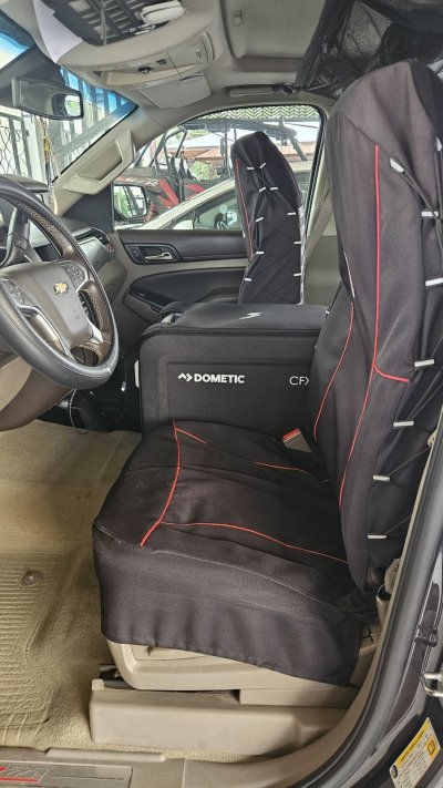

7. Install the fridge and secure it:
Place the Dometic in the jump seat space and secure it with a couple of bungees (temporary for now).
8. Connect the fridge to the front 12V cigarette socket:
Plug it into the 12V outlet for power, and you’re set!
