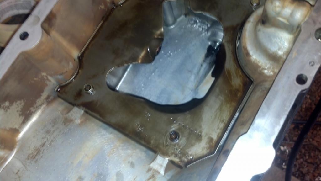

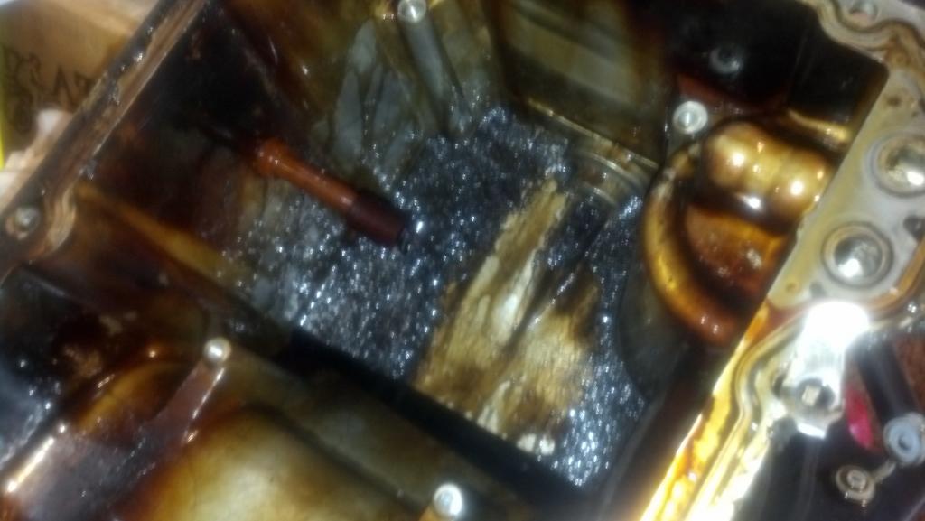

I agree, thicker oil isn't the solution. However, as my pictures demonstrate, if you choose to run a cleaner through your engine, you need to be aware of the higher then normal amount of crap that will be circulating and being filtered and follow a better then normal oil/filter change schedule to help remove it from the engine. The point of the pictures is exactly what dipwad above pointed to, just because the exterior is clean, there is no guarantee about the inside condition. Just be aware of what you are about to dislodge with an engine cleaner like seafoam.

01ssreda4 - listen, you want to start name calling, get your shit and leave.
if that is what is in your motor you have other, much bigger problems. cleaners dont make shavings unless you hydrolock. seriously, that is 10000% wrong. shavings like that should never ever exist in an engine to begin with. that is not normal. i pulled the pan for a gasket change on my old 220k mile 2001 5.3 and only had the most minute amount of sludge. i seafoam every 6 months. why? well, why not?
