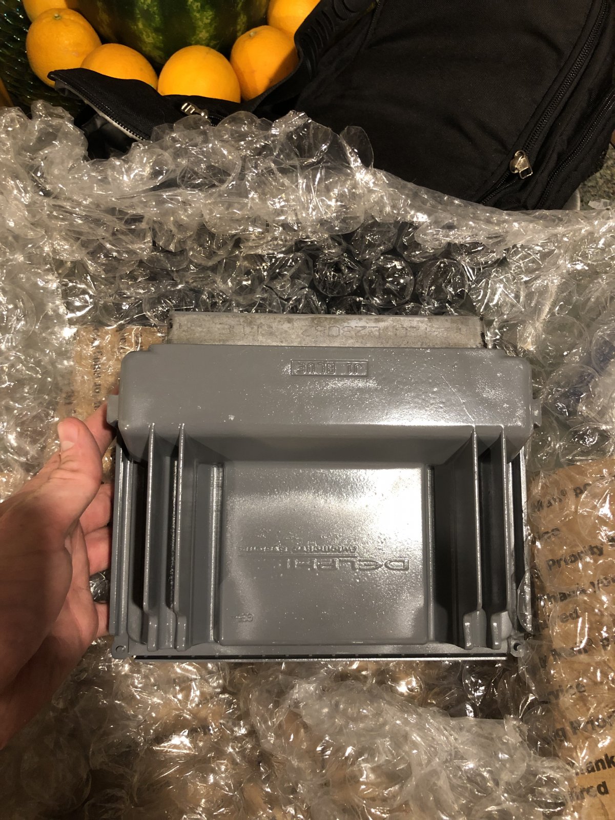

Look what came guys!!! Finally, the long spoken about 0411 PCM. Custom tuned for the 454 by James, the owner of PCMPOWERTUNES. I’m so excited to get this installed! Rear O2s deleted, tuned for the tires and gears, transmission has a “moderate” tune (next step was aggressive), VATS is deleted, Tow/Haul mode is active (he gave me instructions on how to use it), and I’m sure I’m missing things.
OH! New injectors in, 65 PSI FPR (vs stock 50 PSI), spark plugs, and the front brake pads were replaced due to them being bad from the factory.
