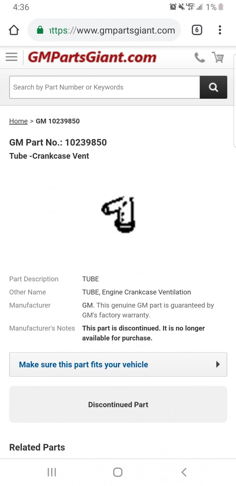

Ok, my searching says the L21 was used in the P12 and the L29 was used in the P30/P32 and was VIN J for 1998. So you're right. Now to find a "book" about that motor!
Going to need a book, because I’ve been searching for hours trying to find that damn vacuum line!

Hey I appreciate it! No diagram around shows what that part is. Matt ended up calling the dealership for me and they found the part. Why it doesn’t show up anywhere else, I have no idea.

Well, I tried to redneck something together, but they didn’t have all of the right parts to do it. So I needed up twisting the hose around til it got a good seat in the valve cover, then used a gear clamp on the intake side. Seems to run ok right now, and it definitely affected the fuel trims. Now it’s time to drive it more and see if they level out

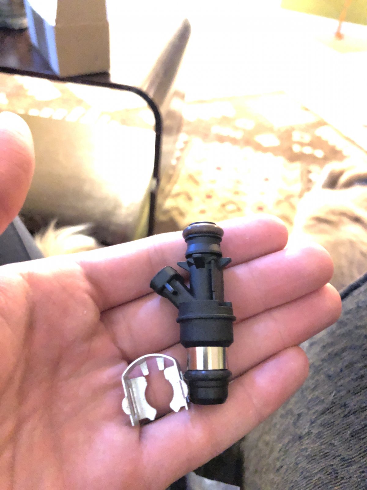

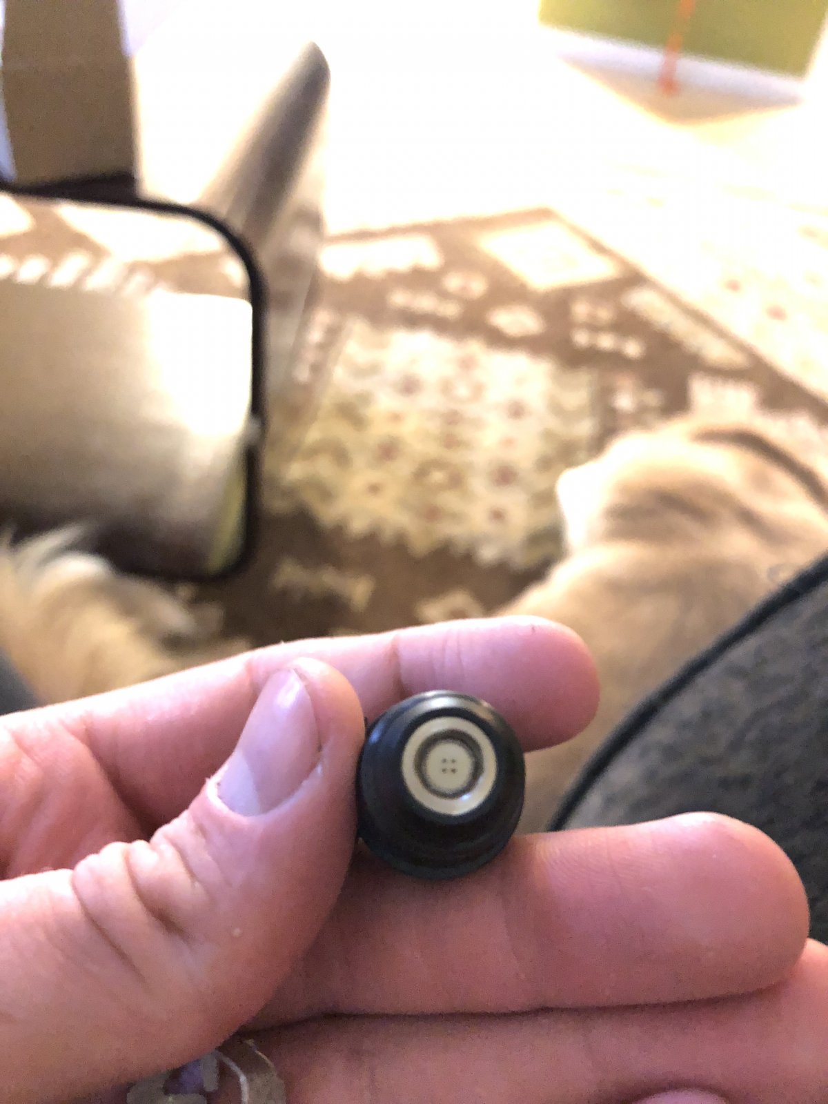

Got some LS injectors on eBay. They aren’t Delphi or Bosch, but they were the only ones that had a consistent amount of good reviews. They are a “Stage 1” upgrade, and are essentially 32lb injectors. I know it will be too much fuel without tuning, but that’s what the 0411PCM swap is for :driver:
