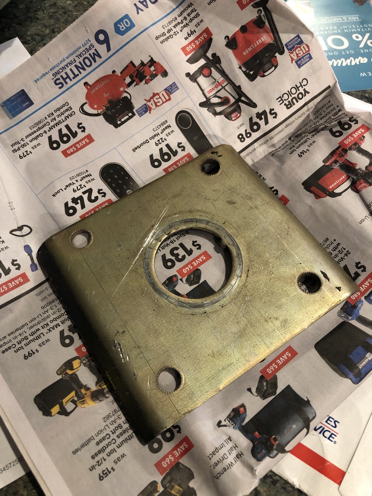

mhmm mhmm mhmm
dont look to bad, i just cut the oddball stud off my hydroboost plate lol. if its ever an issue ill just drill thru the stock hole and nut and bolt it

mhmm mhmm mhmm
Is the stud on yours supposed to keep it from flexing/twisting?

? dunno...that plate looks like my stock vacuum booster plate. the hydroboost plate for mine 3 of the 4 are studs on the plate....the 4th one is not symmetrical
