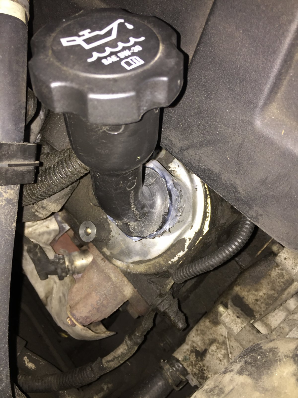

You don’t need to do anything with it, just leave it in. It just twists out if you do want to. And I don’t see how they could leak except maybe right where they twist in. There’s an o ring but you can’t get it separate. You might find one that works though at an auto parts or hardware store.
This weekend I cleaned all the shit off it and it was definitely loose on an angle and the o-ring was sticking out the top. So I cleaned it up and pushed it back in and put silicon adhesive on it just to see of it was the source of one of my leaks. This was after a day of driving, seems nice and dry now. This is only temporary until I can afford new covers and gaskets and filler neck.
45,014
Nice cream pie.
