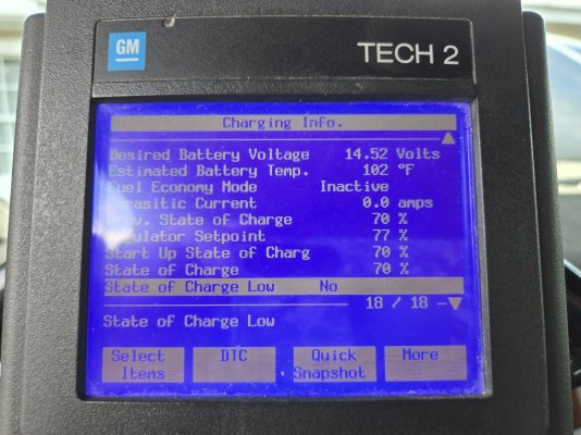

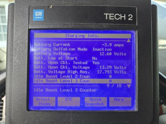

Went outside this afternoon and the battery was at 12.6 volts and 70% state of charge. Cleared all codes again and got the seats working by using the Tech-2 to move them and then the door buttons worked once again. I also finally remembered to replace that fuse for the rear accessory outlet (cigar lighter).
Started and ran fine every time. My son-in-law came over and tested voltage from alternator to battery, checked the resistance on the battery cables and some other things and everything checked out. This new battery might be one of those that doesn't like a full charge. I had one like that that lasted 4 years once. My daughter had one like that lasted about six years and only charged into the mid 70% range the whole time.
First pictures were with the engine off and not having been started since the night before.

Took the family to Steak 'n Shake for dessert last night in Vero, for those patriotic birthday shakes with the little chocolate statue of liberty on top. About an 80 mile or so round trip. The new battery was now taking a charge and the battery temperature was just a few degrees above ambient. Went from 70% to 78%. Smooth sailing.
My son-in-law, Frank, recently bought a 2013 HD2500 Sierra Denali Duramax. This is what my daughter used to try and rescue the Yukon but wound up breaking down as well. The truck had an aftermarket controller for the engine tune, one of those with the dial to change the power level for economy, power, more power, etc. Well, that thing fried when they went to jump the Yukon. It wasn't the low oil that killed it, it was the aftermarket tuner. He pulled that out and the pending codes from before and after went away and he said it runs even better now.
So what did I do wrong? When I got the truck back I put it on the tender and the battery state of charge was 100%. Saw the door ajar code during my first test drive and ordered a new one. We had power to the interior but sometimes hard to start so we ordered a new positive battery cable. Then after those were changed the crank sensor code showed up so we ordered a new one and changed it. Did the bad jump start take out all these things or was it a coincidence? Was everything a false positive with a battery masquerading as good, showing a state of charge of 70%? GM says if a battery won't hold a state of charge after sitting overnight above 65% it's due for replacement.
It probably has an internal short. It's on the tender again and will check it tomorrow with the voltmeter. Then it goes back for the core charge.
Battery usage was pretty much the same in how the truck was driven since we got it.
Thoughts?
