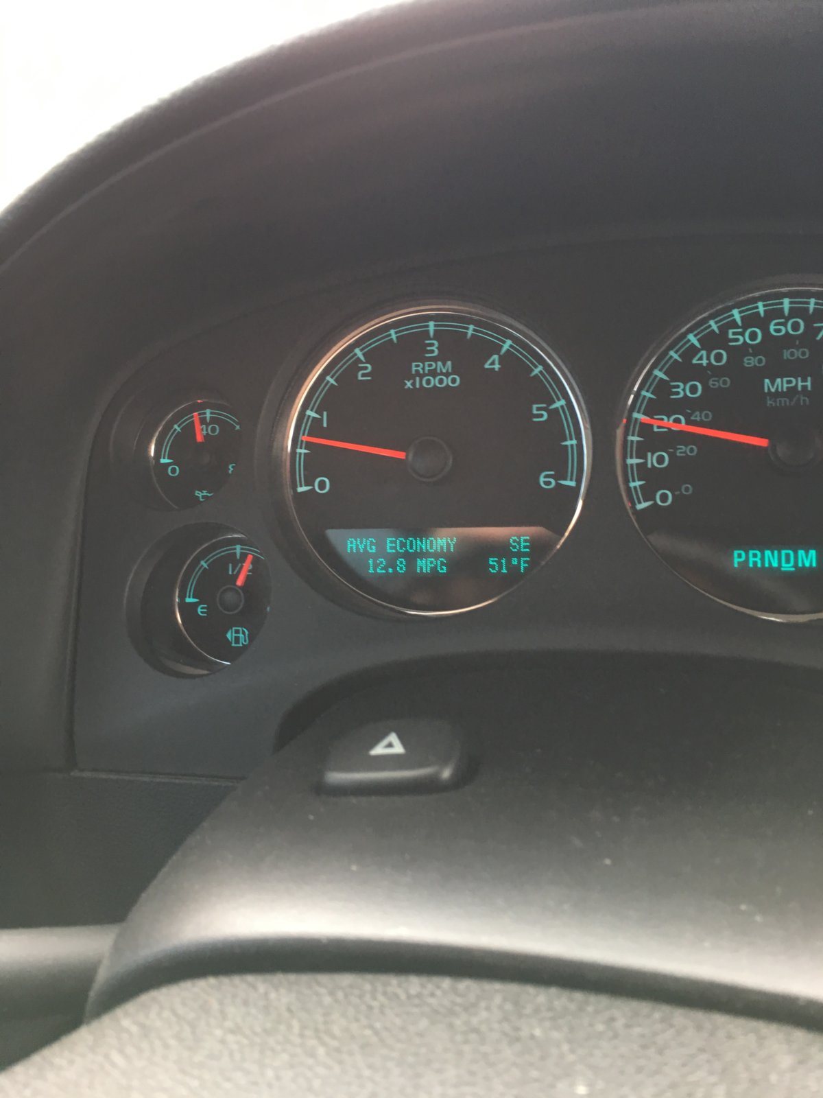

I just went out to rotate tires and change oil and of course.... no filter in my stock.... off to auto parts store. 5 minute drive... lets seeewhat i get it up to

So, i got home from autoparts store and had to go drop my son off at his friends house, pulled into garage after that and was @ 13.5... no pic....but geez, she really puts her foot in it. Well, if it doesn’t last its not my fault....i can only maintain something so much.
