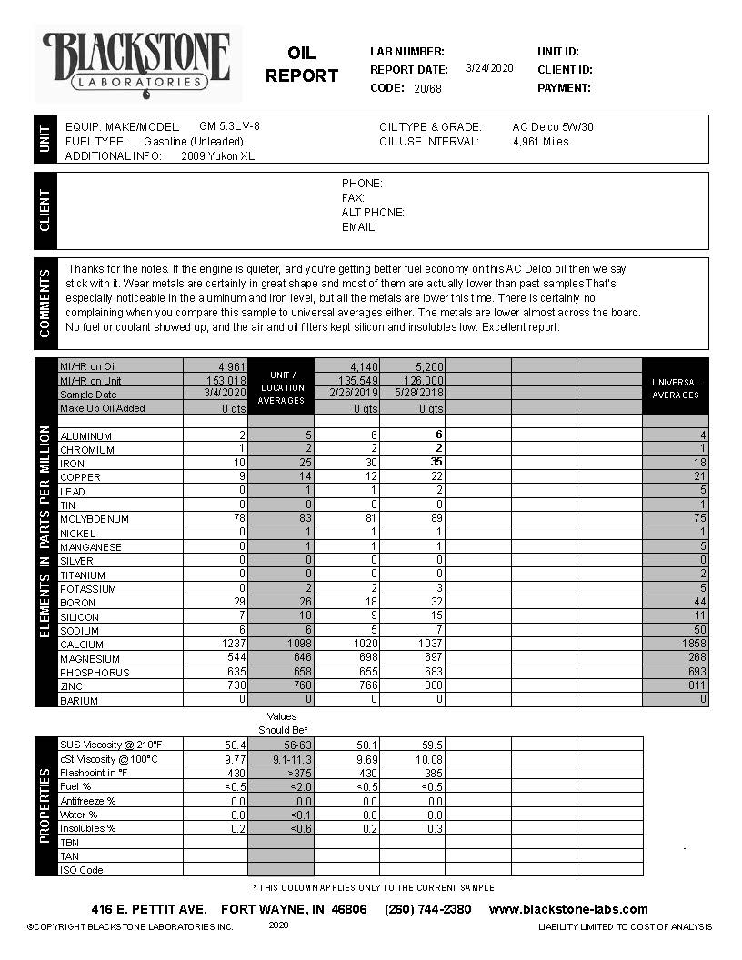

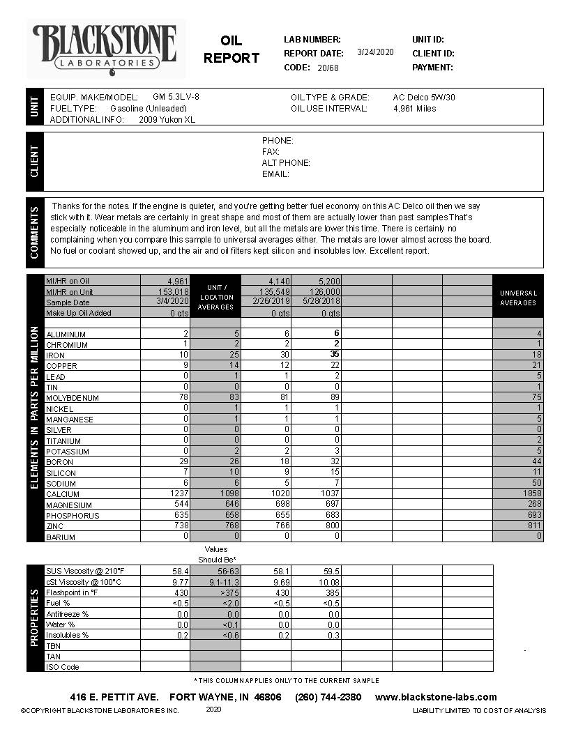

Jealous of this. Your Delco case strengthens. Either that or the Rotella for me next time...
I'll run ACDelco as long as I can easily attain it at a reasonable cost. Then it will be Rotella Gas Truck. As mentioned earlier, the numbers between the two are not that different and better than plain old Mobil One.
