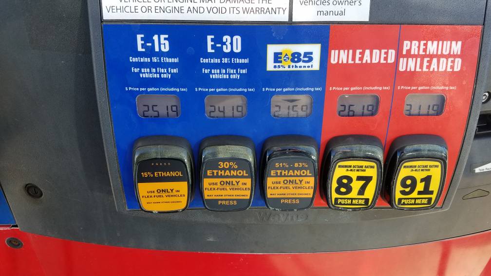

That's kind of what is done in this pic of a pump I took last month in central Missouri.
As E rating goes down, price and mileage goes up, octane and % of ethanol goes down....
Reminds me of the old Sunoco pumps where you could set the dial for your choice of maybe 6 or 7 octane ratings.
I haven't seen those pumps in Colorado; they apparently mix at the pump. I'd be surprised if they had separate underground tanks for each type. I've done what @iamdub suggested and mixed E85 with E10 from time to time, but E85 isn't very convenient for me in the Denver area. The nearest station with it is about 15 miles away and not a direction I usually go. They have only a 250 gallon E85 tank so, when I go, they may have it or not. Not worth a special trip but I'll stop in if I'm in the area.

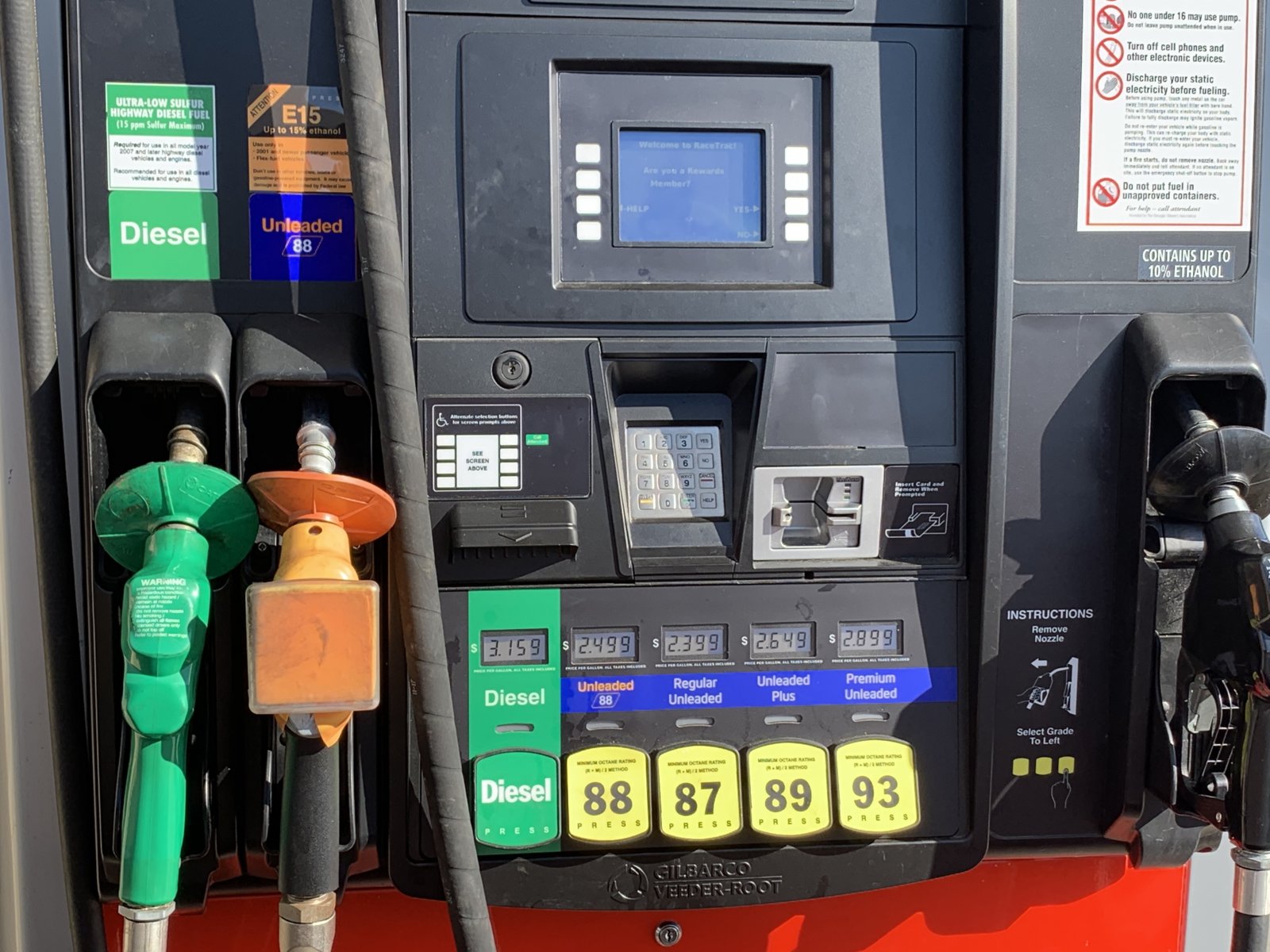

Sorry on the delay but here is a pic of the 88 gas I mentioned. Looks like it is just e85.View attachment 211271
Thanks Thomas, this slipped by me. It's not E85, it's E15 or 88. My local Sunoco and that Marathon/Pro-Energy station labeled it like E85. I thought they also had E30 but was wrong or they don't anymore.
