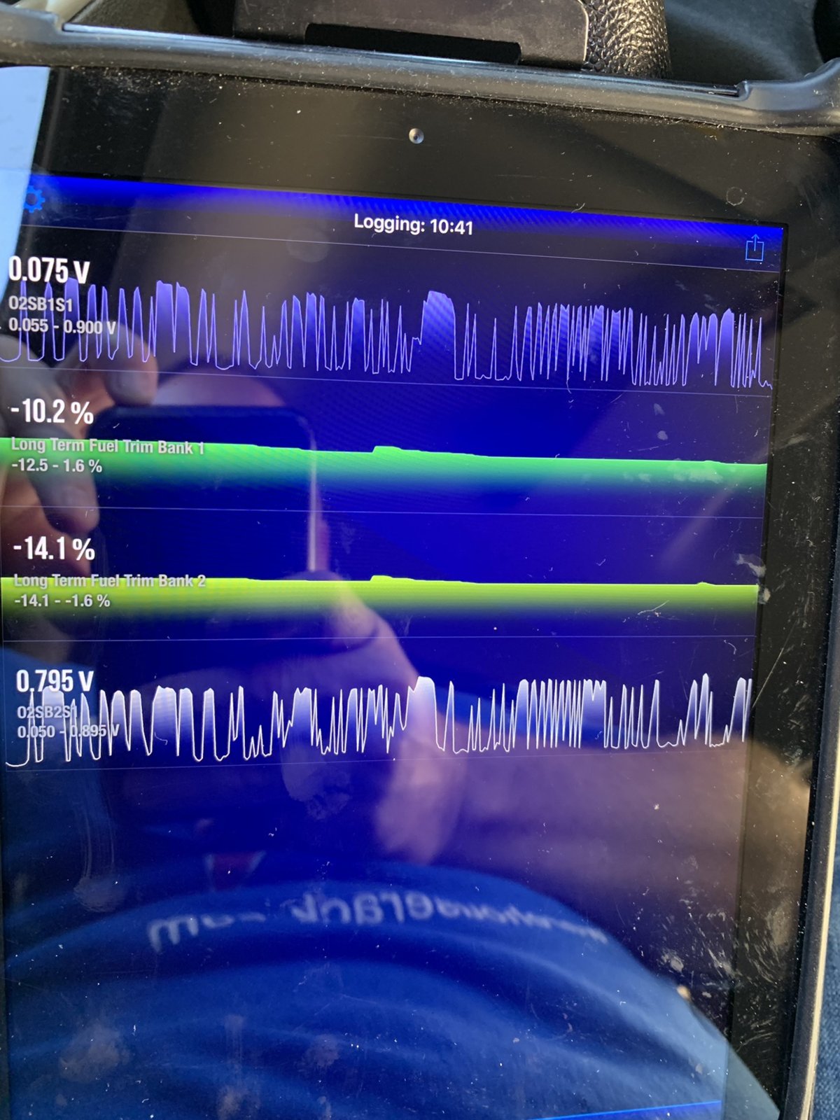

I have the same “misfire/stumble”. Everyone tells me it’s normal. I can’t stand it. I did check my timing with blue driver and it bounces around while all my other cars are steady. Driving me nuts. Have you found any solution?? FYI here’s my data at 2500rpm no load

Your graph looks ok, upstream O2 sensors should be constantly swinging (narrowband).

I have the same “misfire/stumble”. Everyone tells me it’s normal. I can’t stand it. I did check my timing with blue driver and it bounces around while all my other cars are steady. Driving me nuts. Have you found any solution?? FYI here’s my data at 2500rpm no load View attachment 212961
Your sensors look good as Marc says. Check or change your plugs and wires, double check the gap. Bank 2 Fuel Trims are a bit high to me. Check your intake gaskets with a propane torch while watching the O2 sensor graph.
Trims are negative, no? Under load at 2500. What do they look like at idle? What kind of gas is in it?
