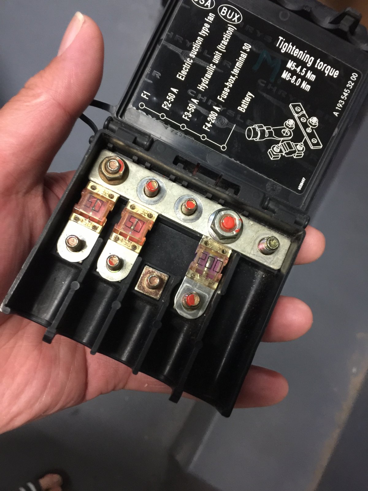

Regarding power wires, planning to use this little box, 1/0 cable might just fit.. (.5" opening)

Regarding power wires, planning to use this little box, 1/0 cable might just fit.. (.5" opening) View attachment 399689
Well, that's cool. There's that fused distribution block we were talking about earlier. lol

The distribution block is a daimler/chrysler product.. smallest/simplest multi fuse holder I could find.
That's the plan.. for now. Thanks for you patience!
It's nifty, for sure. With the fuses in it and wire size capacity, I'd say it's for loads that aren't all pulling at the same time. This is a rare occurrence, anyway.
yeah, the buss bar does look small, but if it can handle a 200A fuse, I should be ok.
