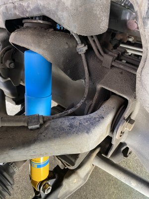

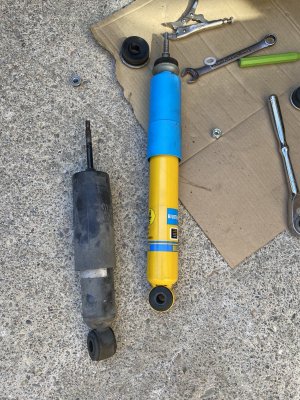

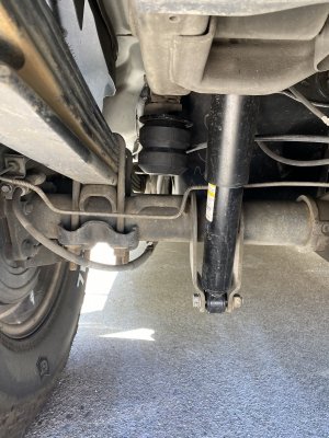

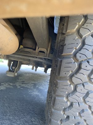

Update 5/2/21
Front shocks were shot - replaced with the Bilstein 4600s, also replaced the first Timbren’s with the replacement pair they sent. So far much better, will dial in WDH next weekend but feel these 2 items will go along way to fixing the issue. Pics for reference - original shocks vs. replacements and the new vs. old Timbrens. Will complete update after getting the WDH set up and giving it a test drive next weekend. Thanks again for all the input. 3B798AD5-5E24-4733-A1B9-46379EFD370A.jpeg17BF5D47-1C0A-4A3E-9287-70308F96AC27.jpeg7680C642-EA59-4C57-99ED-CEEBA79B128E.jpegA3B8EA98-3861-4670-8F49-1B5C5A4ACC7C.jpeg

Update 5/2/21
Front shocks were shot - replaced with the Bilstein 4600s, also replaced the first Timbren’s with the replacement pair they sent. So far much better, will dial in WDH next weekend but feel these 2 items will go along way to fixing the issue. Pics for reference - original shocks vs. replacements and the new vs. old Timbrens. Will complete update after getting the WDH set up and giving it a test drive next weekend. Thanks again for all the input. View attachment 278168View attachment 278169View attachment 278170View attachment 278171
Yeah.....those shocks look totally and literally depressed. That would cause bouncing in the front.
Those Timbren things look cool...very easy to install. Is there a spring rate associated with those?
