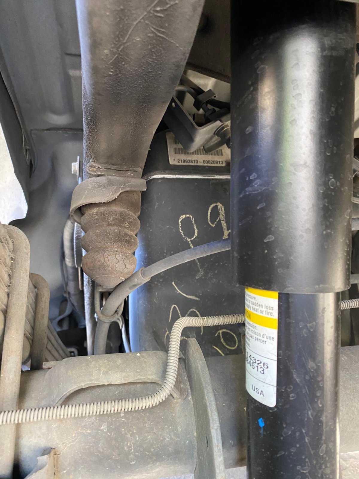

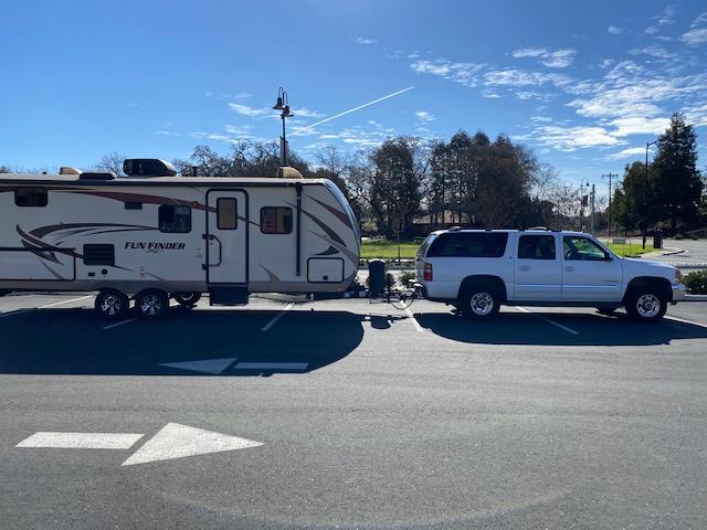

What else could cause this much bounce? Appreciate the feedback. Loaded tow, and rear left shock pics (with old bump stop) below for reference. I don't expect it to feel like our 2012 Denali, but I just can't believe this is the way it should handle.

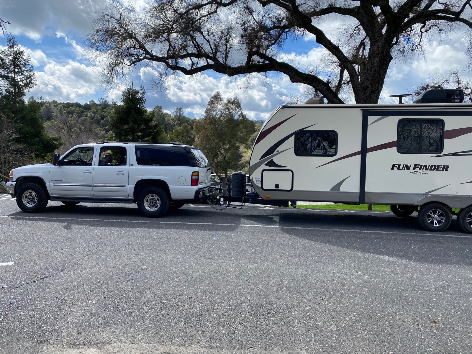

It could be the photo is a little deceiving but it looks like your trailer is a little nose down and the equalizer bars are not level. Try to raise the hitch one notch and ensure the bars are level to the ground when tight. The trailer should also be level to the ground. Do all of that with the trailer just sitting in place on the hitch ball with no load on the truck. Once that is done put the load on the truck and try it.

Usually bounce is more related to springs than shocks. Shocks stop multiples. Have you attenpted to change the trailer loading to increase hitch weight towards maximum? Too much weight aft makes porpoise worse, steering wierd if near limit aft too. I have always preferred about a 20 percent increase in rear spring Rate.

Figure out your tounge weight and overall weight. If your overloaded on the tongue, you need to crank up the bars- more weight shifting by doing this.
If your underloaded thats worse....makes for sway.

I use Bilstein 5100 with reservoirs on my tow rig. Works great with and without the trailer.

Appreciate your input James (and others) - it's been weighed at a scale which I included, 6,420 TT only 13,520 total Gross. Dry tongue weight is listed at 540lbs - and I have the storage in the front loaded with 2 cases of water dead center, and all of our gear so it is easily another 100lbs minimum for a total minimum tongue of 640lbs which is 10% - it's likely even more considering I have two deep cell batteries vs 1 and two 7.5 gal propane tanks up front and also have a 100lb german shepherd in the very back of the Yukon, so it's likely closer to 800lbs or 12%. Don't have much extra stored in the back/middle of the trailer to add weight there.
This is the 3rd Yukon XL I've used to tow this trailer and never had a bounce issue - granted the previous 2 were 1/2 tons but still I'd be surprised if it was just how the WDH is set up or how it's loaded - and as I mentioned I have already moved the shank up and down and adjusted my chain links to several different positions with no change in ride quality. It also rides rough empty with bounce over bumps (but no porpoising without the TT).
I contacted Timbren and they are sending shorter helper springs because the current almost touch when unloaded. I'll also replace my front shocks with the Bilstein 4600s (standard height) when I install those. I'll report back after that but was after any other possible causes which haven't been offered.
different photo

My WDH says you measure the height of the rear bumper unhitched but the truck loaded and then hitch up and measure the height again. Adjust the chains on the WDH bars until the bumper height is back to the previous measurement.
But it sounds like you've done similar and are still getting the same result, so you working on your suspension seems to be the solution.
