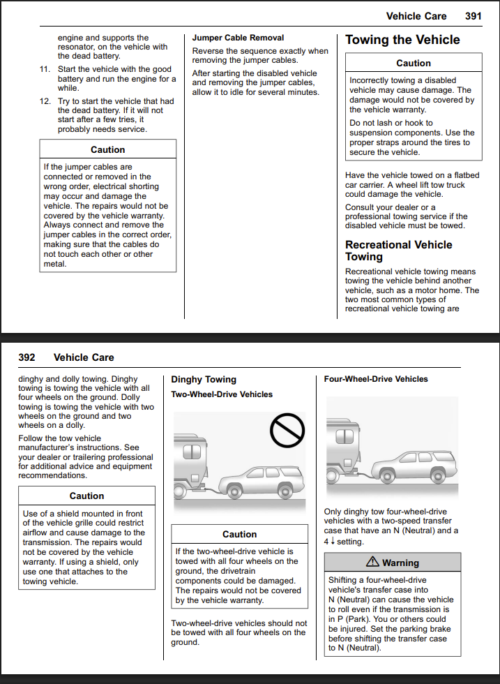

Question for the group:
I own a 2016 Tahoe LTZ 4X4 that just switches from 2 to 4 wheel drive, no 2Low Neutral or 4 High. I would like to tow it behind my motorhome. I know I can't flat tow it but can it be dolly towed with the front wheels down, rear on the dolly?
Thanks in advance:
Doug V.

Doesn't your Owner's Manual explain what can and can't be done? Here are the first two pages, but be sure to look in the manual for the rest.
2016 Tahoe Owner's Manual

Thanks for getting back, I saw that in the manual but just wanted to be sure. Even called the dealership and the service techs could not answer 100% if it could be. So I am just trying to find out more info.
