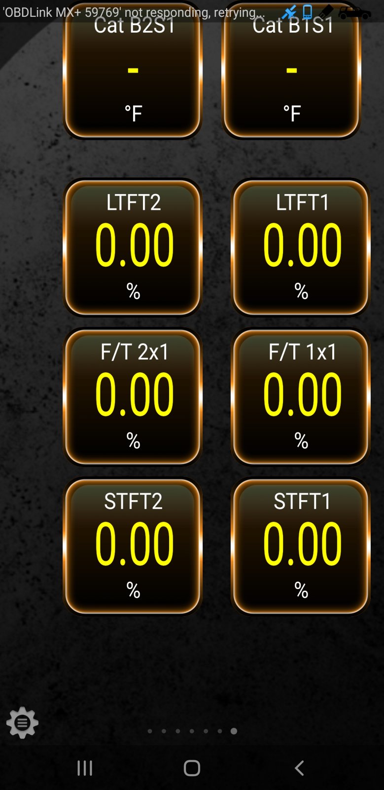

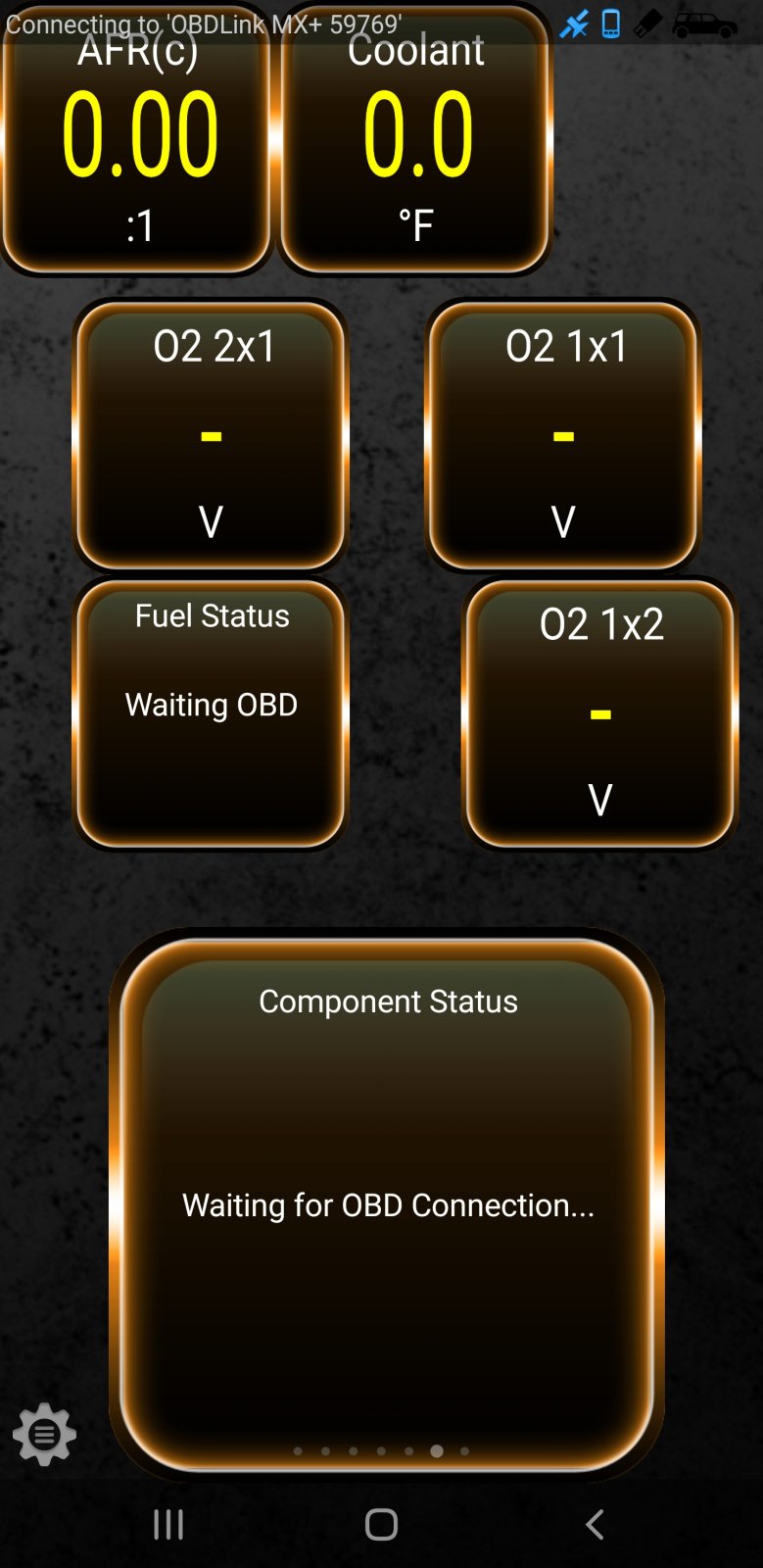

You want your Long term fuel trims to be as close to 0% as posible but no more than 10% +/-. Check bank 2 o2 sensor voltage maybe.
I use torque pro and recently checking a similar issue on my old e450 ford rv
