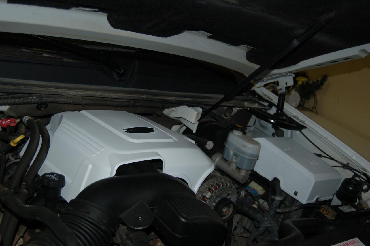

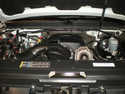

Well here's what has worked to this point. I tried a number of things on some scrap pieces of plastic (I had some spray bomb lids laying a round) and tried a few test pieces with that. The paint I used was the same as the other post, Krylon Fusion for Plastic, and I used TPS Heavy duty cleaner/degreaser paint prep wash, and cleaned it with that and then rinsed with water as per the instructions and then let it air dry. I then went with very thin coats and added a coat every 5 minutes or so until it was nice and white. I did not add a clear coat as I wasn't sure how that would stand up with the Krylon plastic paint as far as compatibility. I will have a couple of before and after pics. I'm still not done as I would like to highlight the Vortec symbol (I taped it off so the relief would stay black) and do the intake pipe and air cleaner housing as well.
Fauxnali
Fauxnali
Gold Member
Mar 7, 2010
164
Edmonton Alberta Canada
Here's some pics before and after the intake and fuse box cover were painted.

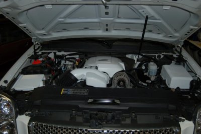

Her's the final product with the air-box and the piping done. I left the mass air and the rubber flex hose alone.
