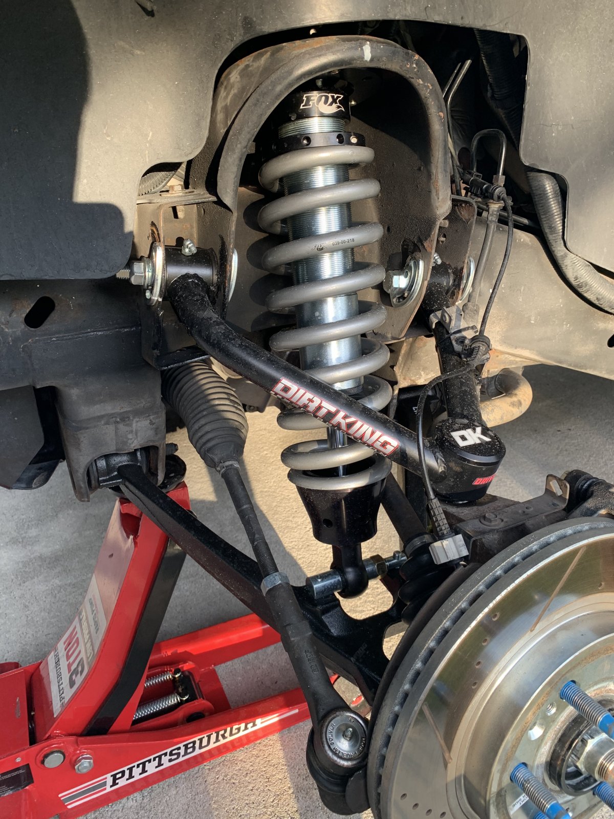

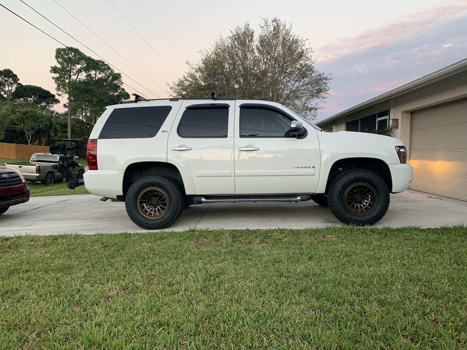

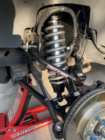

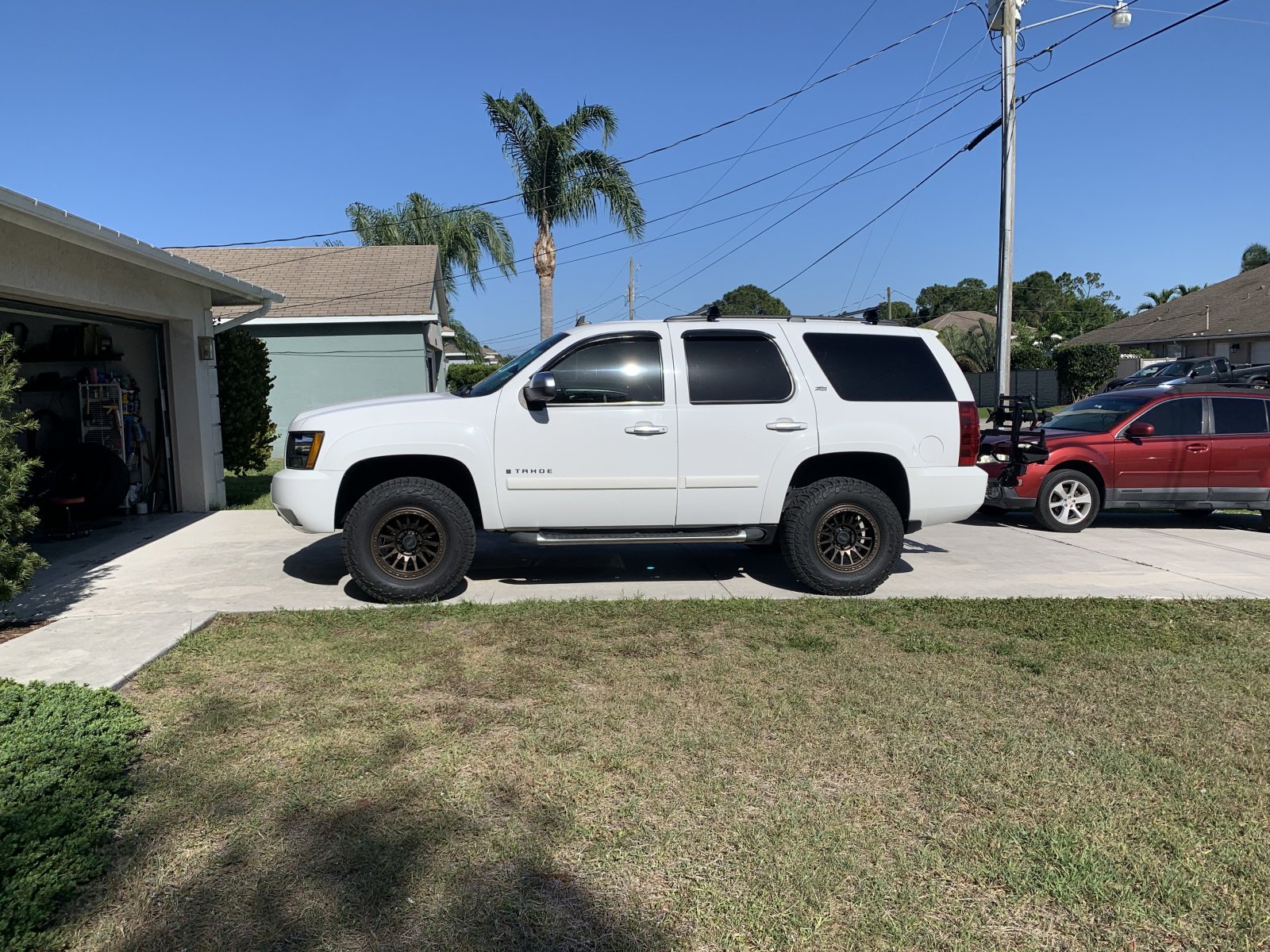

I’m huge fan of RRW wheels. I have the I have the RR7-H in bronze with 0” offset. They sit just right for me and don’t poke out like some of the other wheels out there. Maybe an inch plus or minus in the front and less in the rear.
I also am running dirt king UCA’s with Fox 2.5 adjustable coil overs on stock spindles. Falken wildpeak at3 285/70/17 E rated tires. Also the wheels can be ran as bead lock if desired or run a protective ring.
