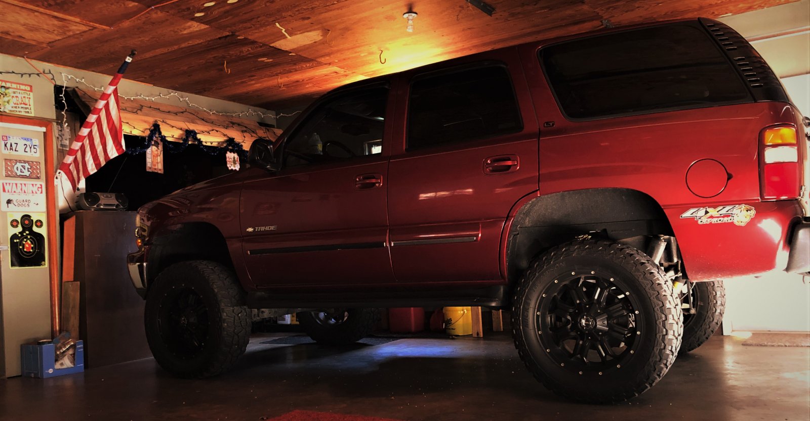

My does....barely....very close....6" rough Country lift....35" Mickey Thompson MTZ

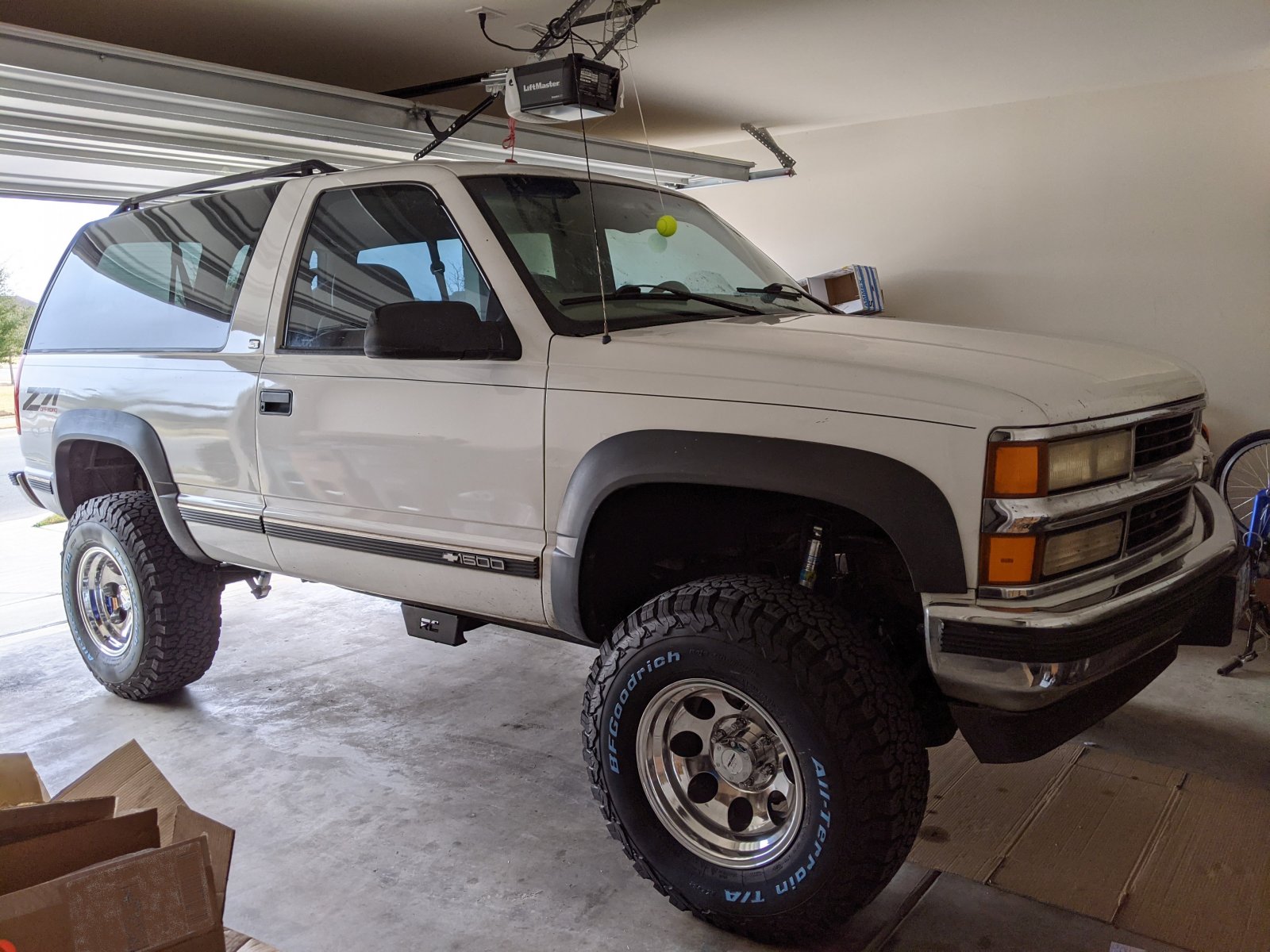

Here it is in the garage. I still have a few inches of clearance but I'm glad I went with the 4" lift. If I'd went with the 6" lift I'm still not sure if it would have fit, and if it had it would have been SUPER close.

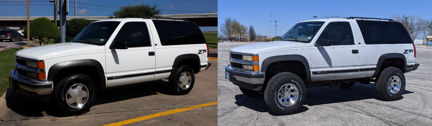

Here's a pic of what it looked like stock on 245/75r16's vs after the 4" lift on 285/75/r16s.
