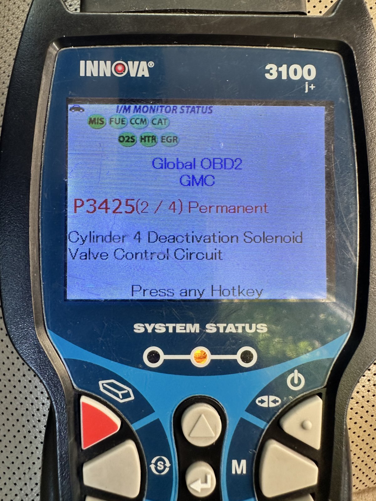

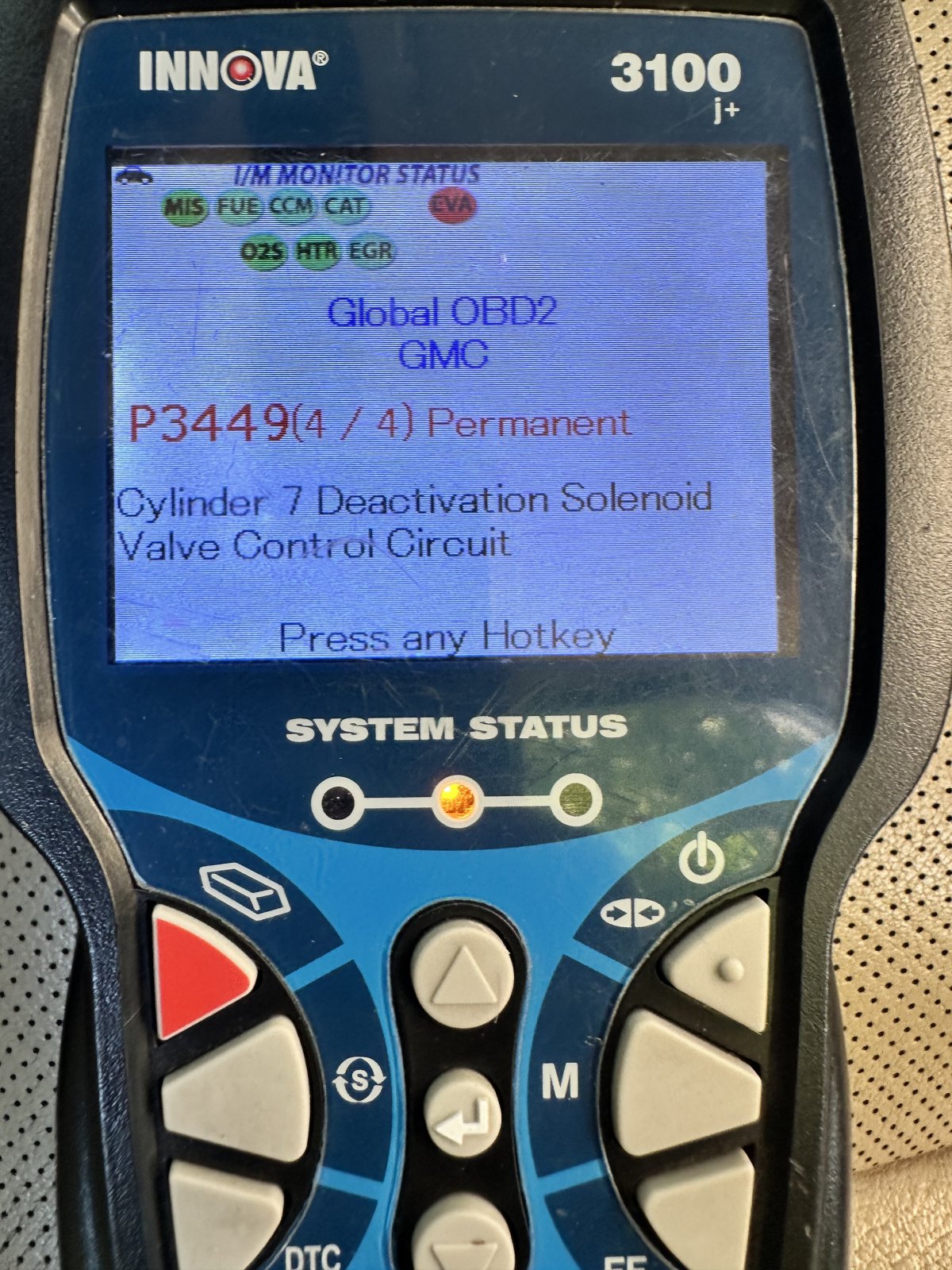

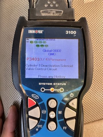

Yeah, they are all cleared now even the evap, but i have the permanent codes from the cylinders that used to be used for the AFM/DOD.
So i was thinking of removing the ls2 valley cover i plaved and reinstall the AFM VLOM to hopefully trick the computer its still plugged in to AFM.
What are the specific permanent codes?
Its the codes for the selenoind on top of the VLOM.

2 ways to deactivate afm in hptuners. you just changed the drop down box from what it currently is, to the other thing. sometimes they arw labeled wrong, so just change it. disregard enable and disable text. and you can also move the activation temp to max temp, you engine will never see it and never try to activate.
most to both, I only did the drop. down box on mine. no permanent code and all i/m monitors passed.
j91z28d1
Feb 28, 2022
4,655
5,900
Oh yeah, if you haven't. go under diagnostic codes section, find all 4 of those codes, and change the drop down box to "no error reported" save and reflash.
it can take up to 25 key cycles for a permanent code to go away.

I'm on a Gen 3 so my knowledge there (DOD) is non-existent. @Fless 's suggestion to check HPtuners to see if that can be dialed out is a good one.
I went back and removed the 4 codes from the list. Flashing the pcm obviously all the diagnosis went back to missing but they went green except for the evap now and the permanent codes are still there. So got tonkeep driving. Might need about 100 more miles and and a few more start ups to clear them finally
