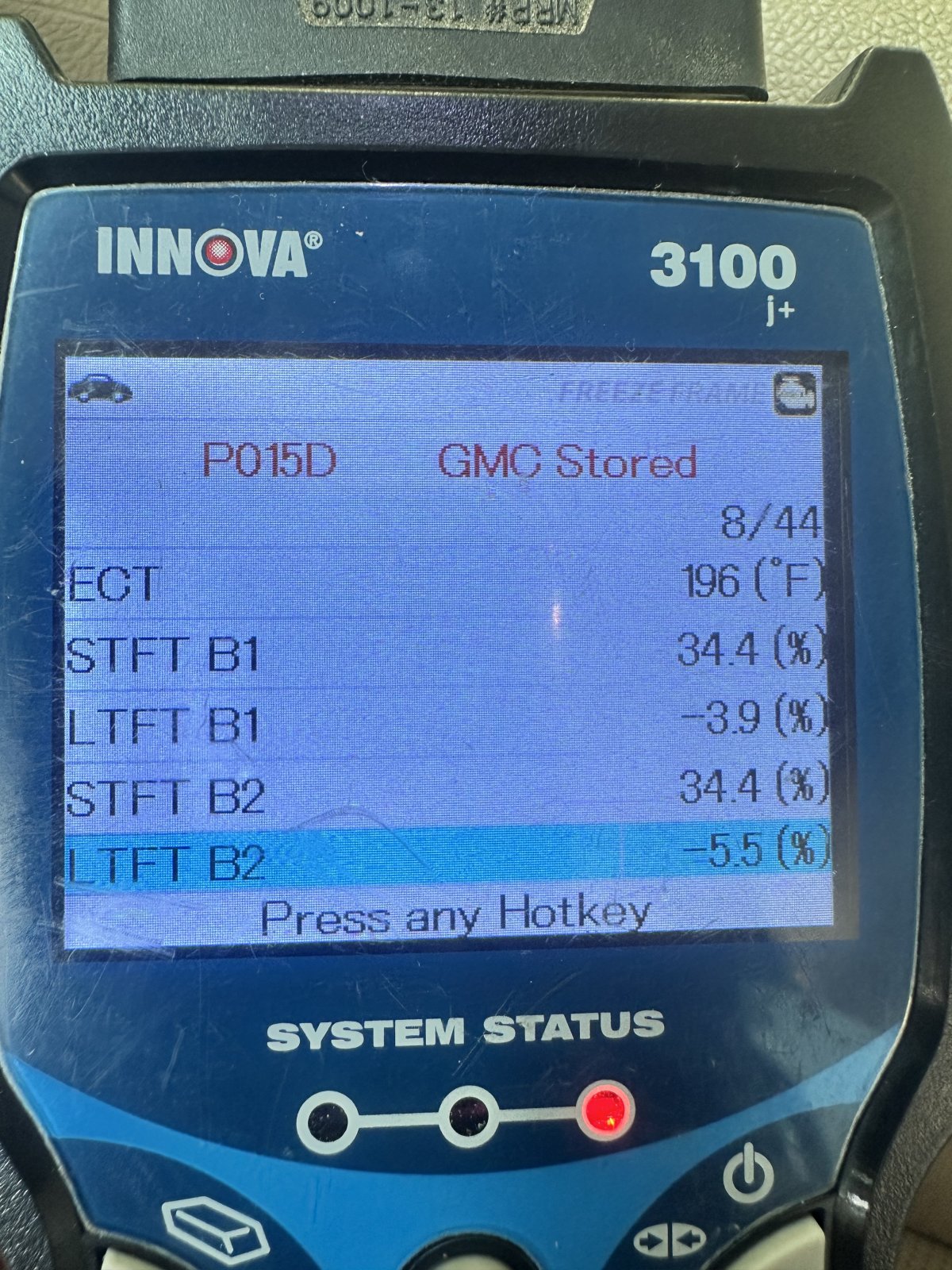

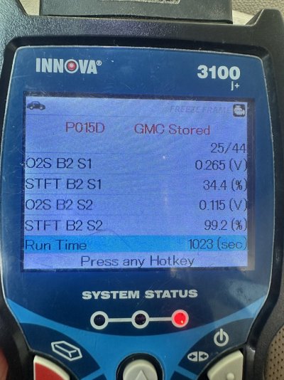

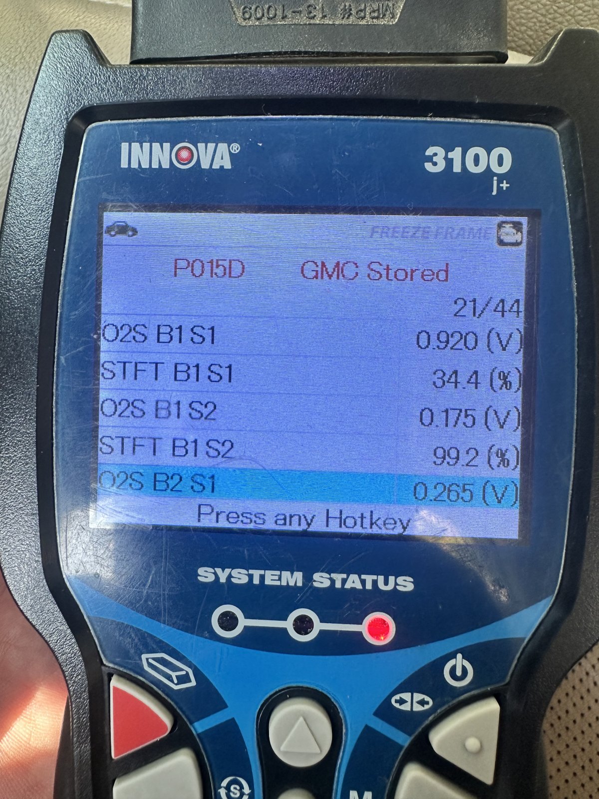

good morning, ladies and gents.
I am having an issue and I was hoping to get some wonderful feedback from you.
After I rebuilt my engine, I am having an issue with my cat on bank one. Can’t clear the code. I swapped out the O2 sensors for a brand new OEM‘s problem still consisted..
So before I went on vacation, ordered the O2 exhaust extenders hoping that this would help me. I installed the extenders on Pre and post cat, i drove to clear codes and now I have a P015D code. my scanner gave me a some freeze frame info and the voltage on bank one Pre cat. The voltage is way off compared to the others. This is the brand new sensor mind you.
So my question is, should I remove the extender on the pre o2 cat cause maybe the culprit was the post o2 yeah cat?
I will eventually change the catalytic converter, but I wanna be able to have the next two years to save up the money for it since these cats on a 13 GMC Denali are $5000
I will post the pictures from the data. See what you guys tell me. My other issue is my OBD two reader shows 44 PSI the car supposedly at the time of the freeze frame was going 44 miles an hour so it just seems like a lot of low pressure. I also know that that low fuel pressure on rare occasions can activate an O2 issue.
thank you for your time. Hopefully someone would be able to help.

I don't believe the o2 extenders are for the pre cat, they are more ment to slow down the rear o2 signal so the ecm thinks the cat is. working.
on another note, I. agree your trims are all out of wack. by rebuilt engine, can you give some. details? did you put a aftermarket cam in it? any possible exhaust leaks at the exhaust manifolds?

BOTH banks are calling for LOTS of fuel to be added (lean condition).
Are you sure that the intake tube is sealed properly, and that no unmetered air is getting in before the throttle body? What is the MAF reporting at hot idle, in g/sec?
Any exhaust leaks?
Ill check
