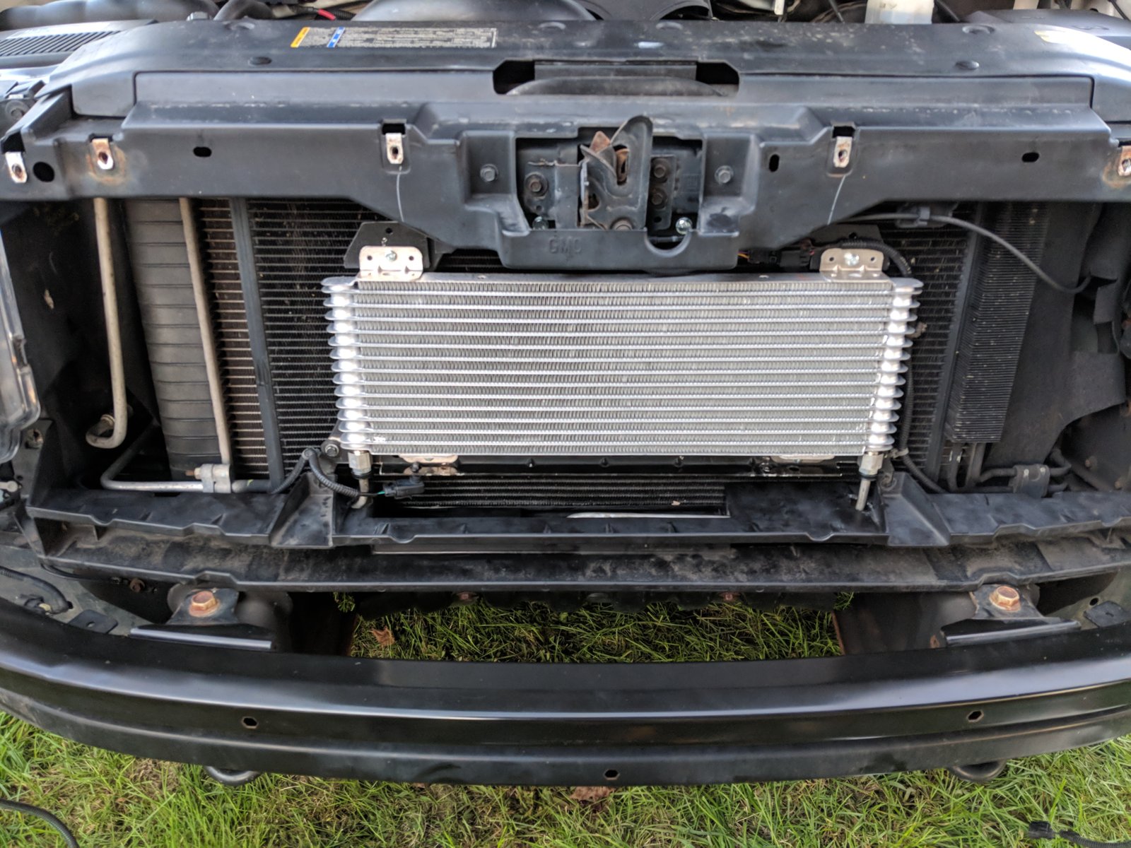

well if a hose clamp worked for decades and decades then it will still work today, there is not that much pressure in a transmission to ever worry about it, I used the fittings and clamps and brackets that are supplied with the kit and I doubt I will ever have to even bat an eye at it. the only thing I added that didn't come with the true cool was (4) 1" stand offs because otherwise it would sit flush metal to metal. you will want to move your ambient temp sensor to the side otherwise it's going to tell you it's 120+DEG outside
**edit on the nbs you might not have to move the temp sensor I think it is lower on the frame than it is on the nnbs, but just something to keep in mind

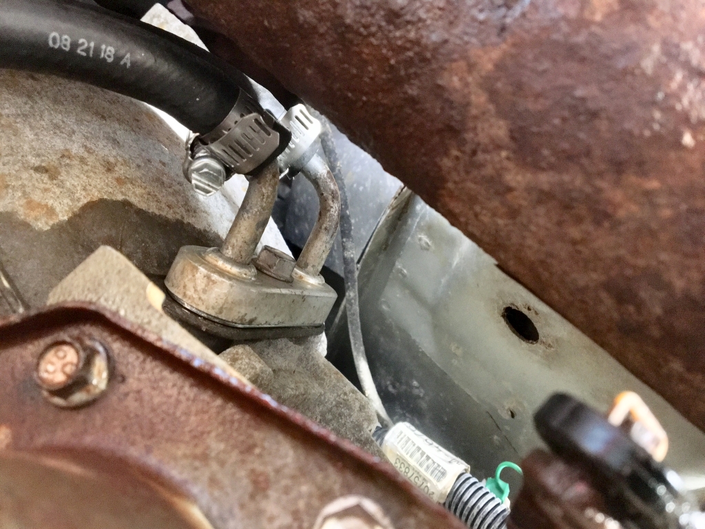

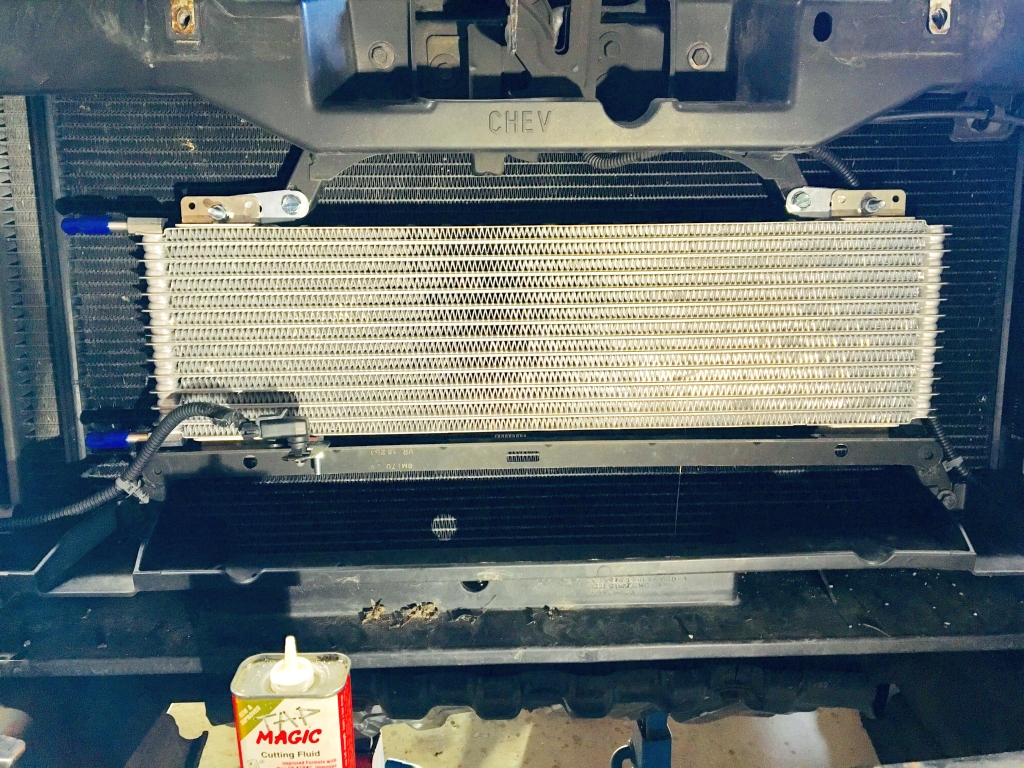

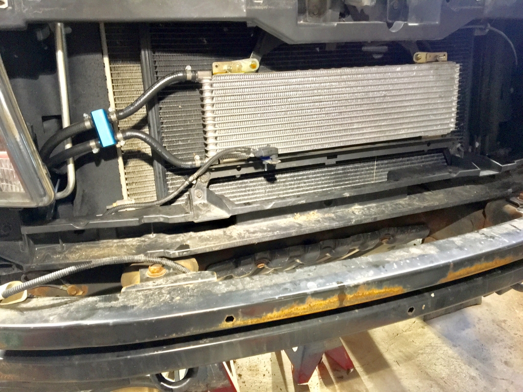

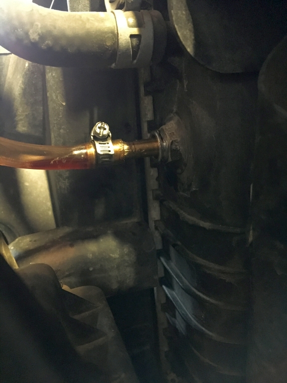

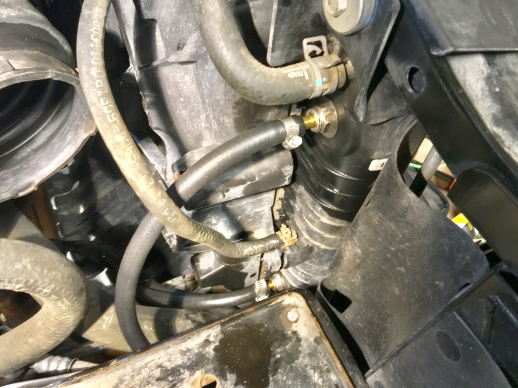

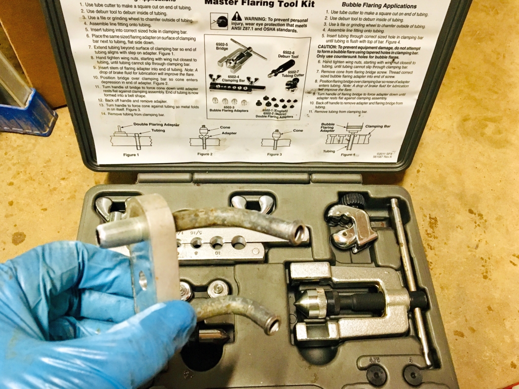

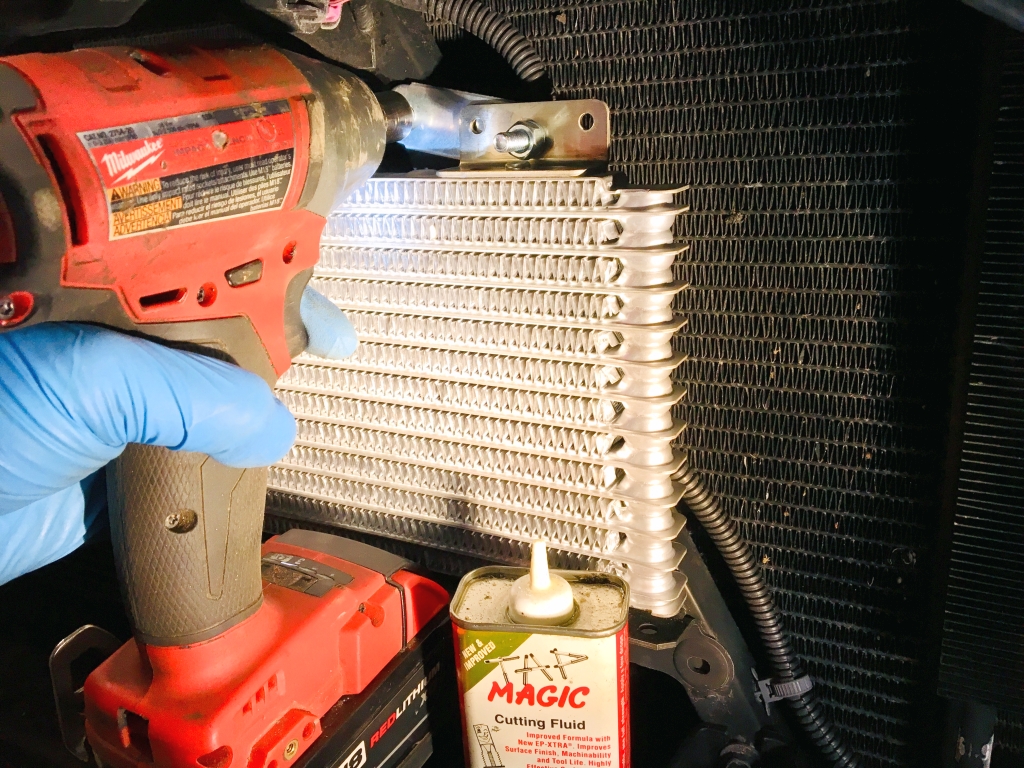

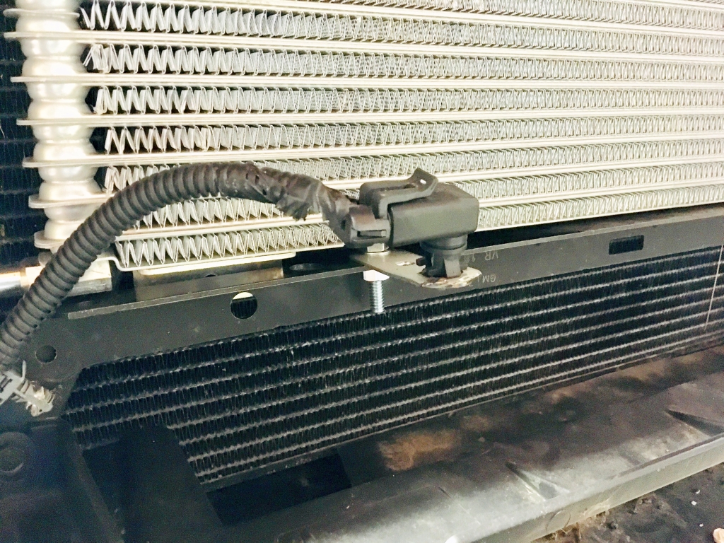

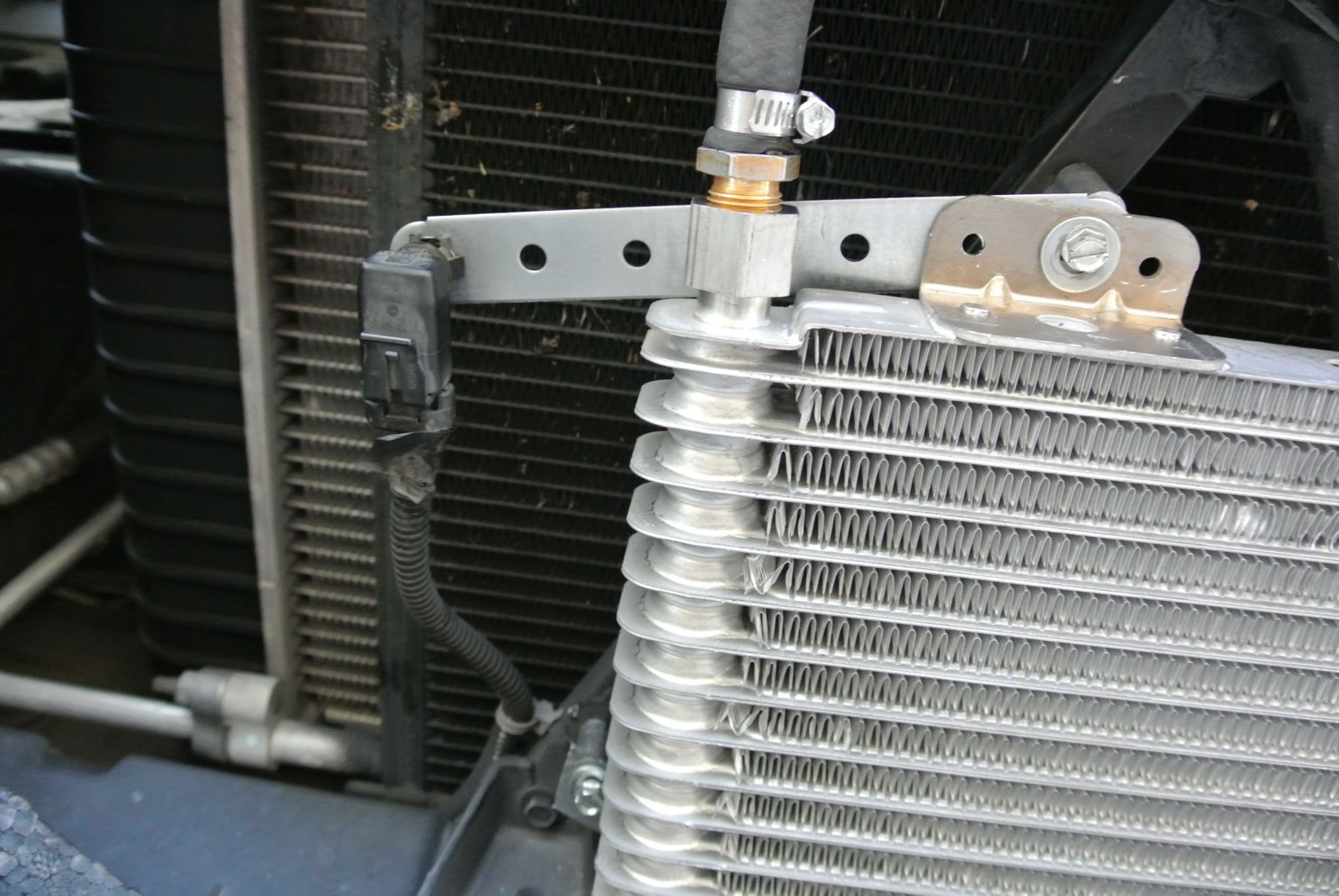

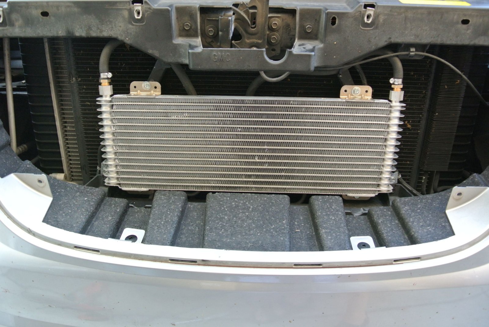

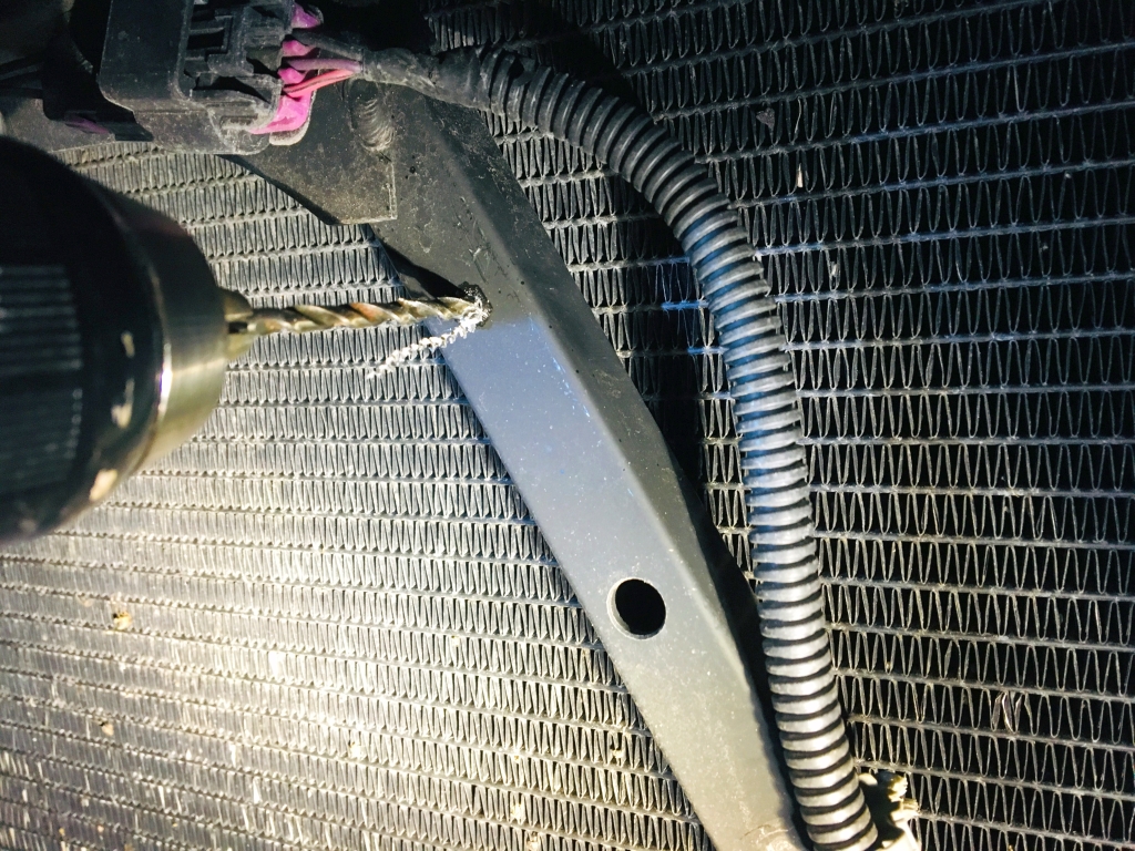

I planned this project out so I could hit many birds with one stone. The driving factor was the fact that my transmission cooler lines were rusted very bad. I read how it is a real pain in the *** to install the OEM tubes so I opted to replace everything with new high-temperature rated rubber hose. I also pulled the pan and replaced the filter.
This took me about four hours total. I removed the front bumper-grille assembly which only really takes about five minutes. The Tru-Cool kit comes with mounting hardware which you can see in the photos. I used my Milwaukee M18 cutoff wheel tool to trim the strapping style brackets to size. I drilled a couple pilot holes for the metal screw to fasten the bracket to the A-framing in front of the radiator. Note how I moved the temperature sensor forward using a piece of the bracket material.
Note how I reused the tubing manifold that attaches to the transmission. Unfortunately the billet adapter plate I bought is quite high and when I test fit it with the Russell -6 AN 45 degree fittings it was extremely close to the front driveshaft. Like millimeters. So I decided to dig the factory manifold out of the trash and flared out the ends and stuffed on the Derale 3/8 rubber hose with stainless clamps. It is quite possible that this would work with 90 degree -6 AN hose fittings and a shorter AN manifold (I have seen these on eBay).
Dropping the pan was interesting. I'm thankful I watched the correct YouTube video today that gave me some sage advice I haven't read/watched yet: use a pry bar on a jack to pry the exhaust down toward the ground thus creating a small enough gap to pull the pan.
Word of advice about the Wix 58369 filter kit: it comes with the WRONG gasket. I was pissed as my local parts stores didn't have the proper gasket in stock so I had to use the original 10-year old one, that had cracked rubber, with some RTV. Mine needed a ATP JG-140 which also is AC Delco #24224781. The angled corner is "softer" whereas the wrong design has a perfect 45 degree angle.

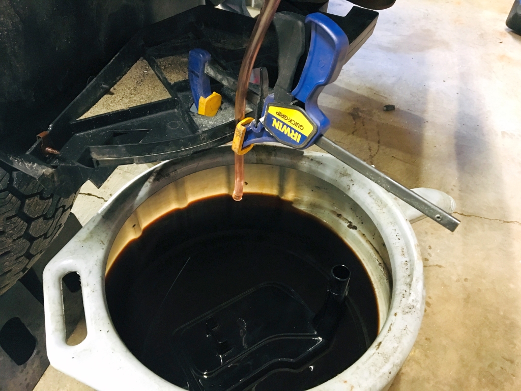

You can see in the photos that I used a Hayden 397 brass adapter that has the GM swage end and a barb end on the other side. I use clear vinyl hose and secure it so it'll pump the fluid into a container. After I install the new filter, gasket, and cleaned pan I refilled the transmission with about six quarts of genuine GM Dexron VI (I bought the gallon jugs of it from Tasca Parts for $14.36/gallon). I started the engine and let the pump dump out several quarts of nasty dark fluid. While the engine runs I fill the transmission through the dipstick tube while it continue to pumps out. You can take a short break to check for fluid color change - it is very obvious when the fresh stuff starts to pump out as its cherry red. Shut the motor off. At this point I began the new hose installation.
