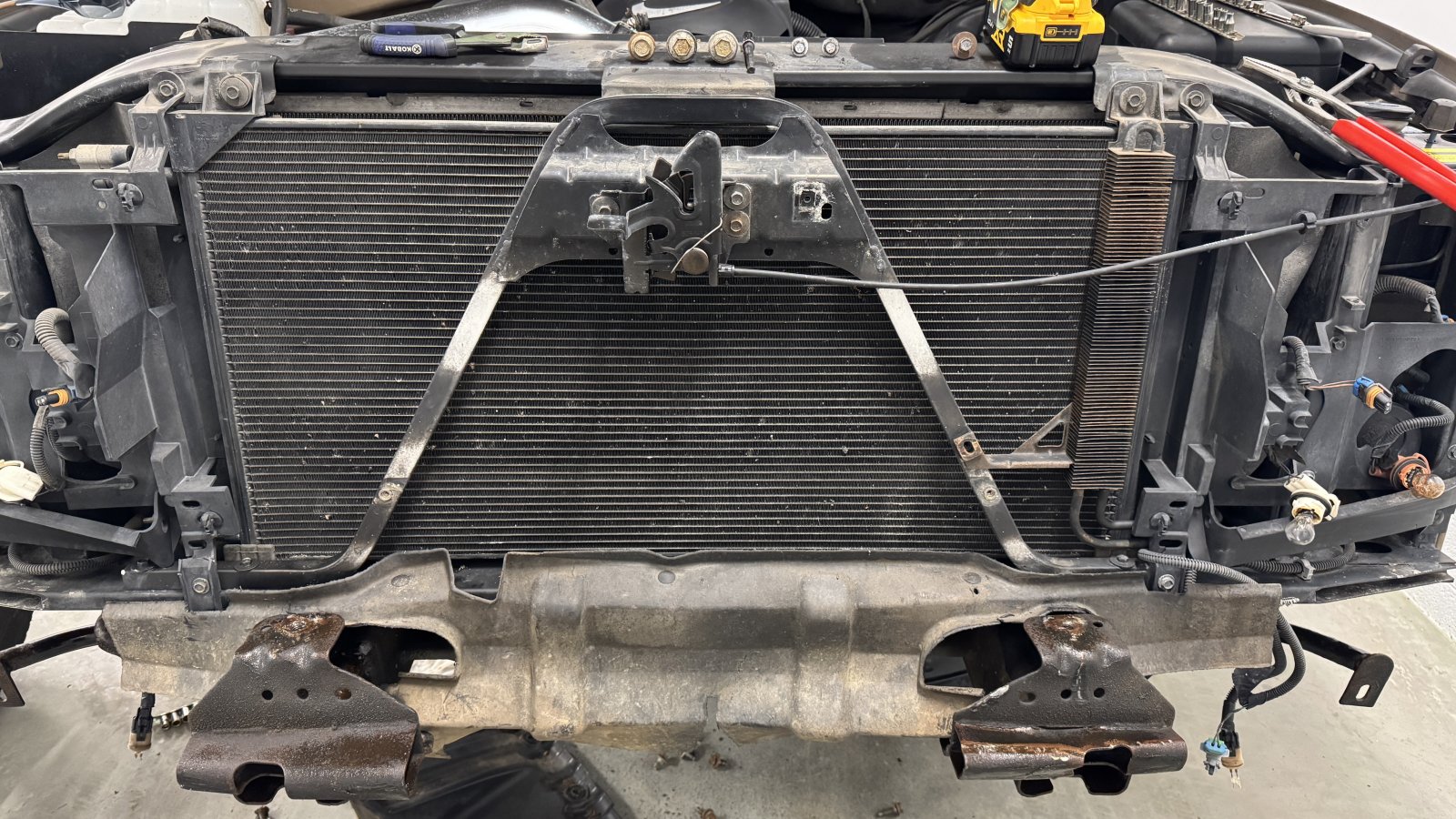

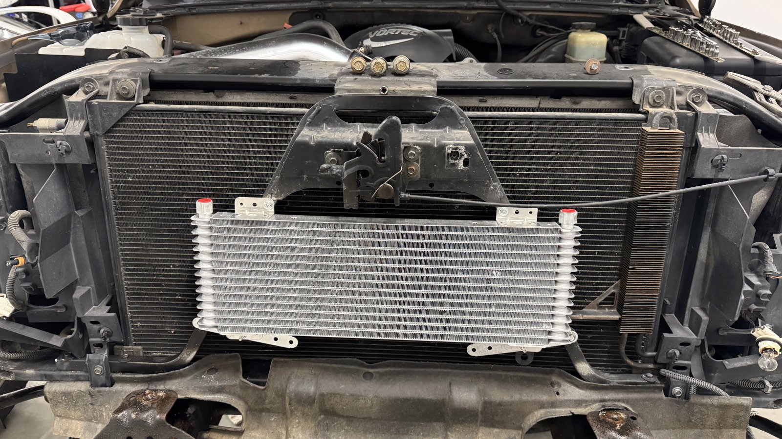

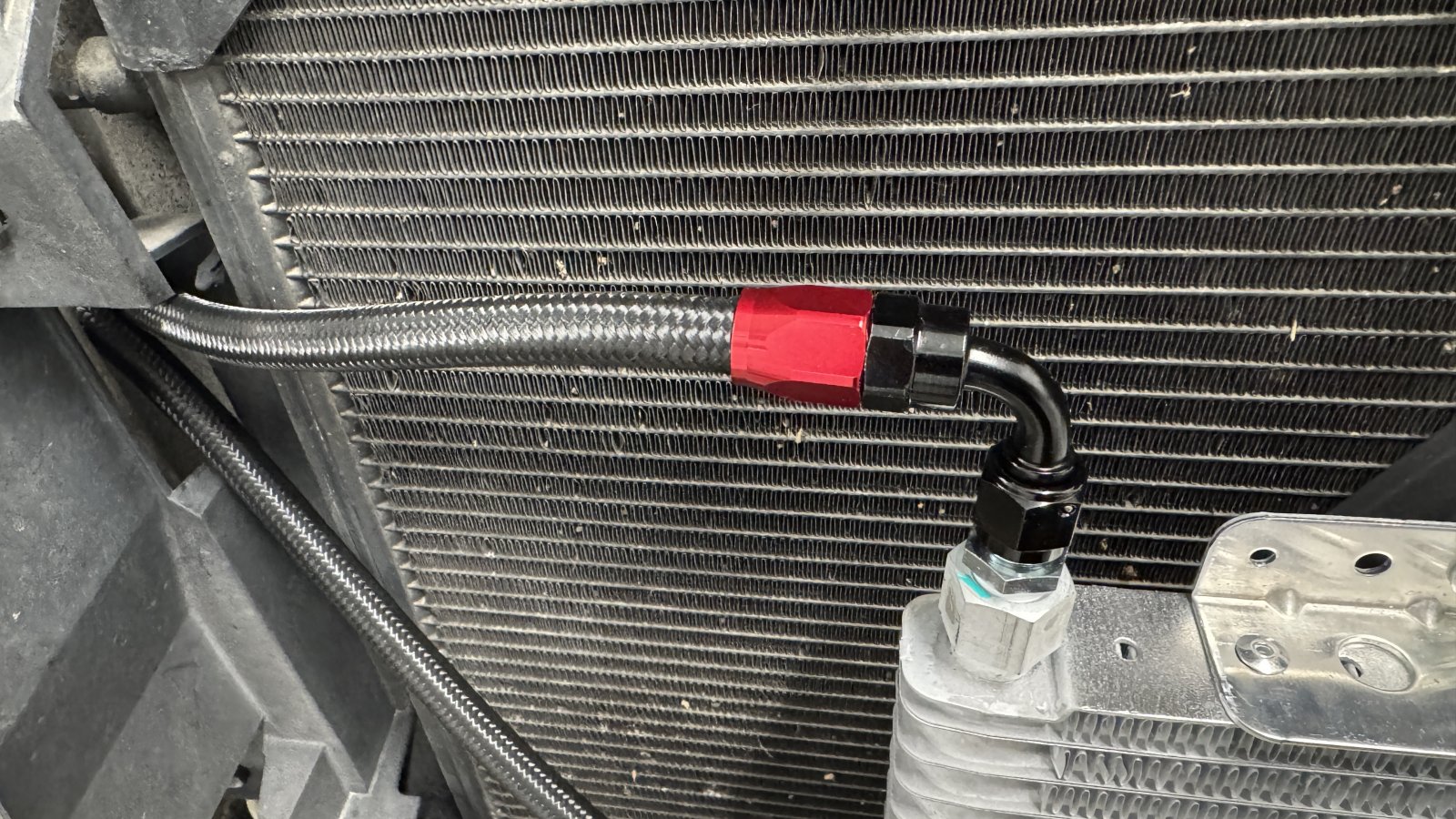

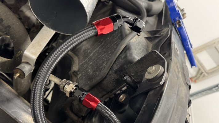

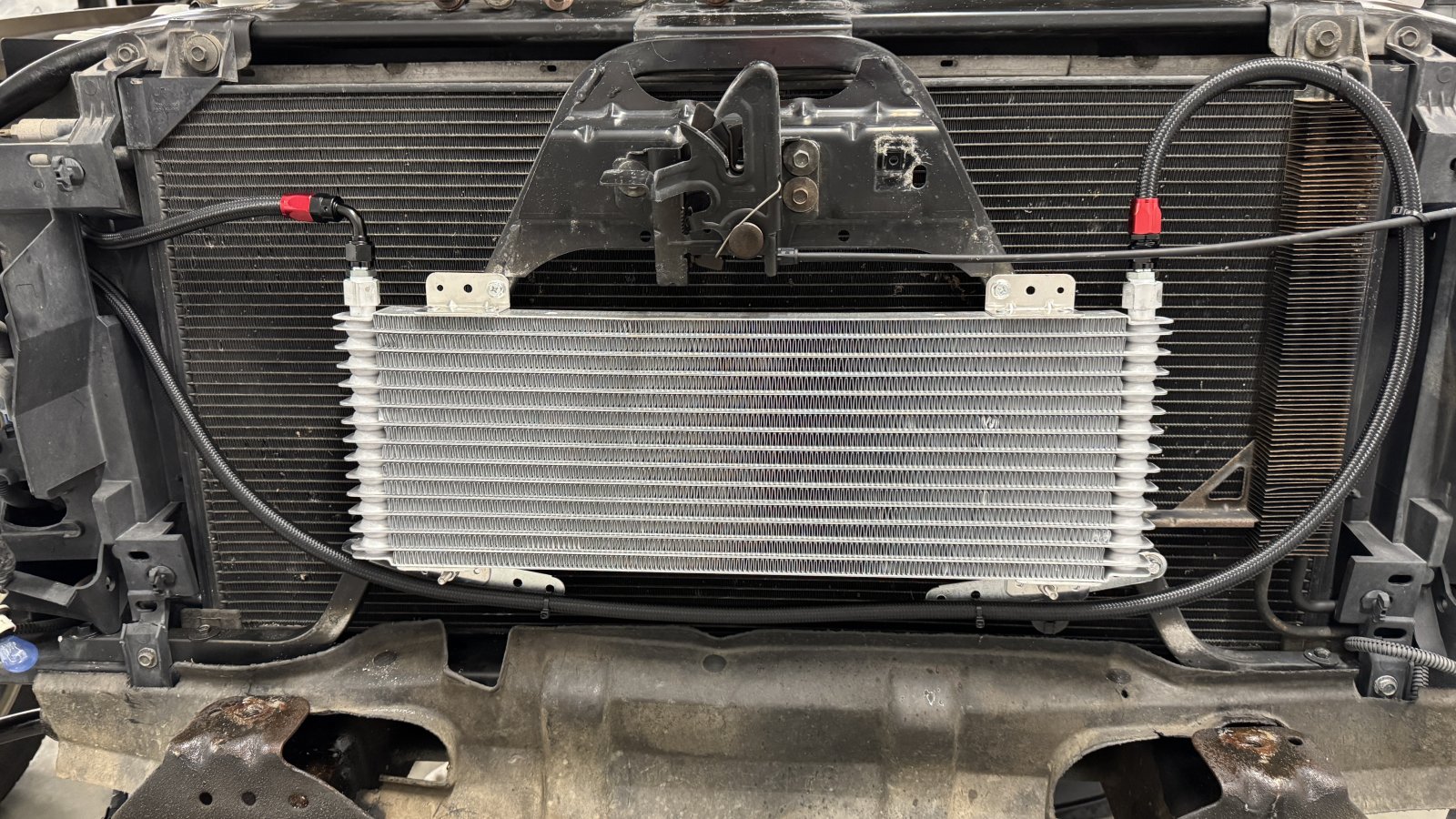

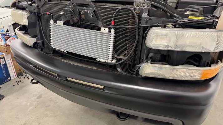

Sorry it took me so long to update you all but I did finish up this weekend with the TruCool install as well as the front-end body work. The 6-AN 5/8-18 fitting worked perfectly into the radiator and the AN tubing kit I got was much easier to work with than expected so I opted to just go ahead and use it and make my own lines. I am very happy with how it all turned out and even happier there were no leaks! Thanks for all the help guys, I love this forum.
