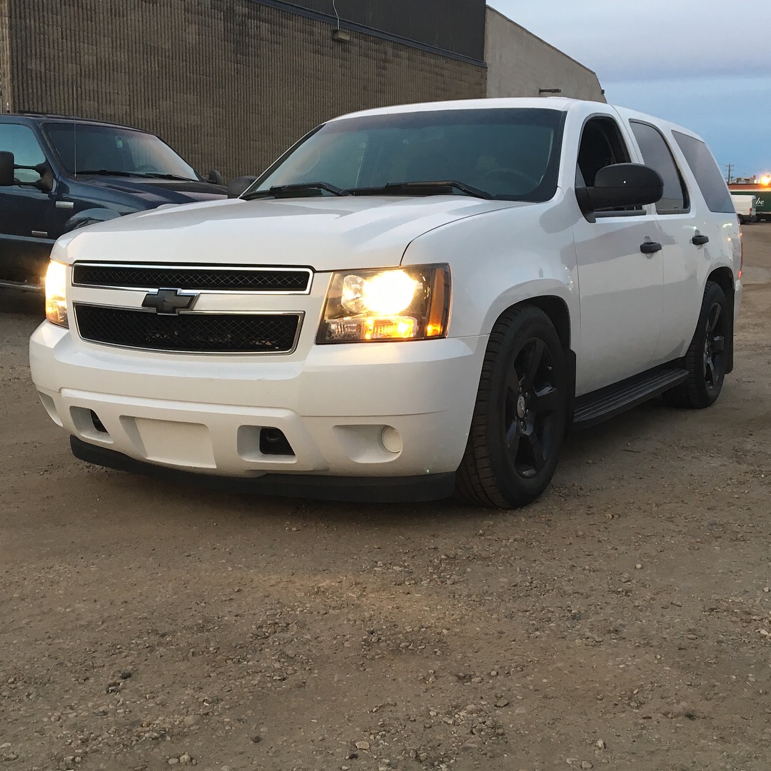

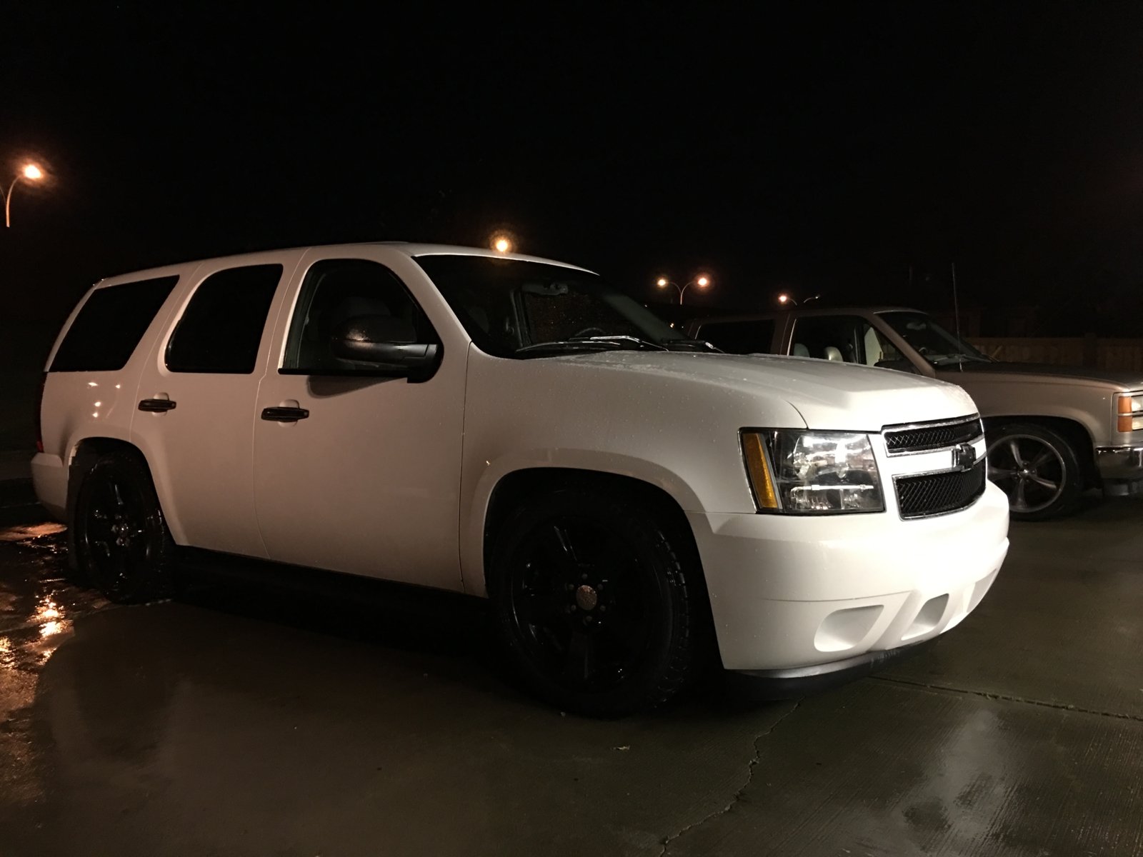

I haven't posted in awhile
But I've been busy.
I threw in a bell tech drop kit. 4/4.
It's too much in the front, which is no big deal as I can add the supplied spacers and lift the front up 1"
The rear unfortunately only dropped 2". But I'll live with it.
I also scored a set of GM Elevation 20" wheels.
Y
ybnorml67
Jun 30, 2017
8
I've never been a fan of black wheels but I think they look pretty good with the white.
But I've been busy.
View attachment 184437 View attachment 184438
Man, that looks great.
Did the rear ever settle down? I'm curious why it only lowered it 2" instead of 4".
