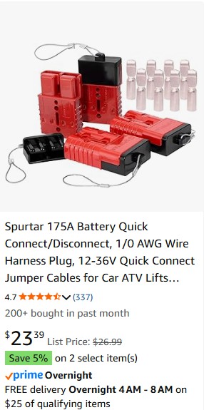

I run 2 batteries, one is the main battery, and it is always connected. The second battery is normally not connected, but it has high amperage quick connectors that I can connect directly to the positive buss and frame ground. This way, if I have a problem with the main battery, I can quickly connect the second battery and be on my way. I do need to periodically connect the second battery to the buss to keep it fully charged.

Wow interested concept... I think I know what type of quick connect your talking about as I used to run some big amps and 2nd battery for my old trucks car audio system... Are you batteries both the same? Meaning AGM etc? I did read that if you run 2 simultaneously they should be both the same type. I may consider your setup as I don't think I would need the 2nd battery connected all the time, but when out camping it would be nice to have the draw split into 2 batteries instead of one.

Both of my batteries are traditional batteries, and they are not the same brand, nor exact same CCA ratings. This has not made any difference, as I sometimes forget to disconnect the second one right away, after it has fully charged, and run them together for days at a time.
I have not posted that actual setup, as it was a quite simple project.

I'm not very mechanically inclined so I found a video, but not sure if it's something I can pull off. Thanks for the link to the harness. My car audio setup had a switchable breaker that I was considering, but this may be a better fit.
