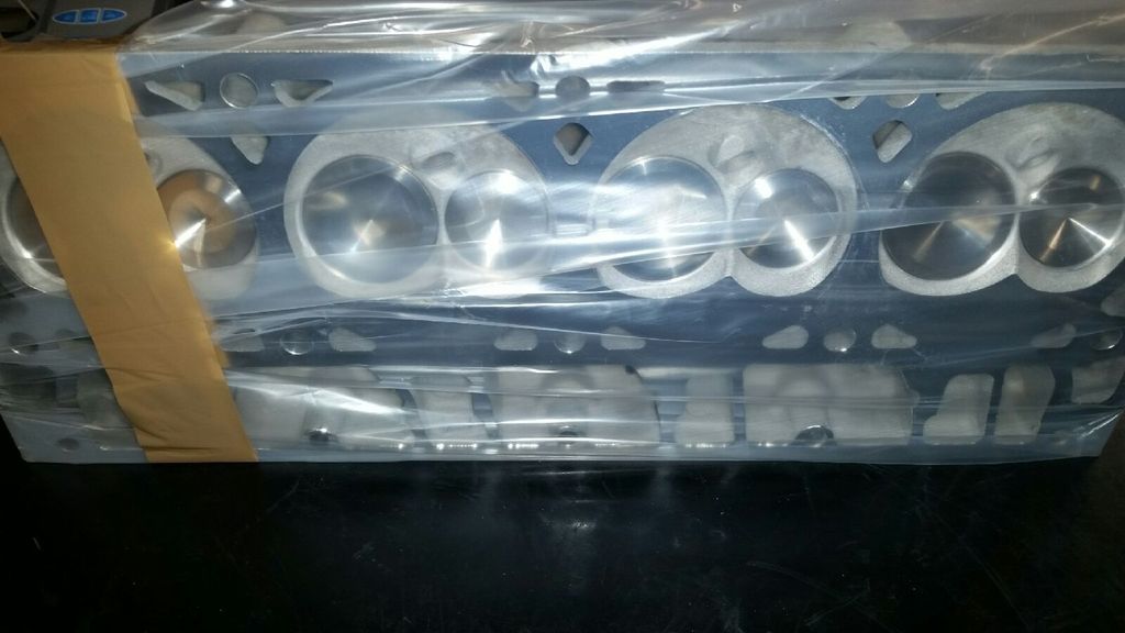

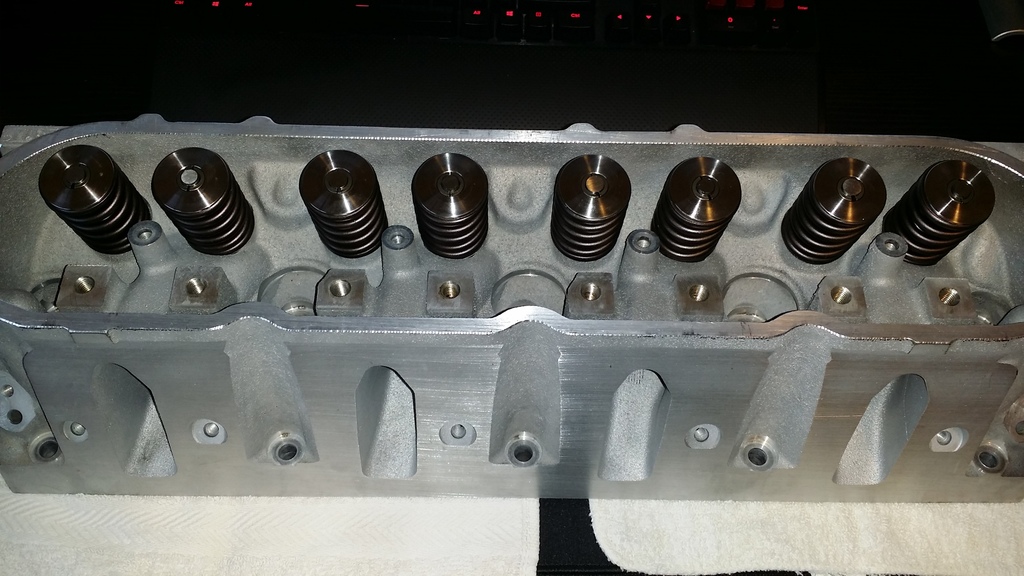

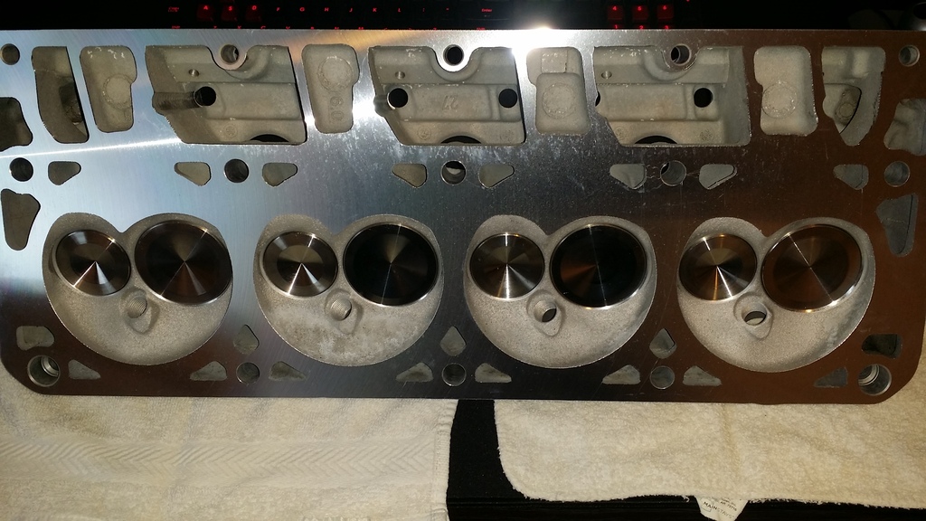

My Heads are done and they look like a work of art, lol These are the pictures I got from the Machine Shop (West Coast Cylinder heads) I Have to go pick them up Hopefully sometime next week, When I have time...
Spec:
  • GM 317 Core
  • 2.02"/1.575" Stainless Steel Valves
  • PRC .650" Lift Dual Valve Spring Kit Complete with Dual
    Springs, Titanium Retainers, Seats, & Seals
  • Minimal Surface Removed

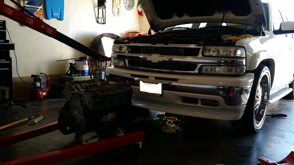

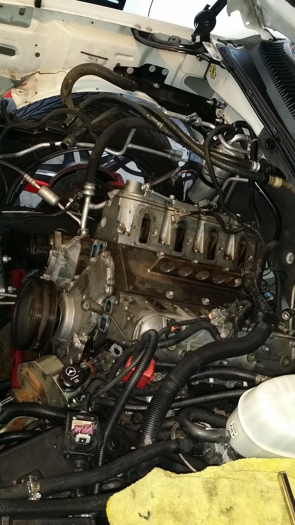

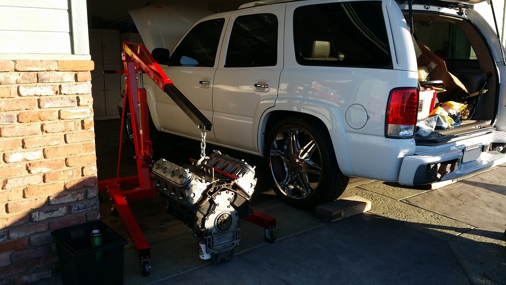

The Day the motor came out

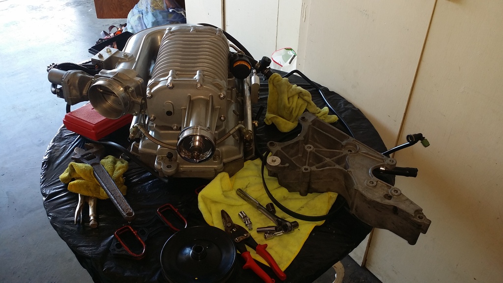

The Magnuson Radix Sitting on The Table

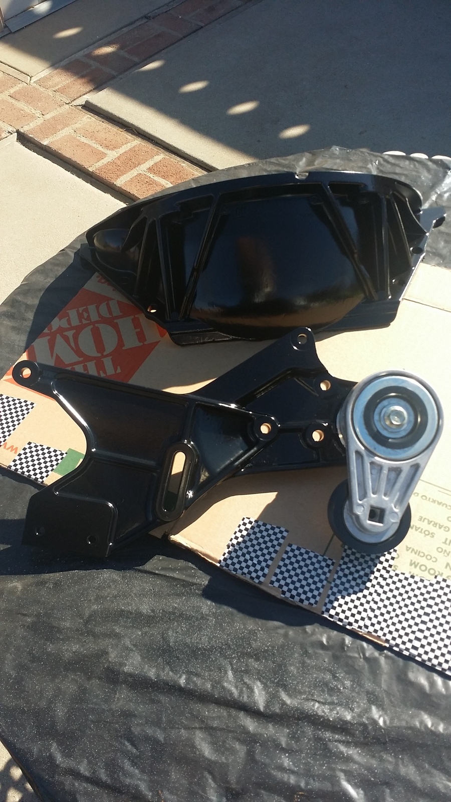

I was Originally going to powder coat alot of stuff, but Since my Powder coater isn't local anymore I didn't want to spend a fortune in shipping so I decided to paint alot of the stuff
4L80 Transcover and Magnuson Bracket Still haven't decide if im gonna polish the HD Tensioner

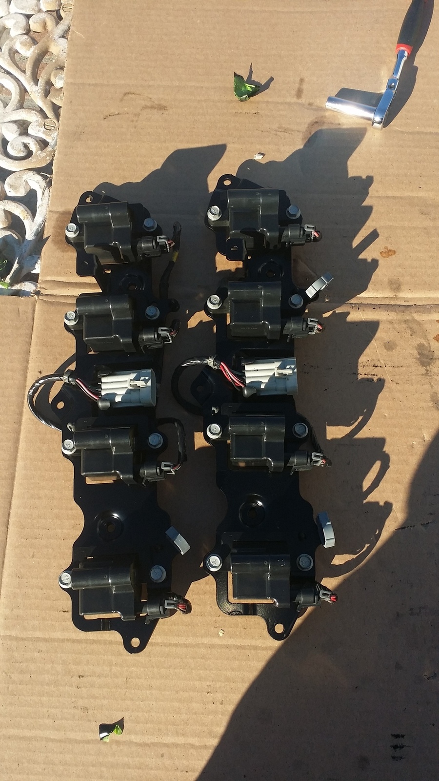

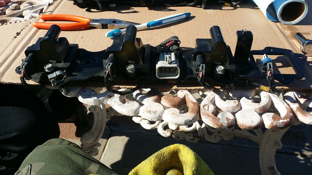

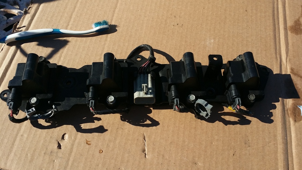

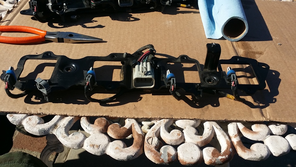

Next was to Clean up the Coil packs and Brackets, These were filthy
Done, Although they almost look the same the brackets were painted

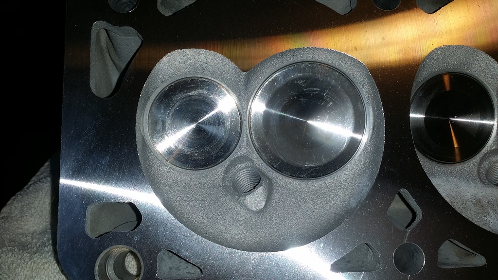

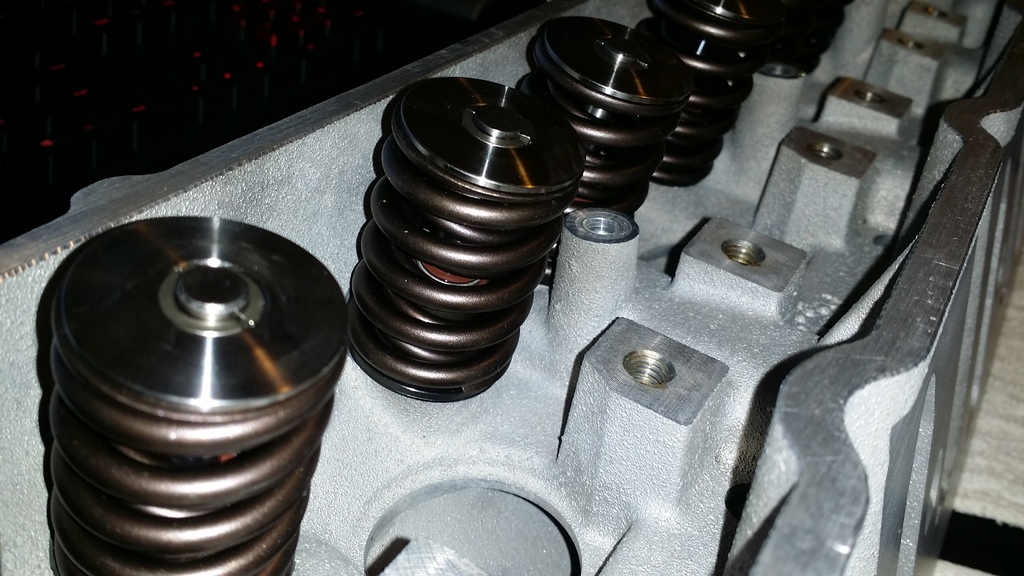

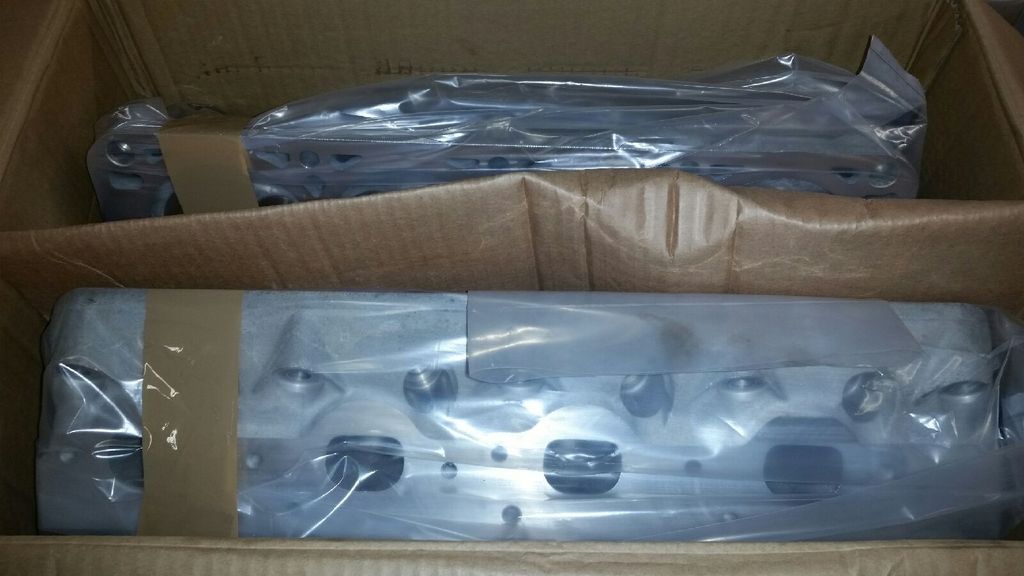

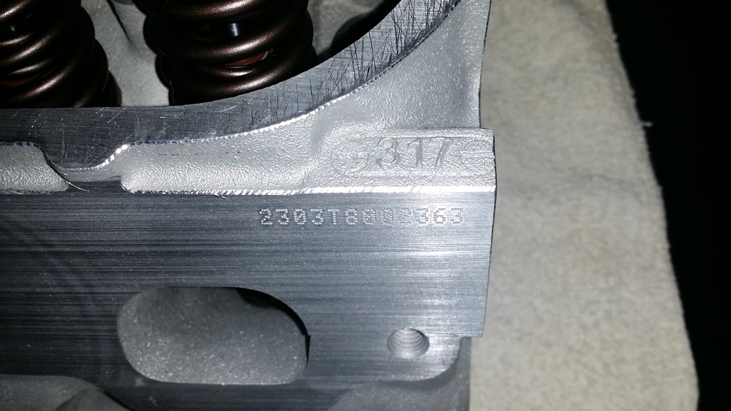

Finally had some time to pick up my heads, took a few pics for you guys
Minimal Resurface
Stainless Steel Valves Exhaust and Intake
PRC .650 Springs
Cast 317
Minimal Resurface
PRC .650 Springs
Cast 317
Did the port and polish or just clean them up? If so, how's the port work look?
bottomline2000
Oct 21, 2009
1,722
991
Dallas, TX
Decided not to do the port job, They just have a 3 angle performance valve job, With upgrade stainless steel valves..
Nothing wrong with that. I had spoken to lot of "top" machine shops here and one guy flat out told me the job was too small and not worth it...ugh...heads are where you can make big gains and the bigger valves and blower should work well together.
Correct I just didn't see the extra money for P & P Heads, I talked to a few machine shops and they agreed also, eventually when I upgrade the blower to something Bigger I'll get a nice set of heads to go along with it.. For now I think it should be more then enough with my current set up.
So Stage 1 - Fuel System
Stage 2 - TVS2300 or Whipple 2.9 with Stage 2-3 heads

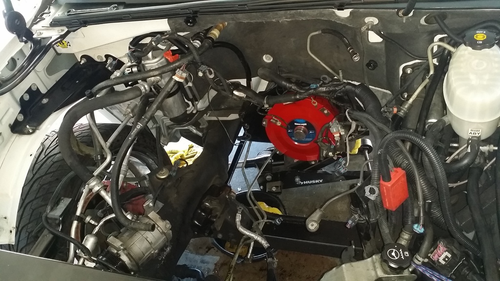

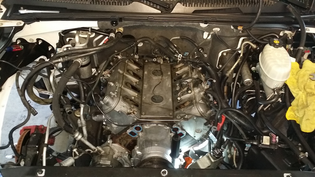

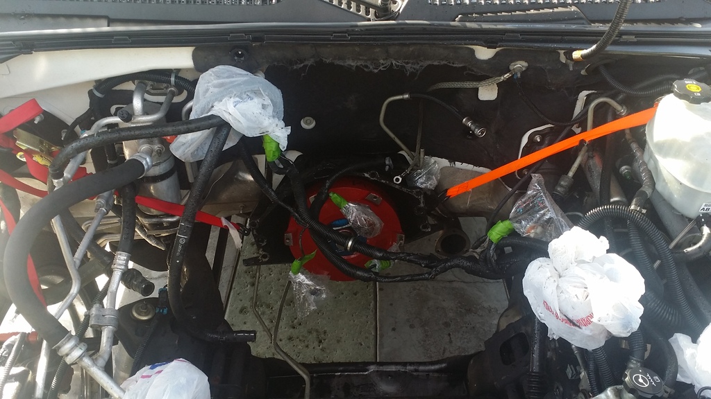

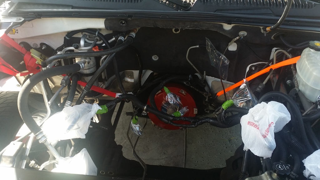

So I had some time off today and decided to work on the truck a little bit since I have some down time and waiting on the motor figure I would do something productive, Nothing big just routine maintenance
Covered all Plugs getting ready to Pressure wash the engine Compartment there was transmission fluid all over the place.
Done not noticeable difference in picture but in real life big difference.
Took the ***** out on my driveway so she could dry and get some sun, Since all it knows is being in the garage

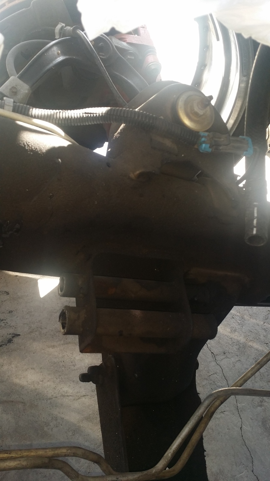

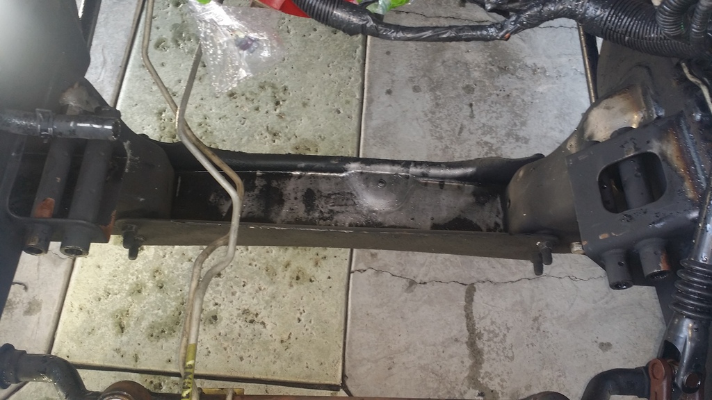

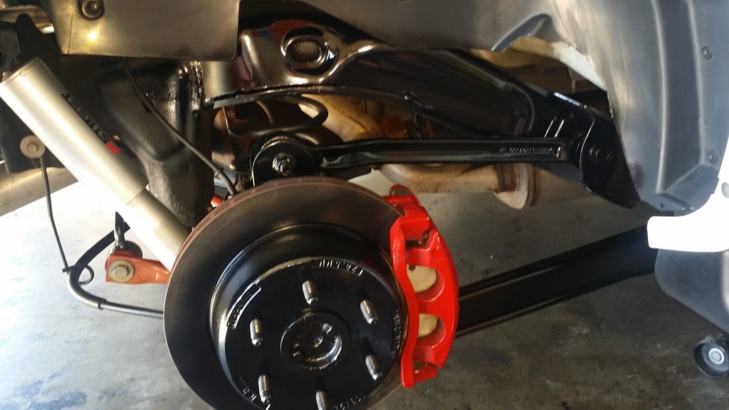

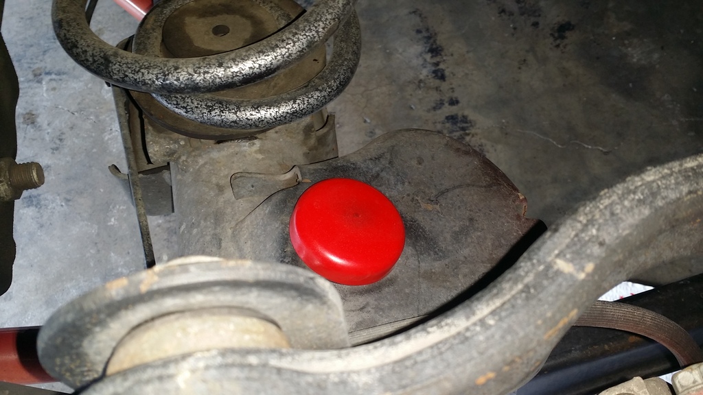

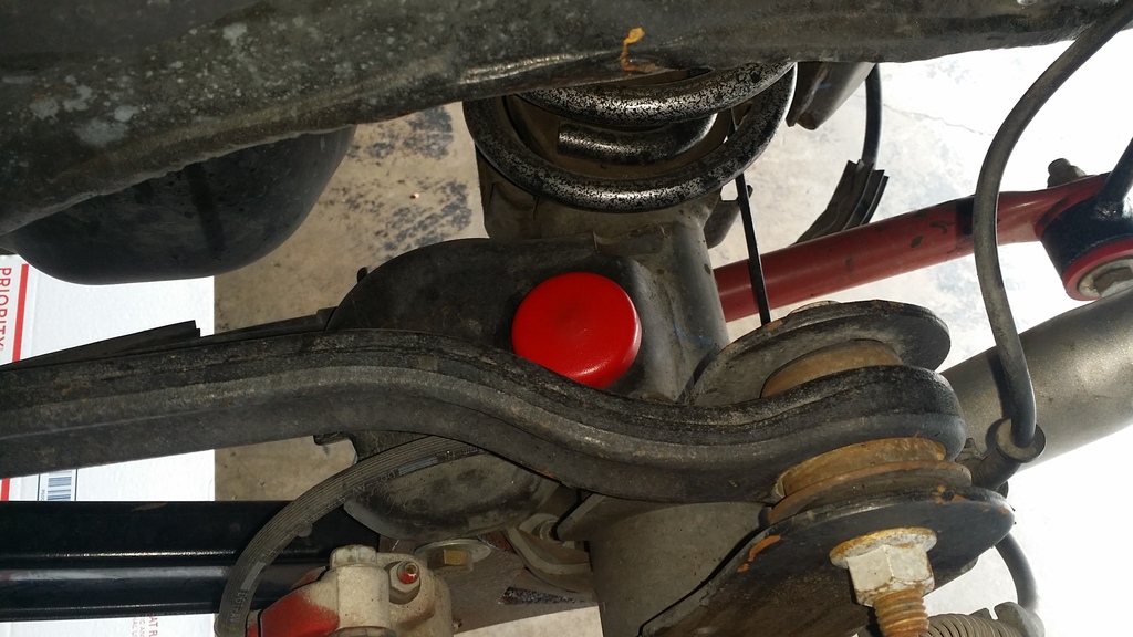

I also went ahead and finally put my bumpstops that I had for more then 3 years and finally now decided to put on, lol Thanks to @Fosscore

Damn those are some pancake bump stops. Nice work! Looks like you took the wheels off for easier access. Good call.
I noticed a bit more travel today after cutting mine down yesterday. Was worth the effort, but still dodging the same potholes that they won't fix.

Damn those are some pancake bump stops. .
Yeah That's the first thing I noticed compared to yours, lol Oh well this will be just a trail and error, Only reason why I put them on was because I already had them. Hopefully It wont hit metal to metal when the truck is loaded with passengers and cargo. I did take off the wheels I just couldn't get my hands underneath the bumpstops a little more work but got it done. I gotta do some suspension maintenance Im gonna take some stuff apart and clean up and rattle can some stuff black to spruce it up a little bit.
Fosscore
Apr 16, 2014
10,883
19,821
Tight fit under that axle pad. Nice work. I bet you will be good loaded up. You should put the Air Lift bags part number 60742 inside your springs for some extra lift. Can air them up to 35 psi and hold that rear end good. Mine are aired out at the moment but they do lift the ass if you need it.
$80 for the kit. 2 bags and air lines.
I flew over a train track last night a little faster than I normally drive over it and got the extra travel but it hit the stops hard. Sounded horrible, but did what it was supposed to. Frame on polyurethane. No dramas.

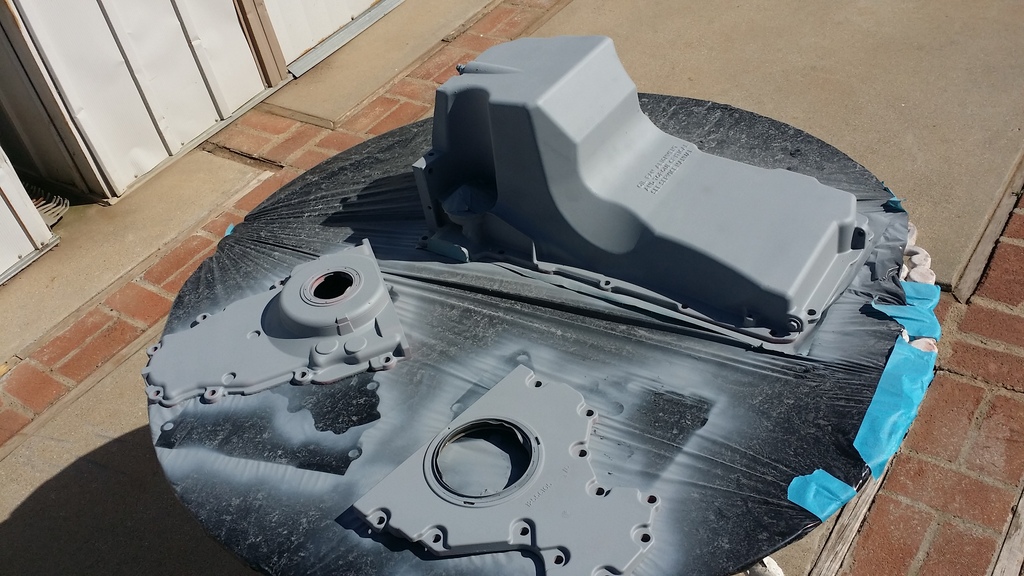

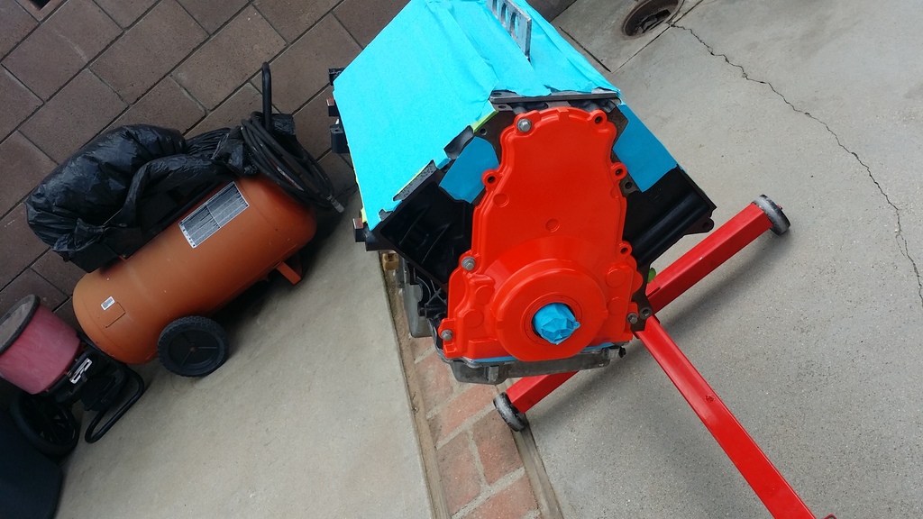

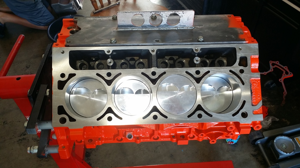

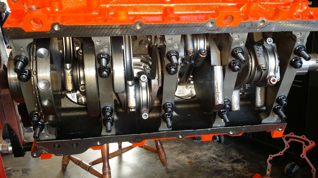

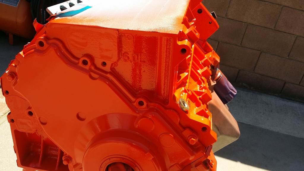

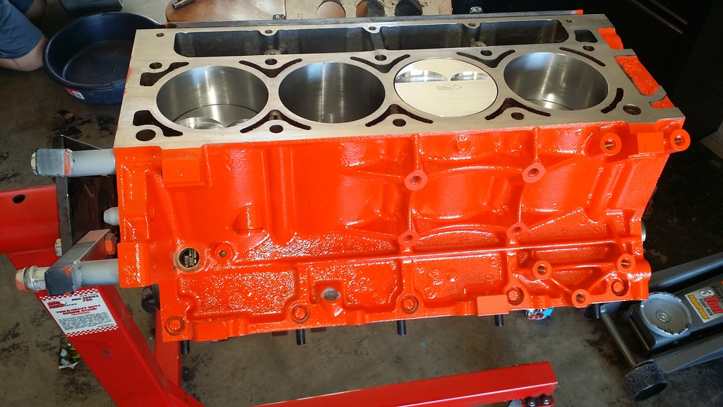

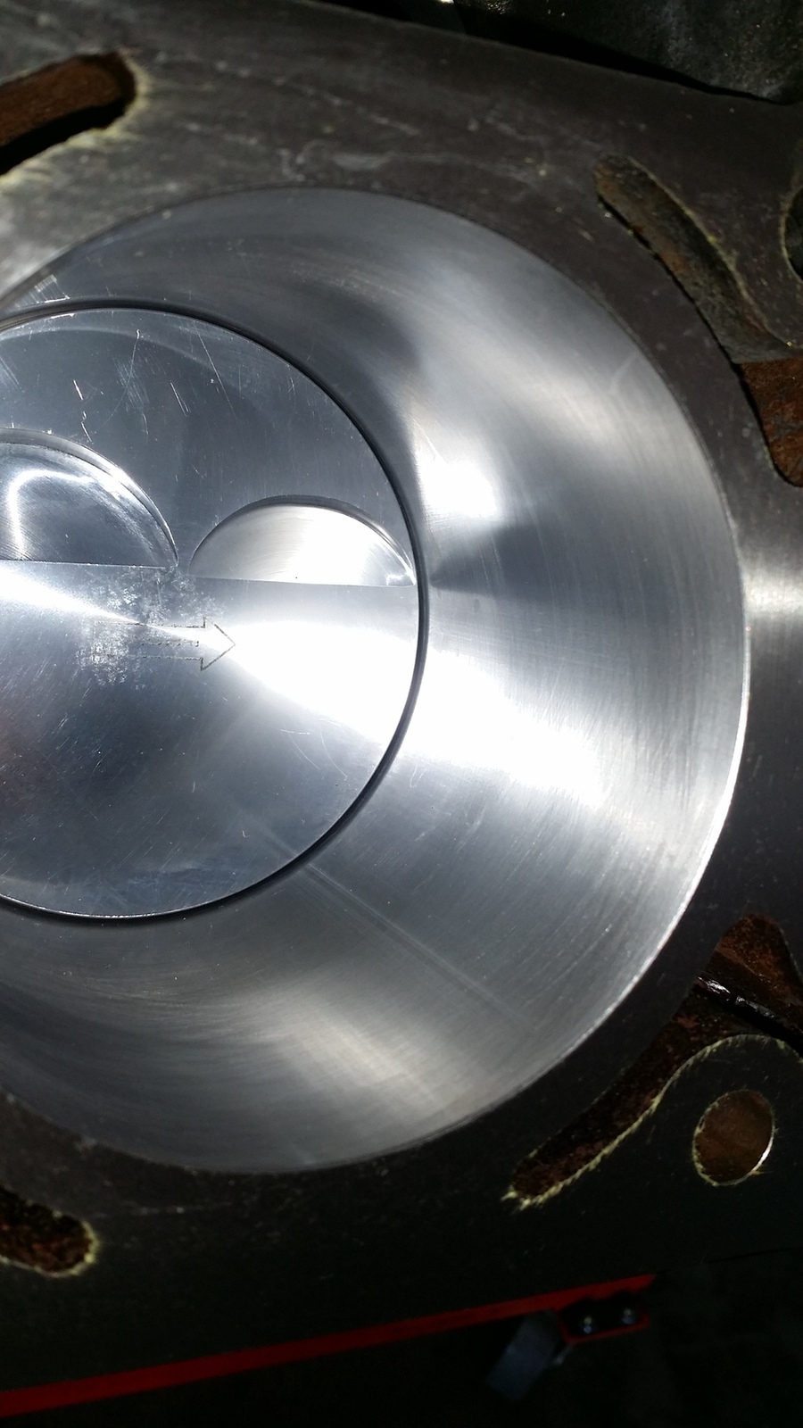

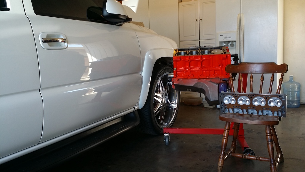

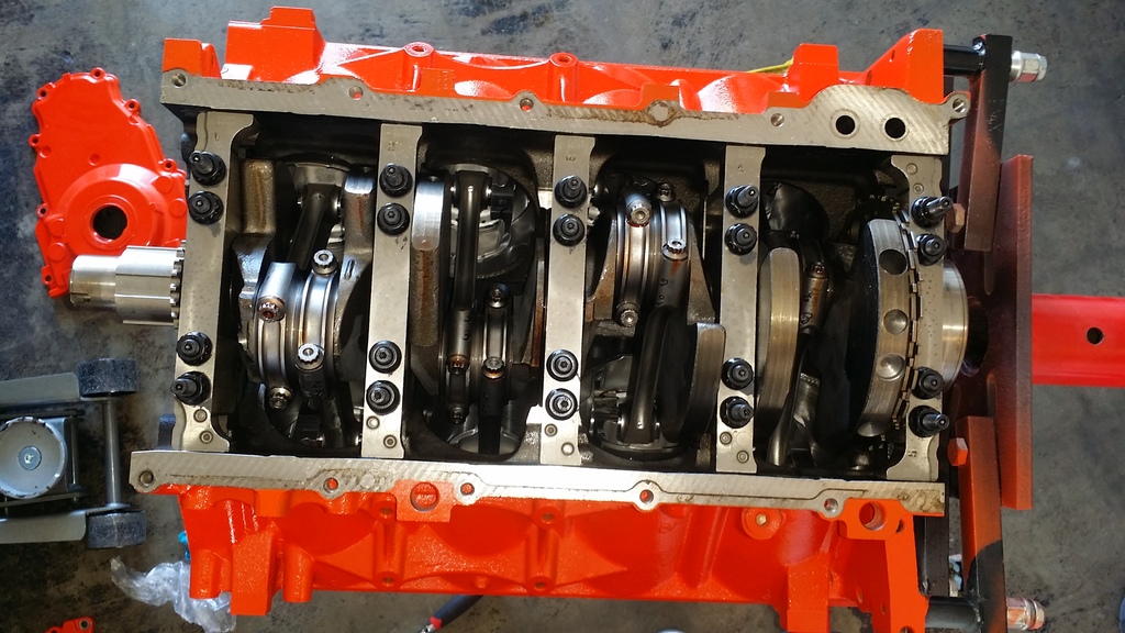

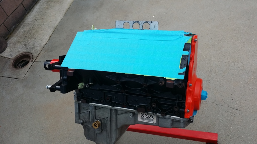

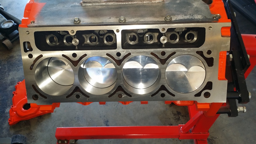

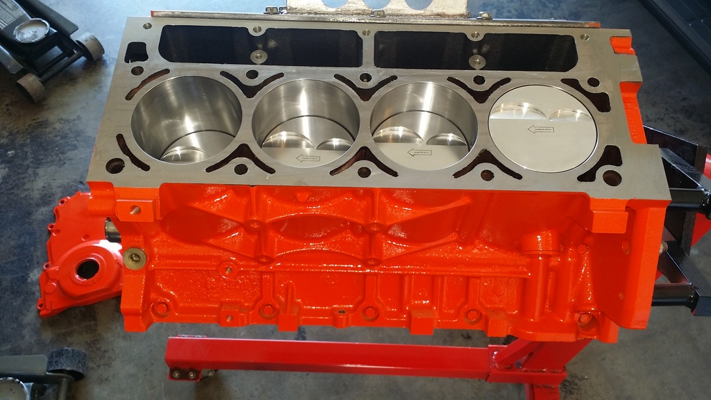

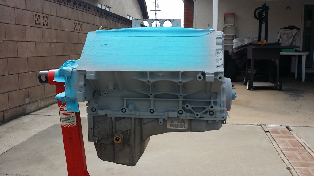

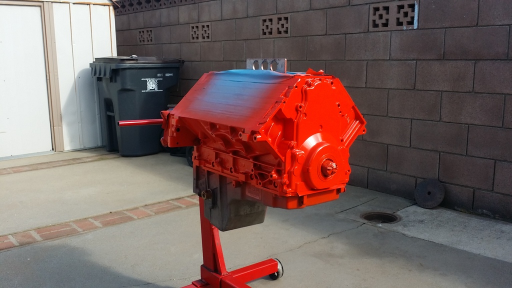

So I finally picked up the short block and did some painting I think it came out very good.

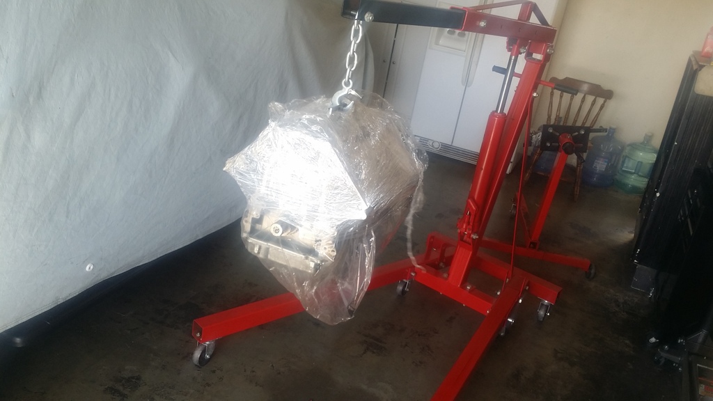

This is how I pickled up the motor all wrapped up for me
Spend about 1 hour making sure I masked everything and about 3 rolls of painters tapes, Wanted to make sure their wasn't any over spray inside the engine. It was easier for me to put the rear and front covers on I didn't feel like mocking up a cardboard template, so I went this route. The front and rear Covers are gonna get painted black to add some contrast
Here are the pics
3 coats of primer
2 light coats and one medium coat
then 3 coasts of Chevy Orange
Waiting on the new heart Transplant
the goods
This is were I left off, Tomorrow hopefully if i have some spare time I will paint the oil pan black.
I also worked on the rear end just wasn't happy with how I left it last time
