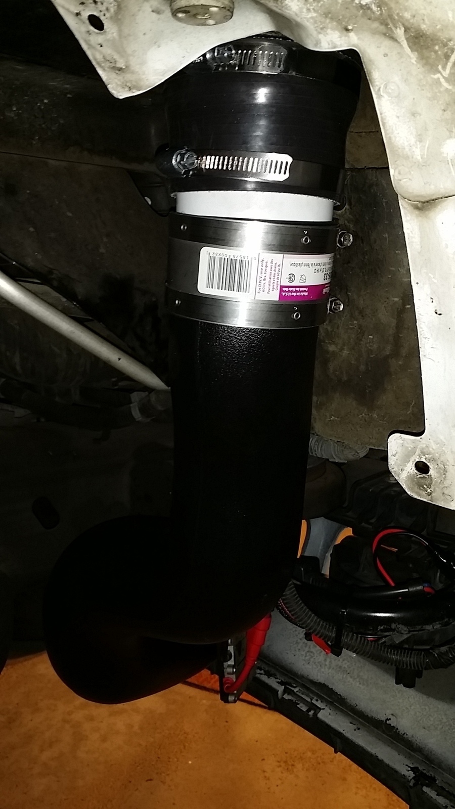

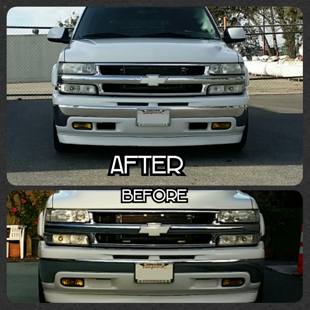

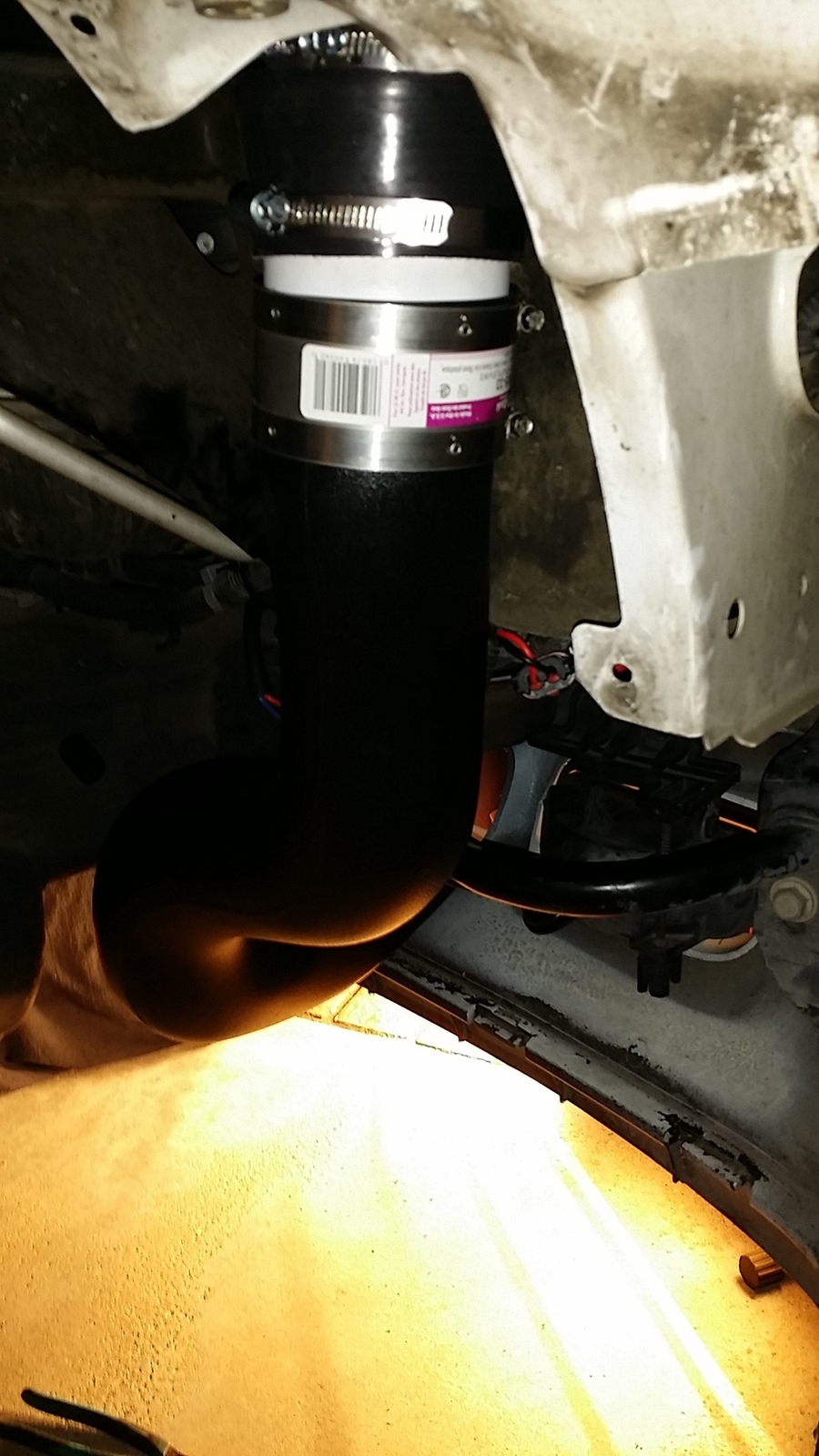

So I had to Dremel out the Lower Valance to fit in the Voolant Scoop here is a before and after picture
IMO it looks better.
I had to run to Home Dept First for these fittings
and here it installed
Going into the Valance
My HID Ballast Were mounted properly I just had to take them down momentarily

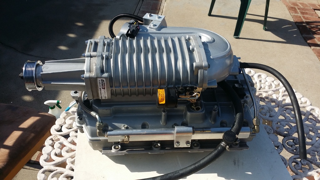

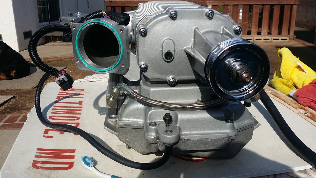

Also cleaned out the Supercharger This was filthy apparently one of my gasket was seeping

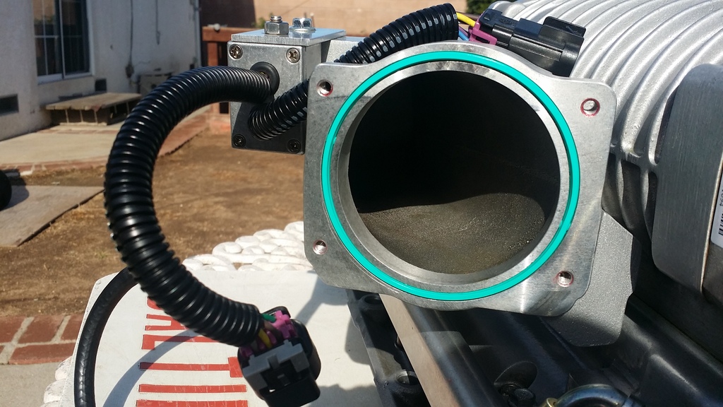

My 90mm Inlet

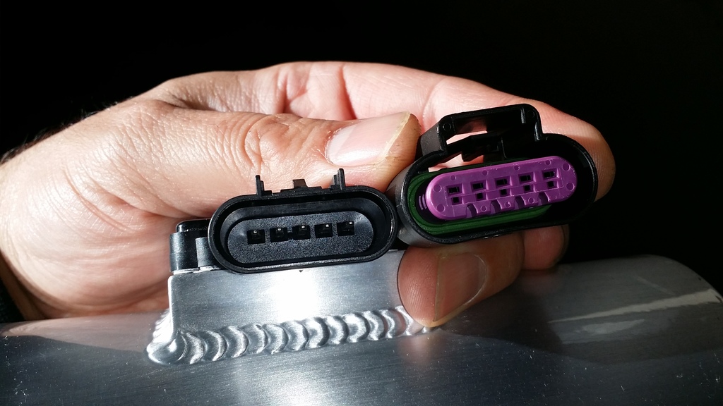

and finally got my LS3/LS7 Style Maf Connector

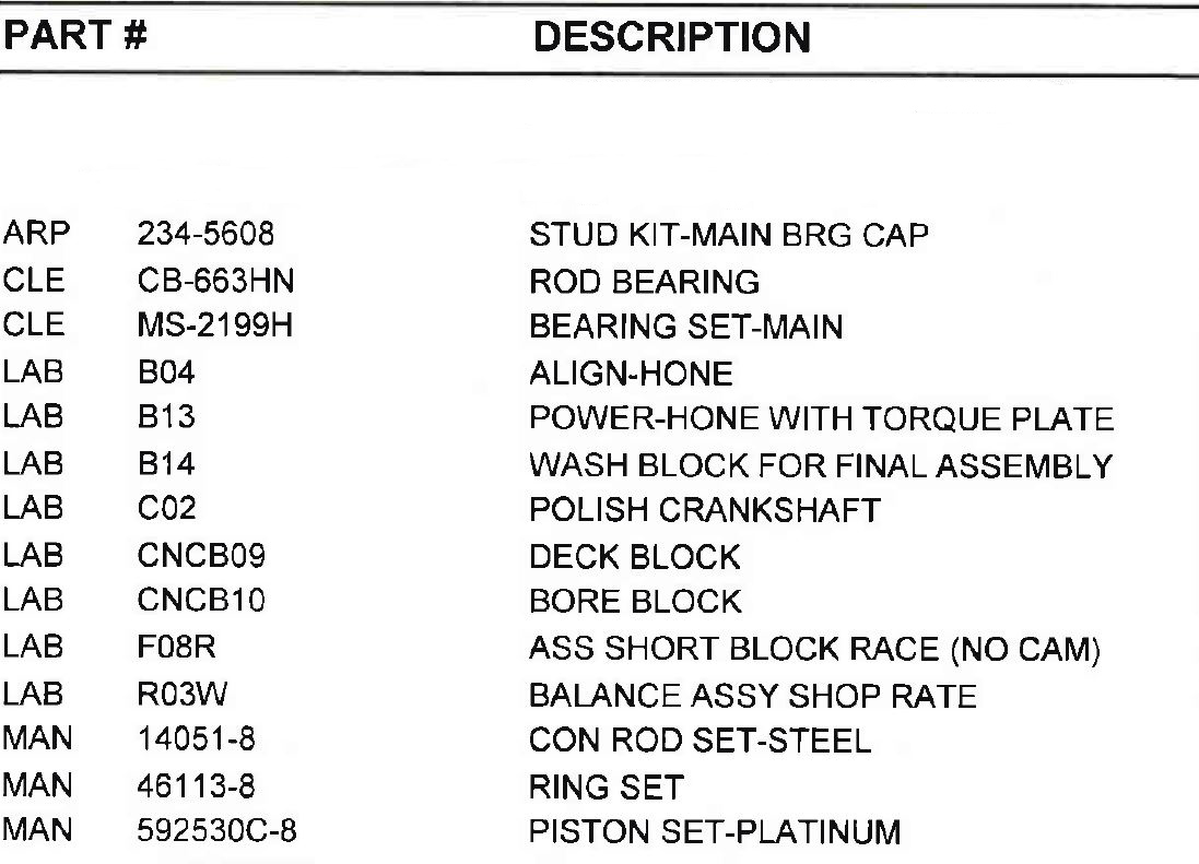

So I finally got a break down on the parts that are gonna be used on the forged Motor and here is partial Picture of my Invoice, What do you guys think? This motor is rated for 1,000 HP, although I don't think I would ever see 1K HP, but I have peace and mind that I know I could pretty much throw anything at it and it won't hiccup. Well That and a tune go along way, lol
Yeah I wasn't sure if it was a factory gasket or not and I would figure if a company took time to blue print an oil pump they would get the oring right.
My truck is running good. I've been enjoying the trucker. Scared an old man when I revved my truck lol. He threw his hands up..all in good fun..killed a hemi truck..didn't know what hit him.. No regrets on the cam, but I have sprung an exhaust leak in my dynatech headers so we'll see how this works out since they're coated...
I'm sure once you get that forged motor up and running the Ole trucker cam will be a distant memory lol. I've seen one of the guys on pt.net running a blown forged 370 and his crew cab is running 11's. I'm sure you'll be in that ballpark.

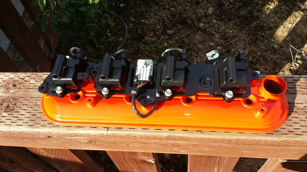

Haha, that color looks familiar!! Looking good. Those valve covers are going to look like they on fire in the truck!

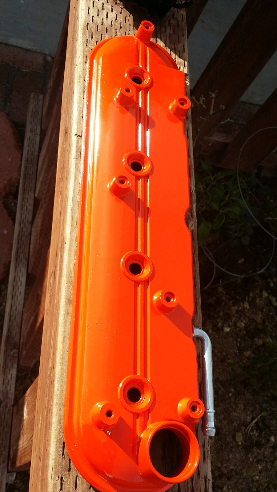

Wow!! That red pops!!! :head3:

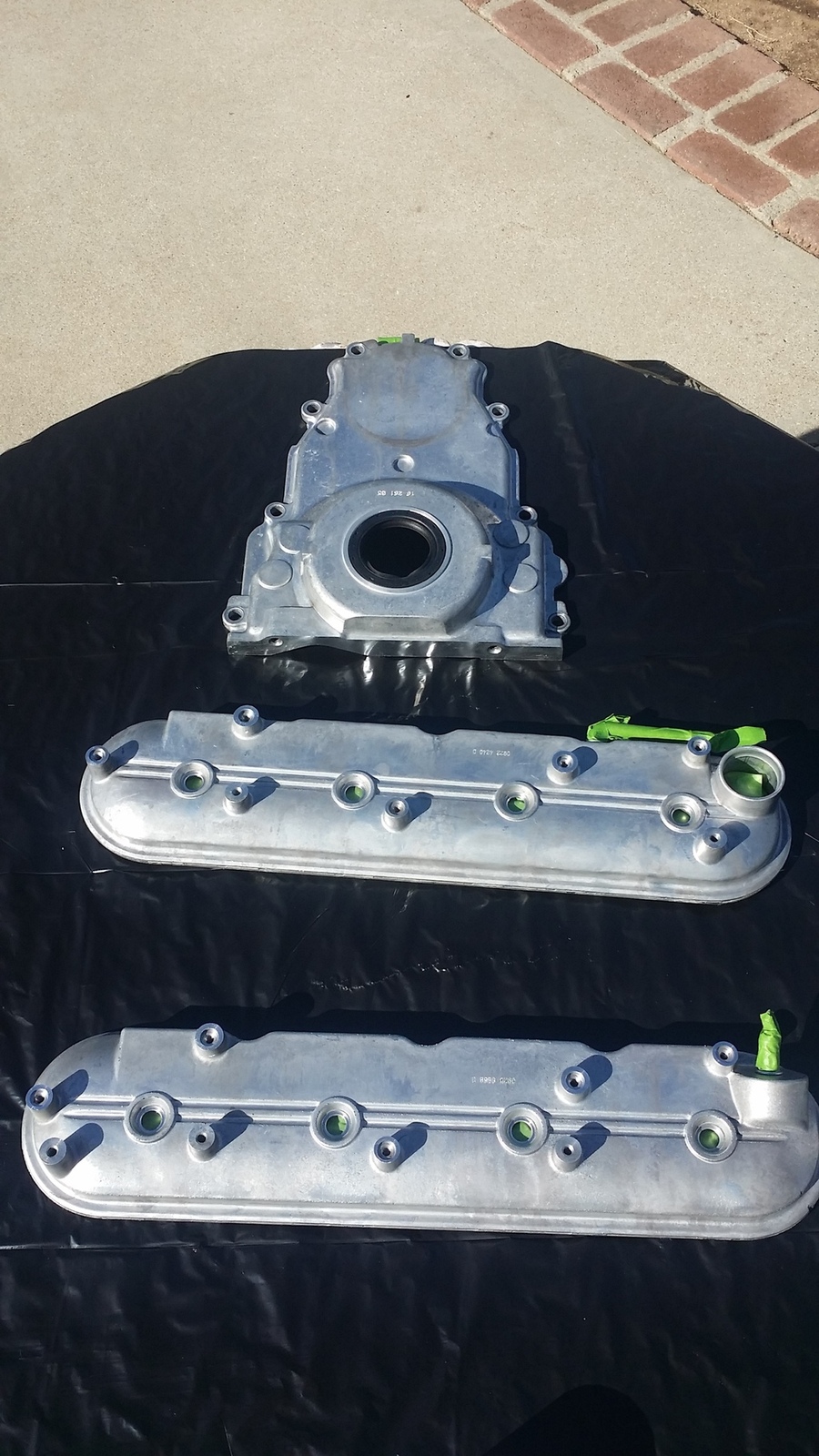

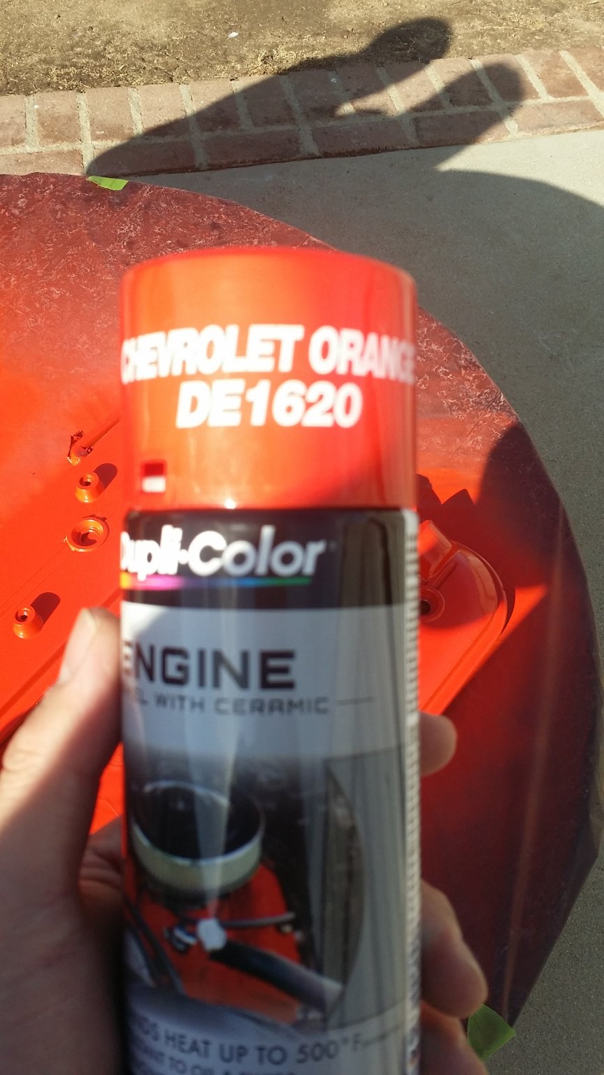

lol FML they aren't Red, It's Orange Chevy Orange.. Thanks Though, They have a clear on them.. Your HD Hood Motivated me, lol

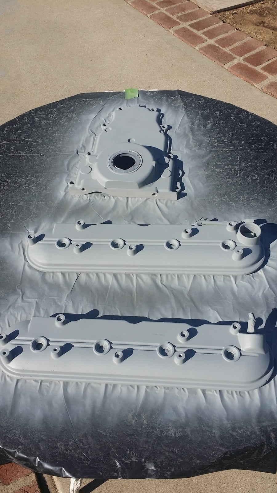

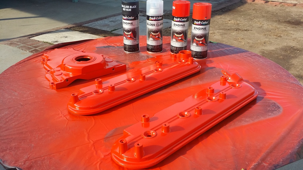

Yeah I thought they came out good, I did
3 Coats of Primer
3 Coats of Chevy Orange
3 coats of clear
Hopefully they withstand the Treacherous hazardous Conditions, lol
When I changed out my VC gaskets I was thinking about doing that and man now I wish I had done it. Looks like I'll be adding that to my to do list once the weather gets better.
Oh yeah no doubt about it, you should definitely add this to your "to do list" Just make sure you clean the surface good and get all the oil out.. That's Key

Haha funny looked a light red shade in first pic then that 2nd one had me almost guessing orange. Either way flaming hot is what it looks like.

My entire engine is painted from oil pan to intake and it's holding up great. I have a spot where my driver valve cover gets a lot of heat from the hoop in my header and the paint is not bothered. It's good stuff.
