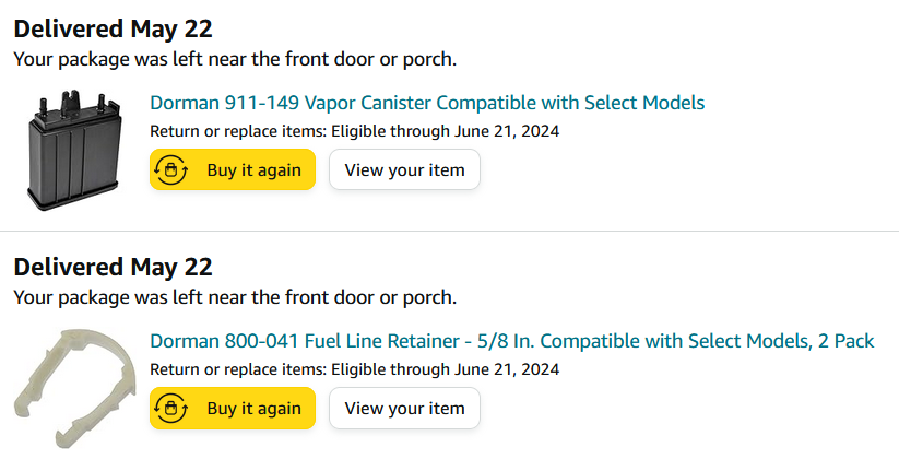

Charcoal canister was an easy one. Maybe 15 minutes.
I didn't order a new one until I had removed the old one to see if it was the canister. Upon removal charcoal started falling out, so I knew that one was toast. Checked the lines for any loose charcoal, didn't find any.
I removed the spare tire before starting-- not required but I can definitely see where it made things a lot easier.
Broke the plastic retainer clip.

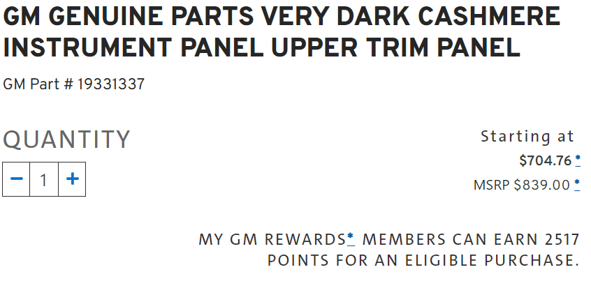

Both parts counters wanted $830 for the new dashboard.
Stumbled upon parts.gmparts.com, ordered it from one of the local dealers and got a much better price. Lowest price ($705) was over an hour from me at some other dealer. Not worth the drive to pick it up.
You can get some smoking hot deals with the 20% off coupon. If you need some genuine GM stuff, I recommend checking it out.

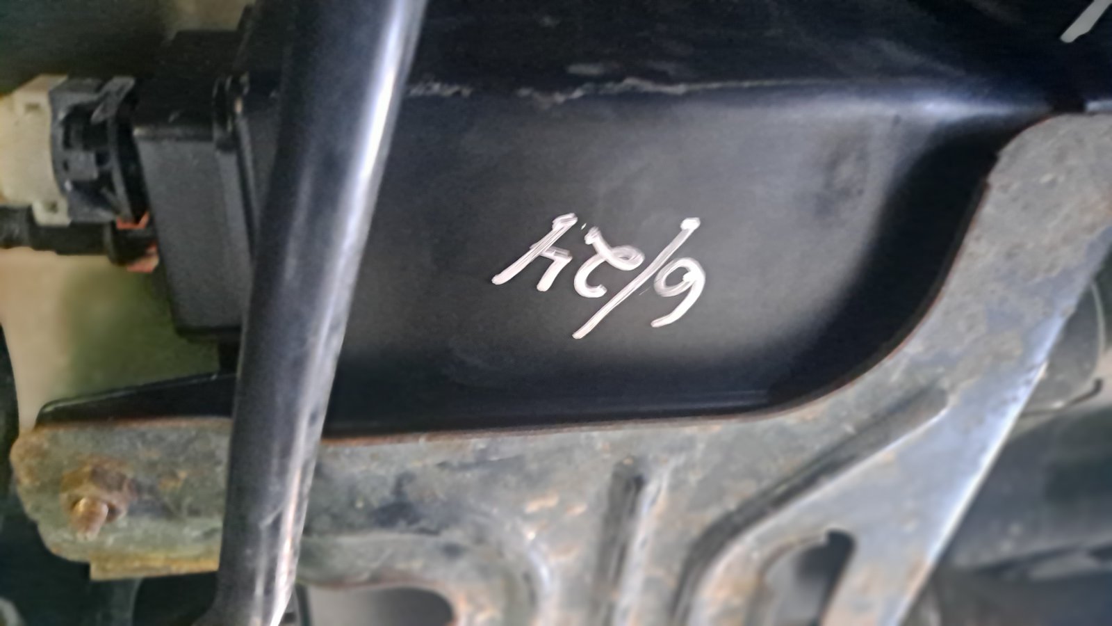

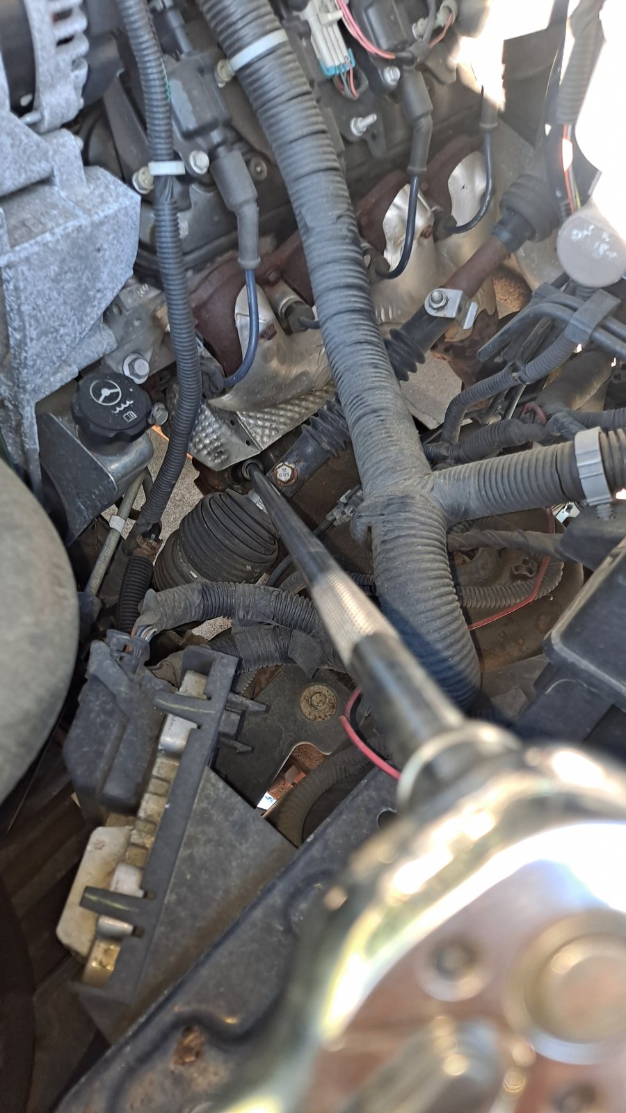

Driver's side motor mount replaced. 2 hours. Definitely resolved the clunk on throttle. Still feeling a clunk going over a bump (ie backing over curb) Wonder if it's the passenger side motor mount? Any way to easily diagnose that?
What I used:

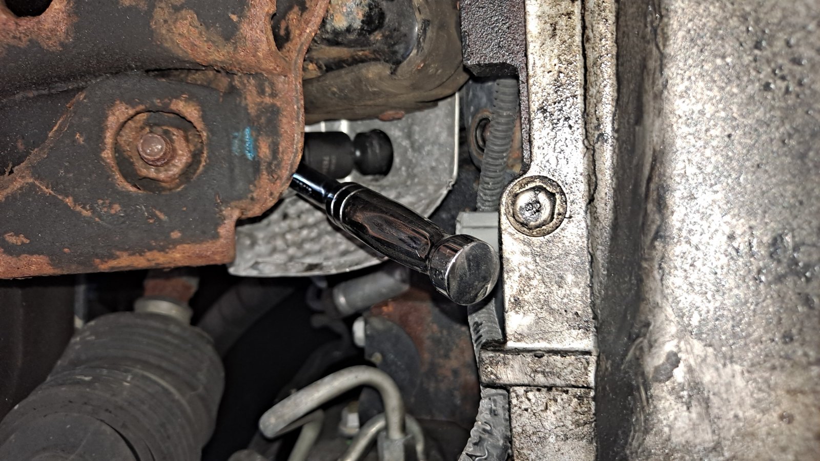

-18" socket extension (for the 3 bolts to the motor; no extension used on the top front bolt to the motor)

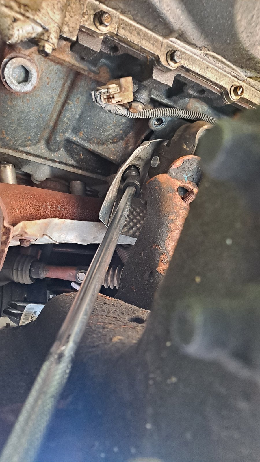

-36" socket extension (for the 3 bolts to the frame)
-15mm swivel socket
-15mm ratcheting wrench (for removing the intermediate steering column)
Everything went super smooth.
Time to get started:
18" extension and swivel socket made this too easy:
Top front bolt just needed the socket wrench:

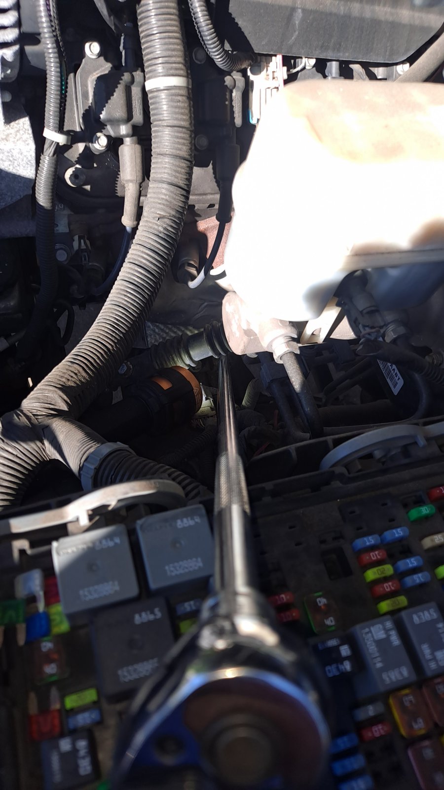

Used the 36" extension to tackle the bolts to the frame; removed the fuse cover to make it easier:

36" extension:

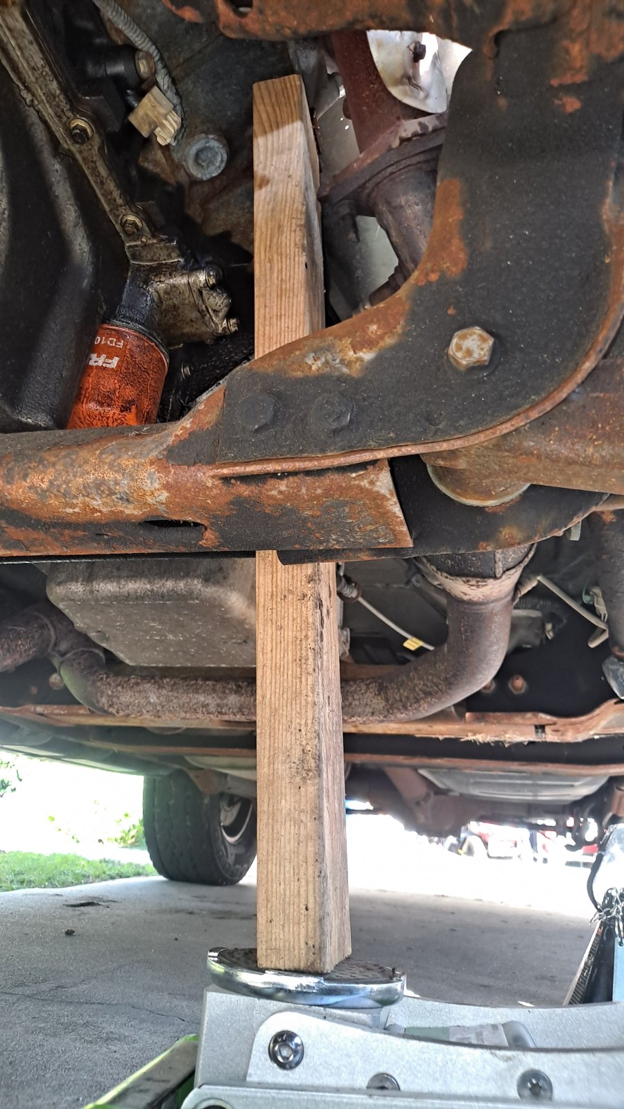

I used a block of wood to jack on the block. Seen some people use the cat, seen others use the oil pan. That all seemed a little sketchy to me. Just make sure you chock the wheels on your floor jack:

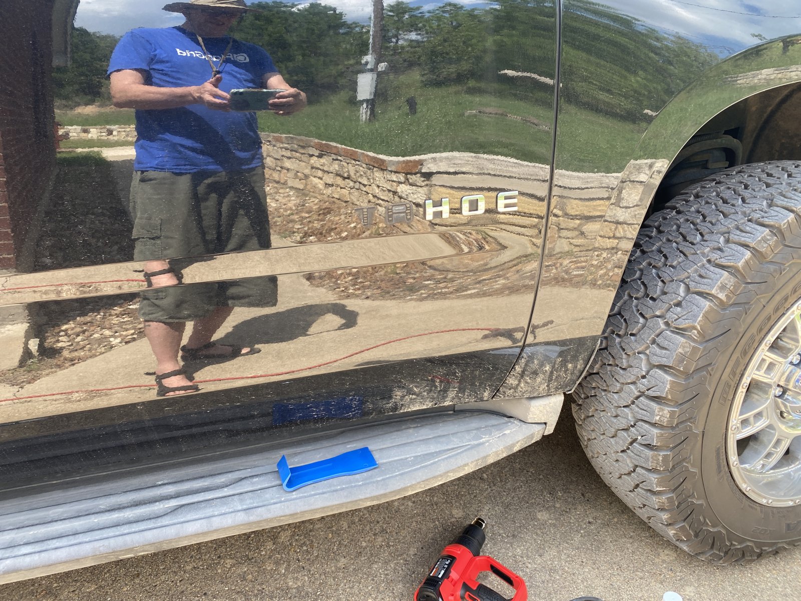

So... this happened.

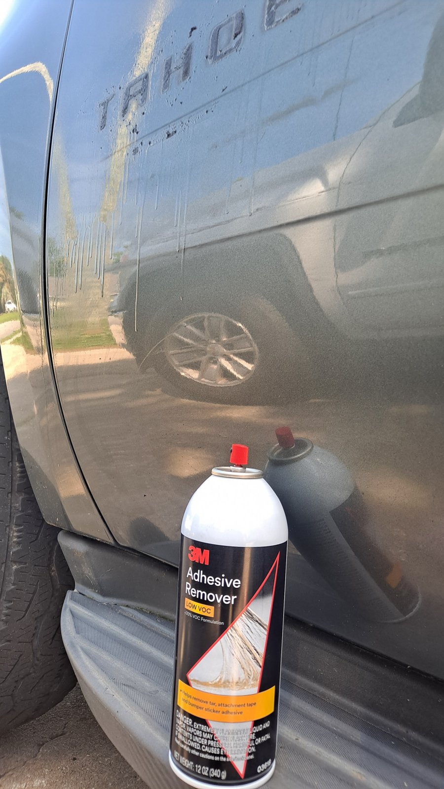

Got the logos and trim (which was barely hanging on for dear life) removed from the tailgate and driver's side.
Also got the panels cut. Hopefully I'll get them polished and sealed tonight.
I love the SC heat but unfortunately I lack an indoor space, so I have to wait until after 6pm to get anything accomplished with the car chemicals. Worst thing you can do it try and cut/polish a panel that is hot.

I almost stopped on mine when I got to this point.
lol.. it's like leaving "RAD" when you shave "SILVERADO"
Thought about the heat gun, but that adhesive remover it's pretty sweet. Just let it dwell. A few minutes makes it so easy.
This morning I looked at the panels I cut last night (difficult to judge without sunlight, and I can't afford a sungun) everything is looking really good. I think with the polish it will be stunning (for a 13 year old vehicle)

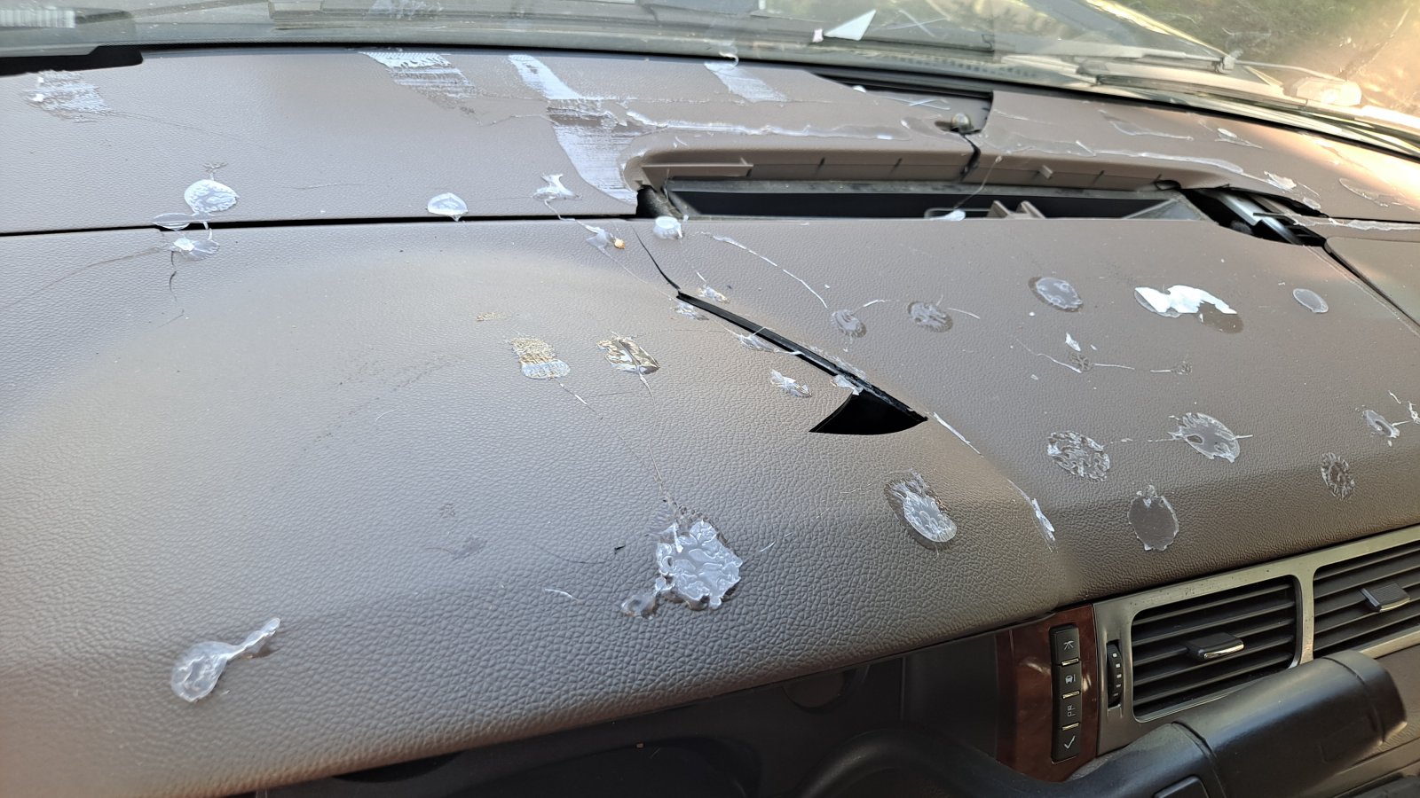

TBH I was fine with the dash cover. However, after I bought the Tahoe I soon realized that the ambient light sensor was missing. Fallen into the abyss that is the dashboard.
Removing the cover was a fun- [read:explicative] filled adventure. On the plus side, I can read the radio now.

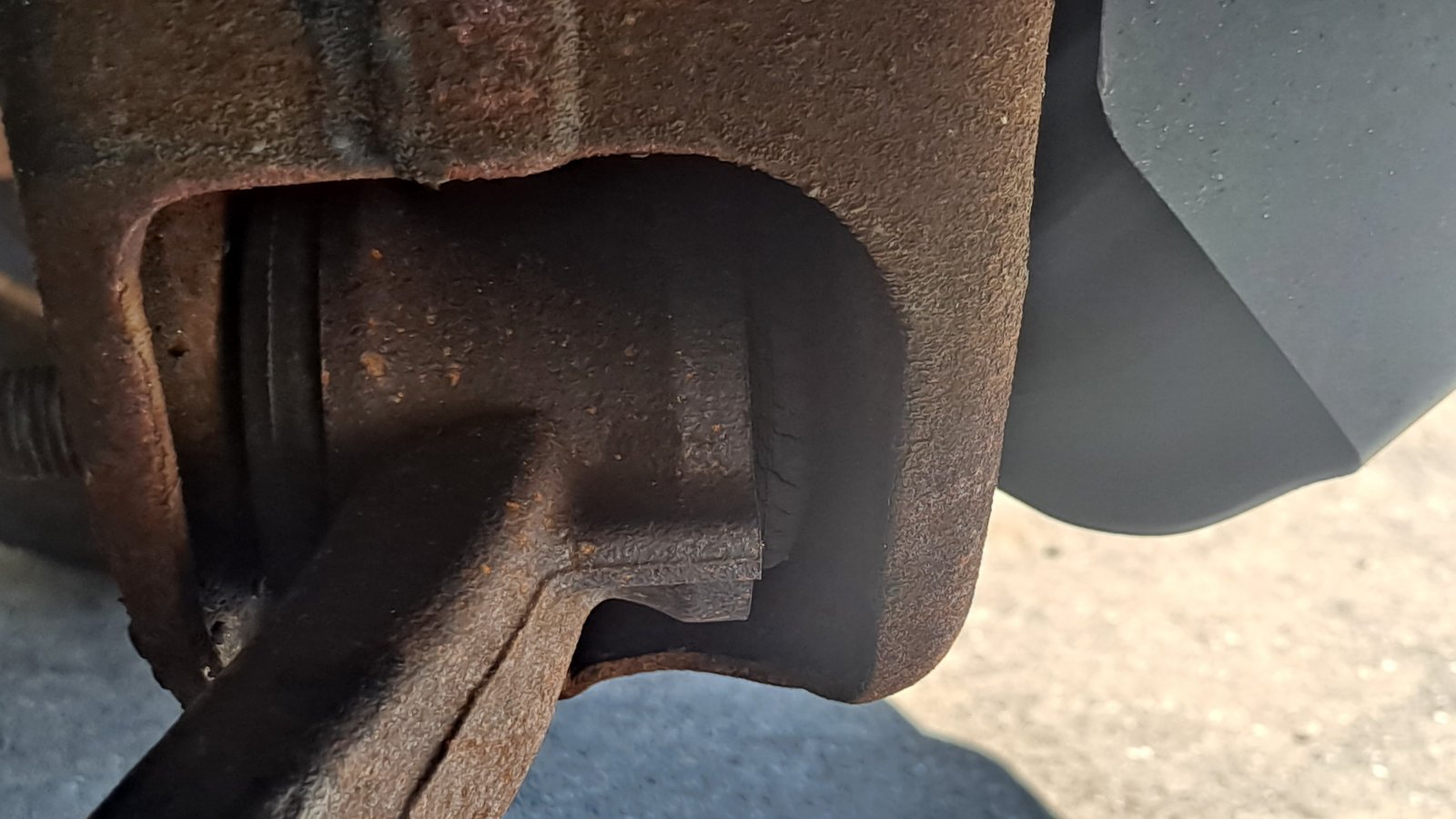

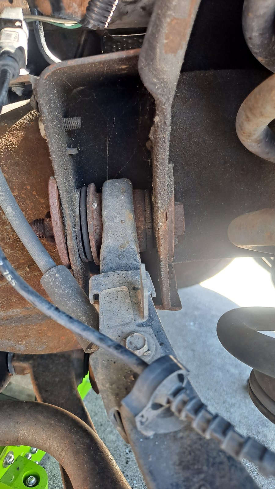

So the mystery of the "sounds like a clunk from the front when I back over a bump" continues...
Next thought is maybe the strut.. Looks original to me, been meaning to replace anyway...
What do y'all think about these bushings? With front wheels suspended there's no wiggle or slop, but I'm wondering if I should just go ahead and press new bushings in there when I'm doing the struts? TBH they look ok to me.. granted I have no idea what I'm doing.
View attachment 429988View attachment 429990
You can get complete replacement upper and lower control arms with new bushings and ball joints that will make the swap a lot easier for the diy guy with them being that cracked up I’d lean towards replacement
Last time I looked I think the lower arms were maybe 150$ a piece give or take
The uppers I’m not sure cause I ran aftermarket upper control arms
