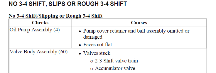

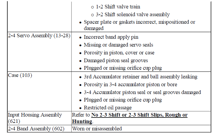

Where've you been? It's been awhile. Can't answer your questions, might want to look through Precision Transmission videos on youtube and see if they mention it. Oh wait, I think I have a troubleshooting guide for yours...
Well, I found this in my GMT900 4L60 manual, not sure what to make of it:
Been busy with alot without much time to spend on here. Work, coaching sports year round, plus I just haven't done much with the truck except keep it going as long as possible. That was going pretty well until this issue popped up.
I've got servo seals on the way for the 4th gear servo. I think I'll try that first and then maybe the shift solenoids. If neither of those do the trick I'll probably limp it along while saving for a rebuild.
Appreciate the info by the way. That's the kind of direction I'd been looking for but couldn't find any documentation.
