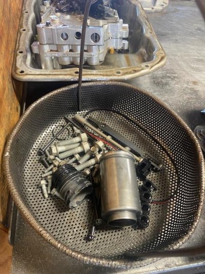

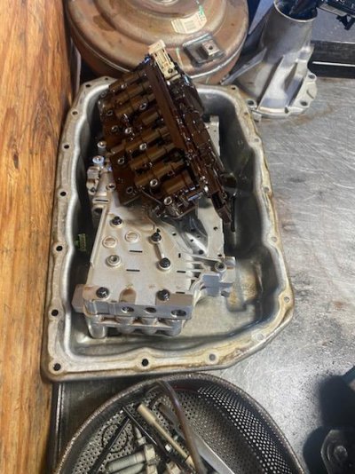

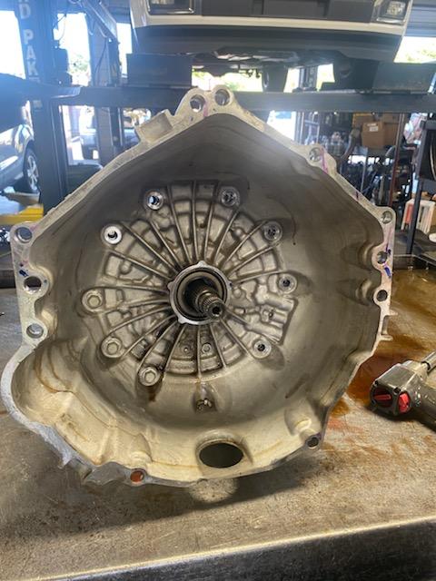

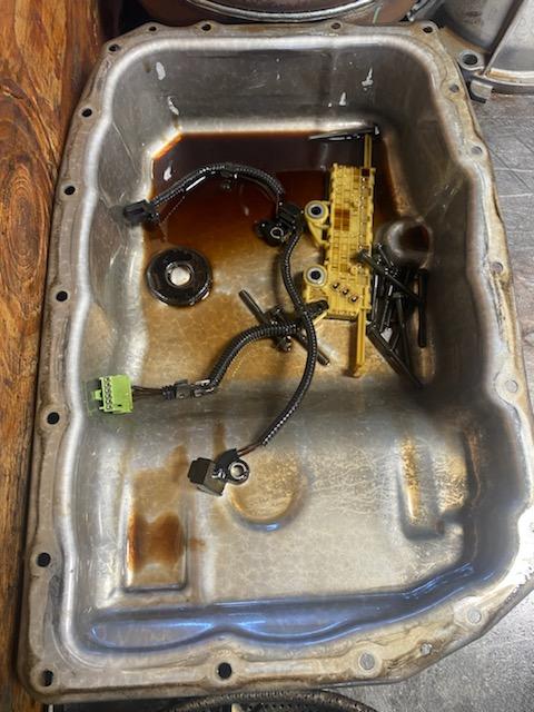

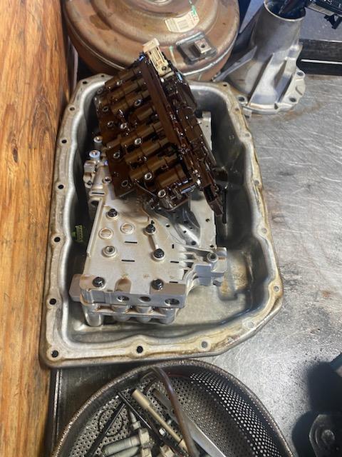

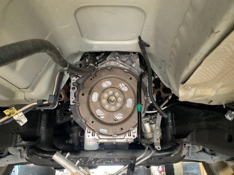

Yes... had it all apart this morning (pics attached).
I believe FTC is their supplier. That website matches what they sent me as the specs of the new TC.

Did you ask them any of the questions in my previous posts?
If so, what did they say?
Well, to say I got a little pushback from the mechanic (not owner) questioning his plan would be putting it mildly. I understand he probably gets tired of internet mechanics/ experts questioning him the same way my wife hates "Dr. Google" in her medical field.
That said, he did go through each of your questions with me.
Yes, all bushings are being replaced.
He said the pump looked to be in good shape and did not want to open it up. He claimed "tinkering" with them can cause more problems.
Is not planning to reinforce base welds.
Not using factory piston
Mechanic couldn't tell me the clutch thickness of new TC, just that it was an upgraded part from OEM. I believe it's from Florida Torque Converter
Snap ring will be replaced.
Transmission will be reprogrammed by dealer
The owner then went on to tell me that they stand by all their work and that the 40 years of business and 500+ 5 star reviews should help speak to the quality of their work. He assured me that they will lifetime warranty ALL the parts of the transmission whether they replaced the part or not (?!?).
In the end, I recognize I could probably get this done cheaper somewhere else, but am trusting his reputation that they are doing the best for me.
Id have taken it elsewhere based on the above two responses.
1) You ALWAYS reinforce the 3-5-R drum base welds in these transmissions. Literally the number one pattern failure in these transmissions is leaking welds at the drum resulting in burnt 3-5-R clutches (no reverse, third or fifth gear)
GM introduced an updated design but still has issues. This article/video explains the problem. The updated drum has a QR code on the drum to ID it as the latest version. You may have one thus why he’s comfortable not reinforcing the welds but i do it on all of them regardless, unless it’s already been done.
2) You ALWAYS recondition the pump castings.
His response tells me he doesn’t have a vertical CNC mill which is what you need to machine the pump body. I don’t have one either but my machinist does and its extremely rare for the surfaces to still be flat/true and without scoring after 100k plus miles.
He has to open it up to change the vanes (veins) anyway.
