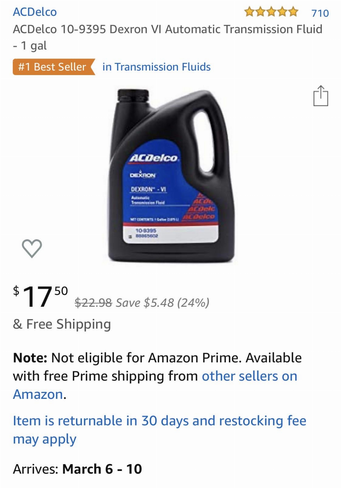

If anyone needs some. Was 13 bucks yesterday. 17 not bad.
Do i use this fluid for a 2001 tahoe as well. I know 05 are the same for alot of things but just want to make sure thanks
I’m not too sure. There are others on here that might know
