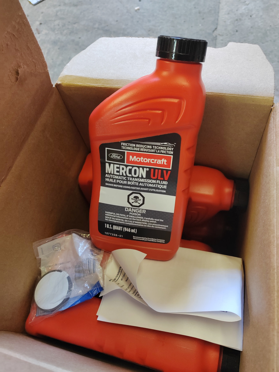

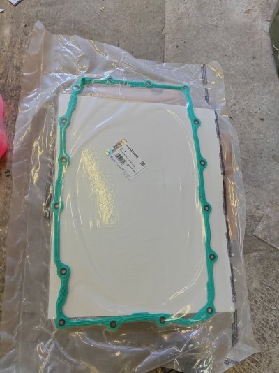

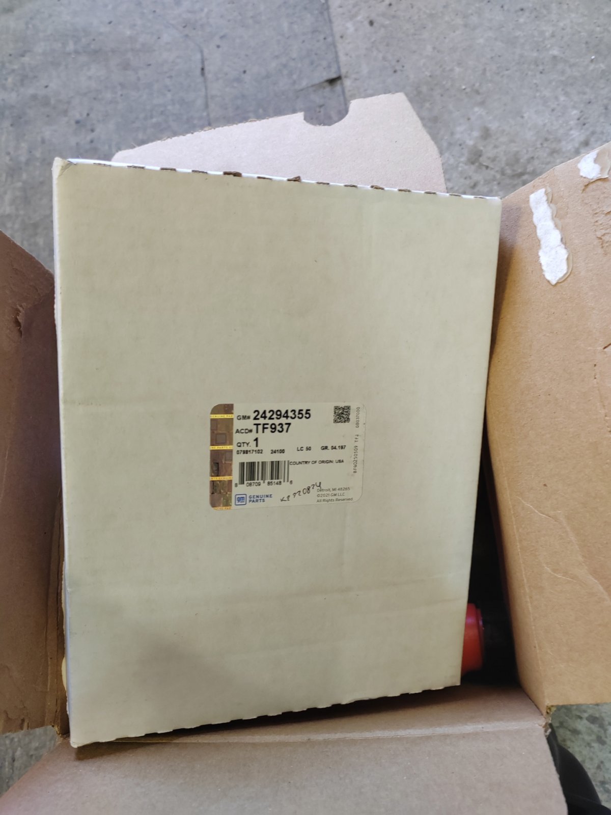

Something is expensive. What can be done there for $ 1000, I do not know. Changing the oil in the automatic transmission takes 2-2.5 hours. Ford Morocraft oil goes there at a price of $ 20 per quart, 8 quarts. Filter and Gasket $ 200. Yes, it is difficult to dismantle the exhaust pipe, but this is not difficult. I change the automatic transmission fluid and in the rear limited-slip clutch every 30 thousand miles, because I have a difficult operating mode.
