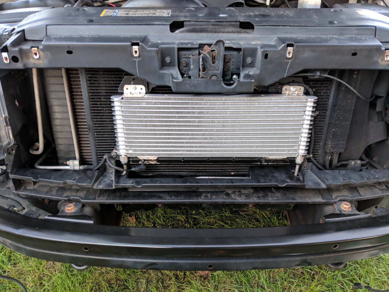

So for us that have PPV's with the cooler in the radiator pictured above, if we want to add an external cooler to further drop the temps how would one add the external?
I take it something like this?: (as you can see I have too much time on my hands at work..)

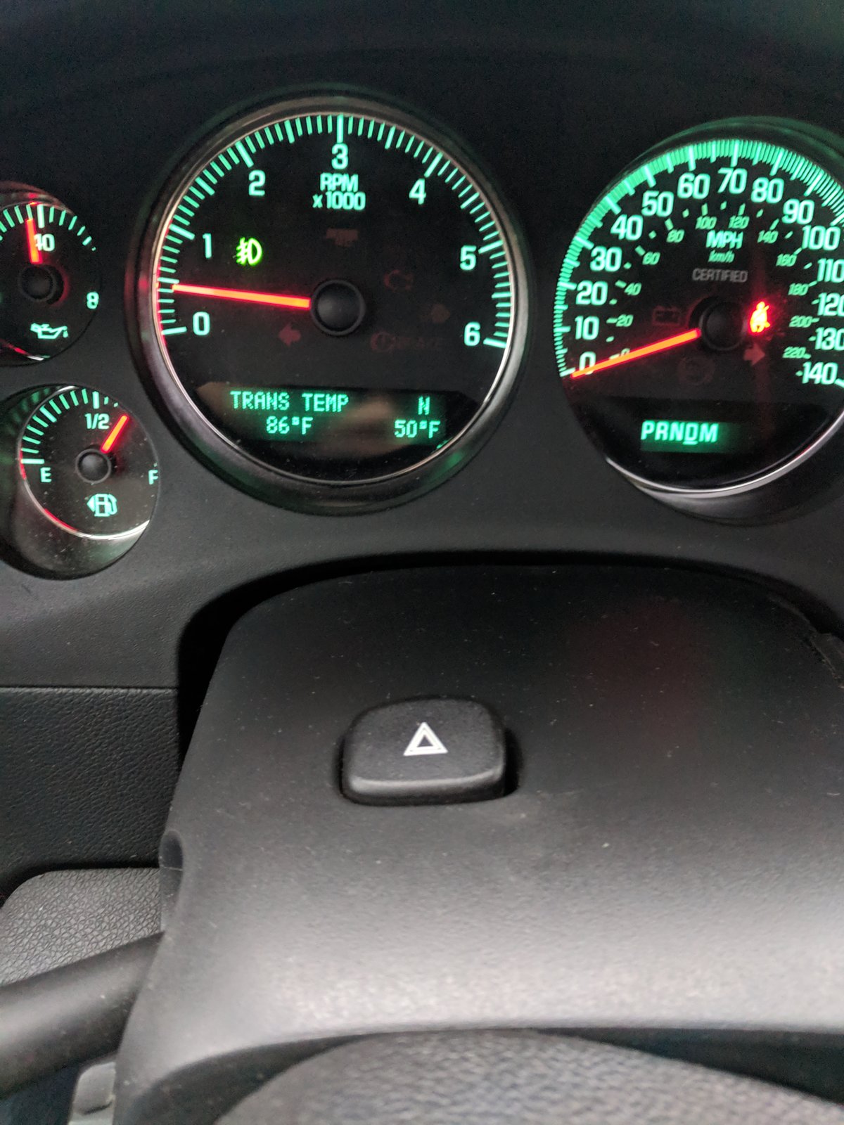

08 yukon denali xl1500 6.2, on a recent trip at freeway speeds with an outside temp of 43f the trans temp never went above 78f. on a trip while towing our 4,500lb travel trailer up a steep grade with an outside temp of 85f the trans hit 210f. i do have the factory trans cooler but can see it is not thermostatically controlled. i will add the aftermarket cooler but i think ill go with a thermostat. Anyone know if it is detrimental to run a automatic trans with cold fluid temps for an extended period of time?
30,751
48,443
that doesn't sound right mine will hit 76 just idling in the driveway and I have the deep pan and truecool, it may take a few minutes to warm up on the freeway but definitely does not stay that low

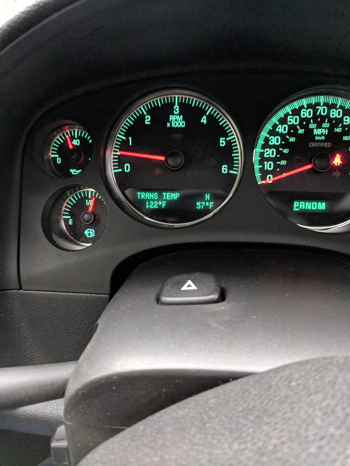

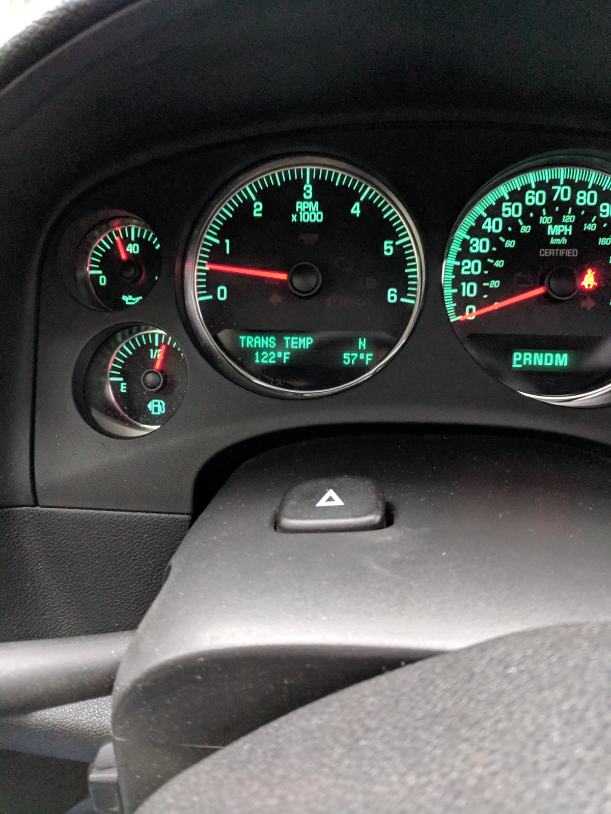

what is the temp yours runs at on the highway not towing with your cooler? Just driving 70 mph or so. Mine seems to stay in the 165-175 range 60-75 degrees outside temp fairly flat terrain Fort Worth to Austin, TX.
about 126-134 I watch it all the time, I also have the B&M deep trans pan on there.
